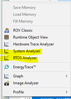

Hello all,
I'm trying to get the profiler on my AM437x target but can't find documentation that relates to CCSv7.  Most of what I find point to CCSv5 or older versions.  I've installed the TI-RTOS for Sitara (tirtos_sitara_2_00_01_23) and versions of UIA.
I modified the cfg file as described in 3.2 here (http://www.ti.com/lit/ug/spruh43f/spruh43f.pdf)
I can build my project and launch the debugger session but the actual "tools->RTOS Analyzer" is not showing after initialization.
Should I be able to get the RTOS analyzer on my target? Any ideas?
