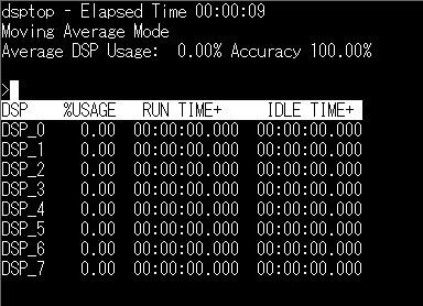

We can succeed to run "dsptop" on TMDSEVM572X with PROCESSOR-SDK-LINUX-AM57X 05_00_00_15 by modifying&building dts files including am57xx-beagle-x15-common.dtsi.
Now we try to run "dsptop" on TMDSIDK574 by modifying&building dts files including am57xx-idk-common.dtsi.
But we cannot success to run "dsptop" on TMDSIDK574.
- At fiist, we can see the "dsptop display" like below.
   But after a few second past, the display disappeared.
Question:
Are there any missing including modification of am57xx-idk-common.dtsi?
We would appreciate if you tell us the recommended way to run "dsptop" on TMDSIDK574.
And we also appreciate if you check the attached below files (console log & dtsi file).
- I add the below txt at line-192 in the attached dtsi file for modification.
>       debugss: debugss {
>       compatible = "ti,dra7xx-debugss";
>       clocks = <&sys_clkin1>;
>       clock-names = "sysclockin1";

root@am57xx-evm:~# dsptop
dsptop - Elapsed Time 00:00:00
Moving Average Mode
Average DSP[  163.096944] omap_hwmod: mmu0_dsp1: _wait_target_disable failed
 Usage:  0.00% Accuracy 100.00%
DSP    %USAGE   RUN TIM[  163.103183] omap-iommu 40d01000.mmu: 40d01000.mmu: version 3.0
E+     IDLE TIME+
DSP_0    0.00  00:00:00.000  00:00:00.000[  163.114714] omap-iommu 40d02000.mmu: 40d02000.mmu: version 3.0
DSP_1    0.00  00:00:00.000  00:00:00.000
DSP_2    0.00  00:00:00.000  00:00:00.000
DSP_3    0.00  00:00:00.000  00:00:00.00[  163.133663] omap_hwmod: mmu0_dsp2: _wait_target_disable failed
0

dsptop - Elapsed Time 00:00:03
Moving Average Mode
Average DSP Usage:  0.00% Accuracy 100.00%
DSP    %USAGE   RUN TIME+     IDLE TIME+
DSP_3    0.00  00:00:00.000  00:00:00.000
DSP_4    0.00  00:00:00.000  00:00:00.000
DSP_5    0.00  00:00:00.000  00:00:00.000
DSP_6    0.00  00:00:00.000  00:00:00.000
DSP_7    0.00  00:00:00.000  00:00:00.000>dsptop - Elapsed Time 00:00:06

DSP_7    0.00  00:00:00.000  00:00:00.000>dsptop internal error: Fatal: : Device not supported
root@am57xx-evm:~#
