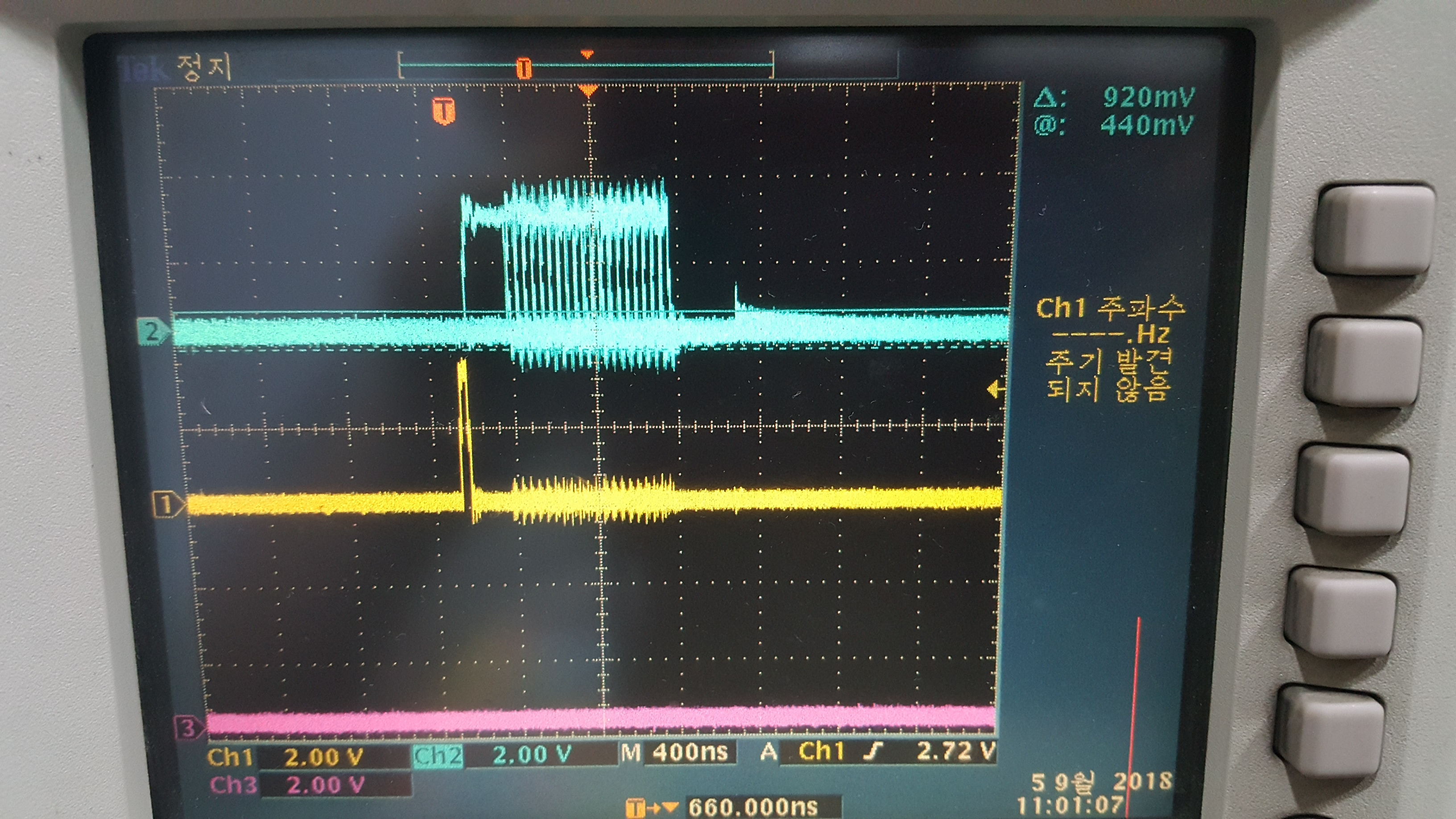

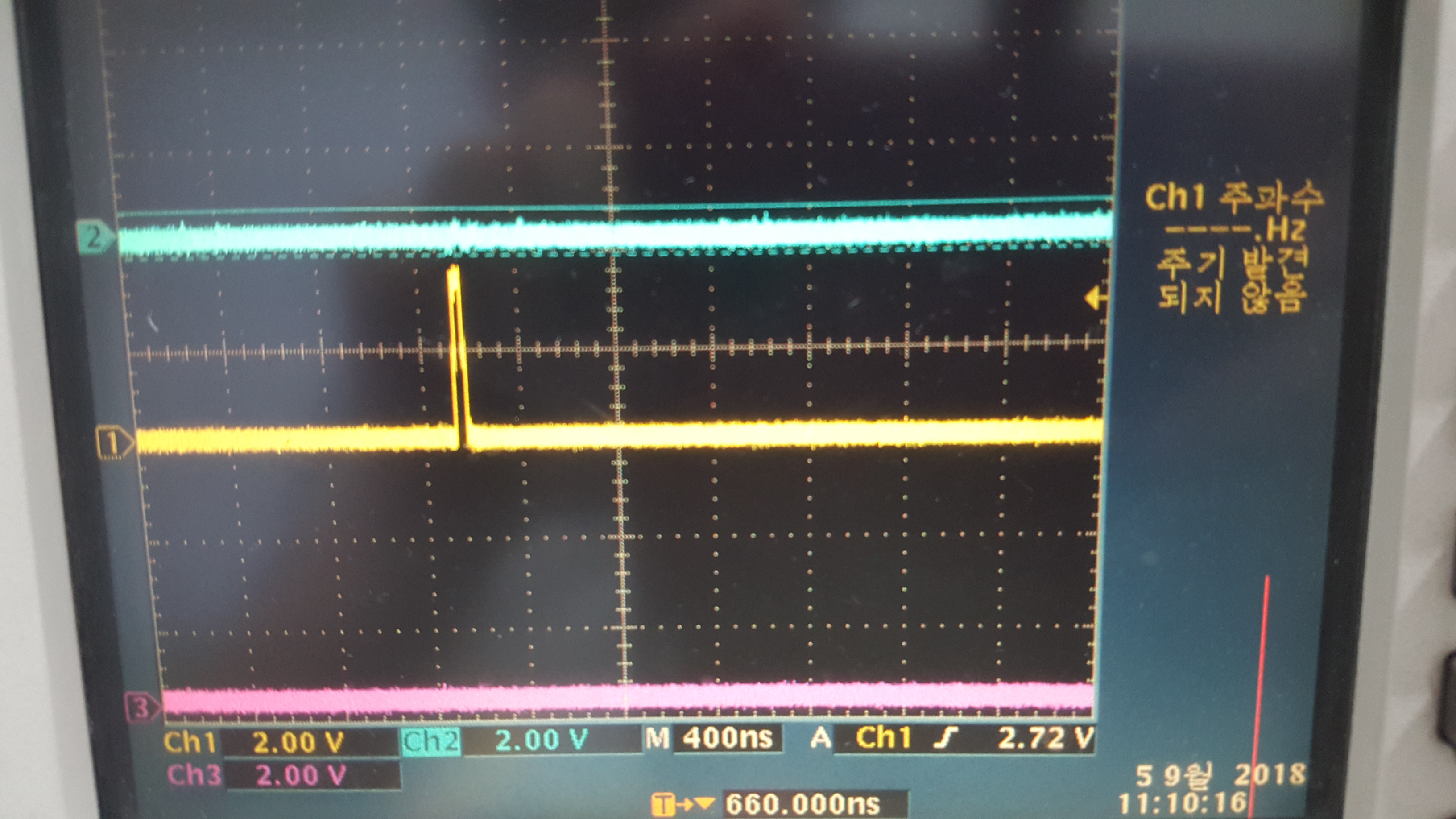

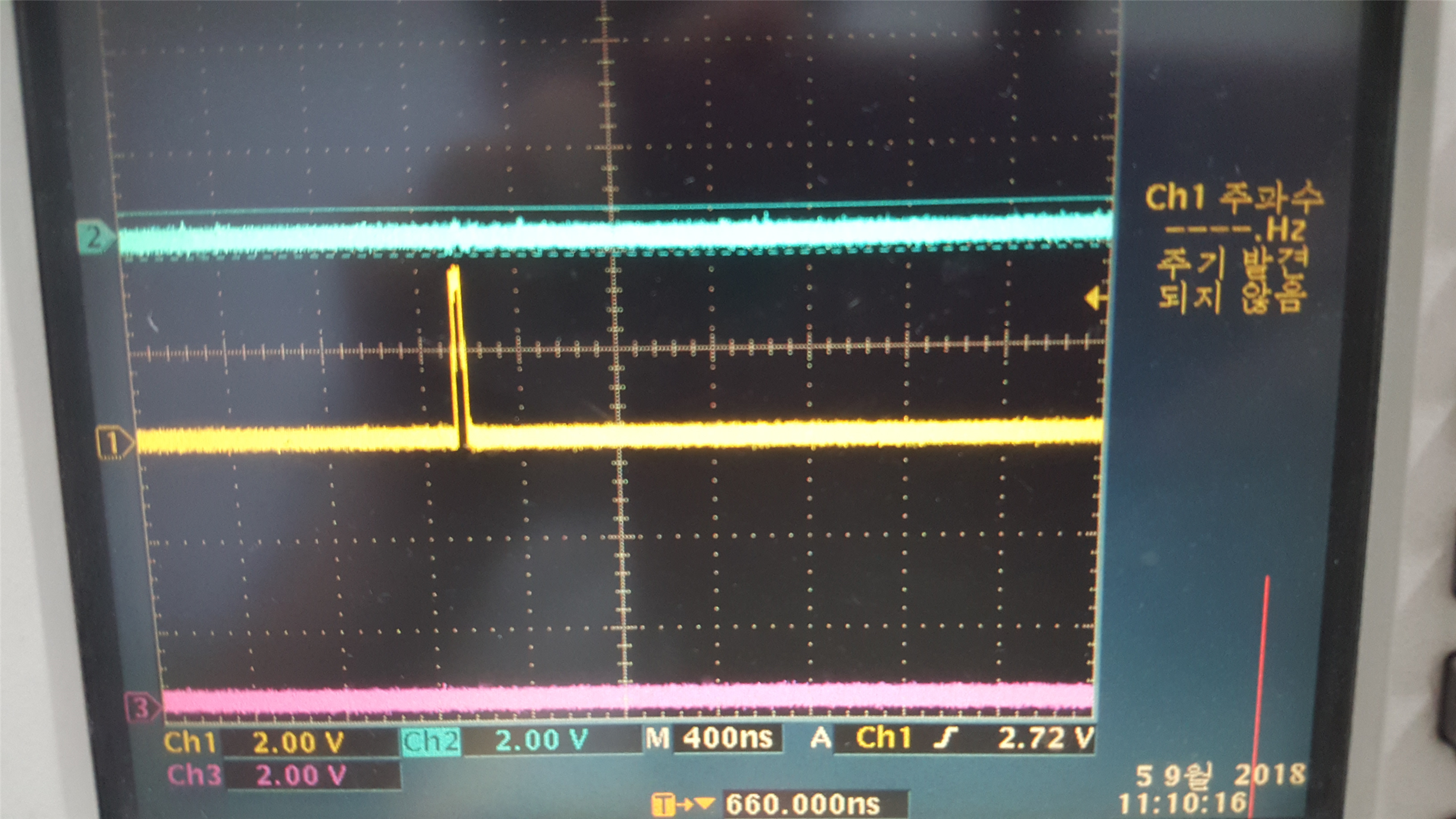

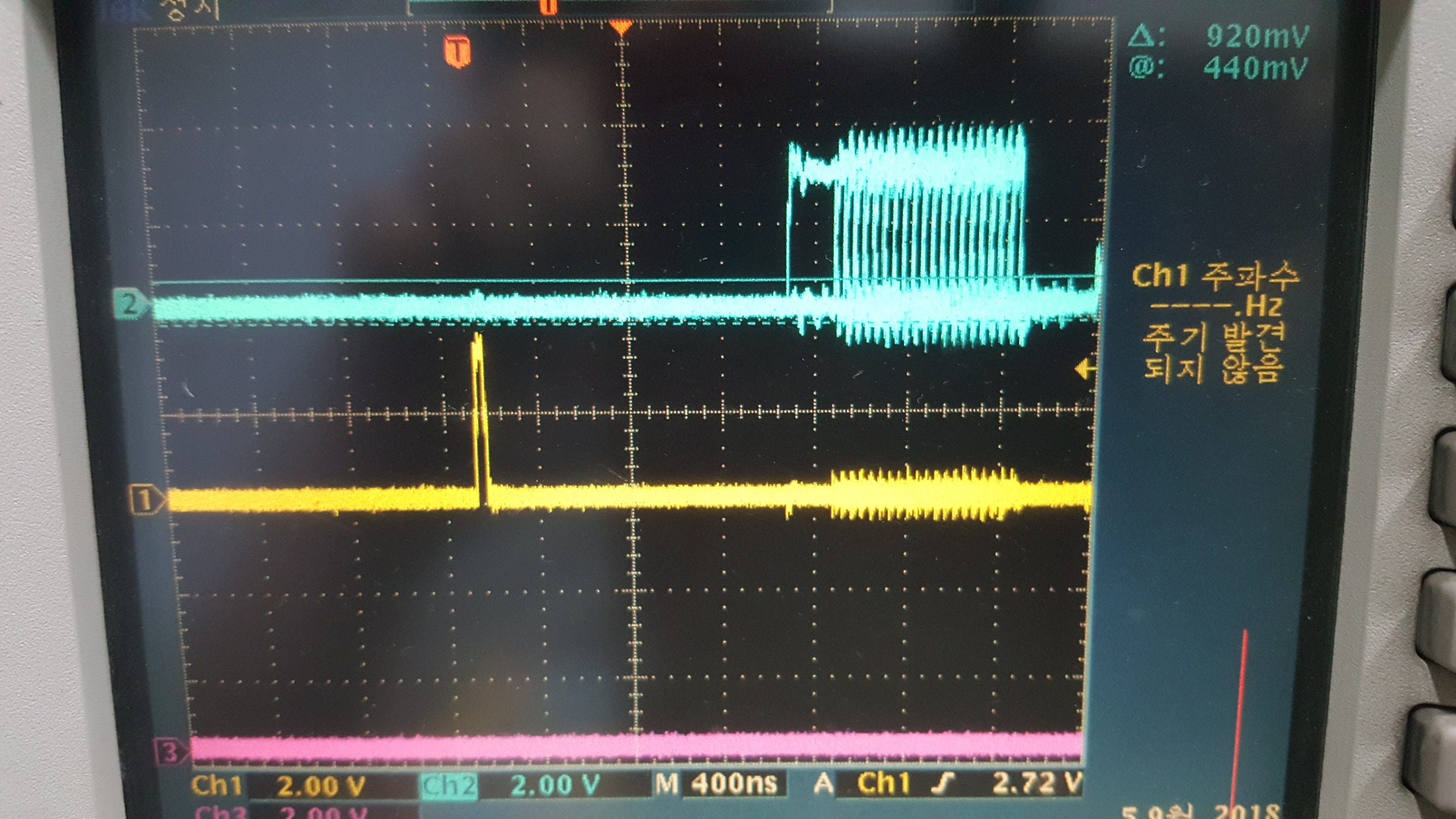

 - This board has run mcasp properly in sysbios environment. But it needs to work without sysbios
 - I have confirmed that XRFST, XSMRST, XSRCLR, XHCLKRST in the GBLCTL register is activated
 - If I activate only one slot or use burst mode, it works fine(TXTDM = 0 or 1)
 - If I activate more than one slot, it will not work(TXTDM = 2, 3, 4 .... 16)
(1) Activate slot 0 only (oscilloscope ch1 : frame sync clk , oscilloscope ch2 : AXR 2, TXTDM = 1)
(2) Activate slot 1 only (oscilloscope ch1 : frame sync clk , oscilloscope ch2 : AXR 2, TXTDM = 2)
(3) Activate slot 0, 1 (oscilloscope ch1 : frame sync clk , oscilloscope ch2 : AXR 2, TXTDM = 3)
 Thank for your help.

  • Hi Jinse,
    I assume the test code is the working case with a single slot?
    Note that there is no such thing as TDM mode with 1 slot or burst mode with multiple slots.  If you need 1 slot then you must use burst mode, and 2-32 slots will be TDM mode.  MCASP_TXFMCTL.XMOD must also be set to the number of TDM slots needed.  This should match the number of active TDM slots set in the MCASP_TXTDM.XTDMS.
    Stephen
  • If i set TXTDM to 0xFFFF and TXTDM.XTDMS to 16, it will not work like the third picture. Activating only one slot is only a result of trying to solve the problem.
    In the test code, only one slot is active, but what I want is to activate all 16 slots. It is correct to set it according to the answer, but the problem is that it does not work.
    Now(works)
    McASPTxFrameSyncCfg(SOC_MCASP3_CFG_BASE, 16, MCASP_TX_FS_WIDTH_BIT, MCASP_TX_FS_EXT_BEGIN_ON_RIS_EDGE);
    McASPTxTimeSlotSet(SOC_MCASP3_CFG_BASE, 0x01);
    Your answer(Does not work)
    McASPTxTimeSlotSet(SOC_MCASP3_CFG_BASE, 0xFFFF);
    Thank you for answer.
