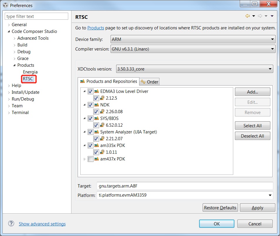

Build RTOS Processor SDK project MCSPI_Loopback_evmAM335x_armExampleProject report error as below,
**** Build of configuration Debug for project MCSPI_Loopback_evmAM335x_armExampleProject ****
"C:\\ti\\ccsv7\\utils\\bin\\gmake" -k -j 4 all -O
'Building file: "C:/ti/pdk_am335x_1_0_11/packages/ti/drv/spi/example/mcspiLoopbackApp/am335x/armv7/bios/mcspi_loopback_arm_evmAM335x.cfg"'
'Invoking: XDCtools'
"C:/ti/xdctools_3_50_03_33_core/xs" --xdcpath="C:/ti/bios_6_52_00_12/packages;C:/ti/pdk_am335x_1_0_11/packages;C:/ti/edma3_lld_2_12_05_30C/packages;C:/ti/ndk_2_26_00_08/packages;C:/ti/uia_2_21_02_07/packages;" xdc.tools.configuro -o configPkg -t gnu.targets.arm.A8F -p ti.platforms.evmAM3359 -r debug -c "C:/ti/gcc-arm-none-eabi-6-2017-q1-update" "C:/ti/pdk_am335x_1_0_11/packages/ti/drv/spi/example/mcspiLoopbackApp/am335x/armv7/bios/mcspi_loopback_arm_evmAM335x.cfg"

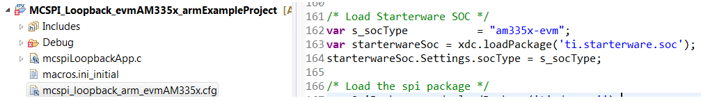

js: "C:/ti/pdk_am335x_1_0_11/packages/ti/drv/spi/example/mcspiLoopbackApp/am335x/armv7/bios/mcspi_loopback_arm_evmAM335x.cfg", line 163: xdc.services.global.XDCException: xdc.PACKAGE_NOT_FOUND: C:\ti\pdk_am335x_1_0_11\packages\ti\starterware\soc\package.xdc found along the package path, but no schema file was found. Ensure that the package 'ti.starterware.soc' is completely built.
"./package/cfg/mcspi_loopback_arm_evmAM335x_pa8fg.cfg", line 181

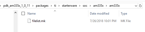

Open the .cfg file, and compare with other example projects, other project/s cfg file doesn't have the loadPackage(ti.starterware.soc'). And I don't find soc package in the soc path, it is under binary directory.
Question:
Is soc package must for this example? why other project doesn't have?
How to make this project build successfully.
