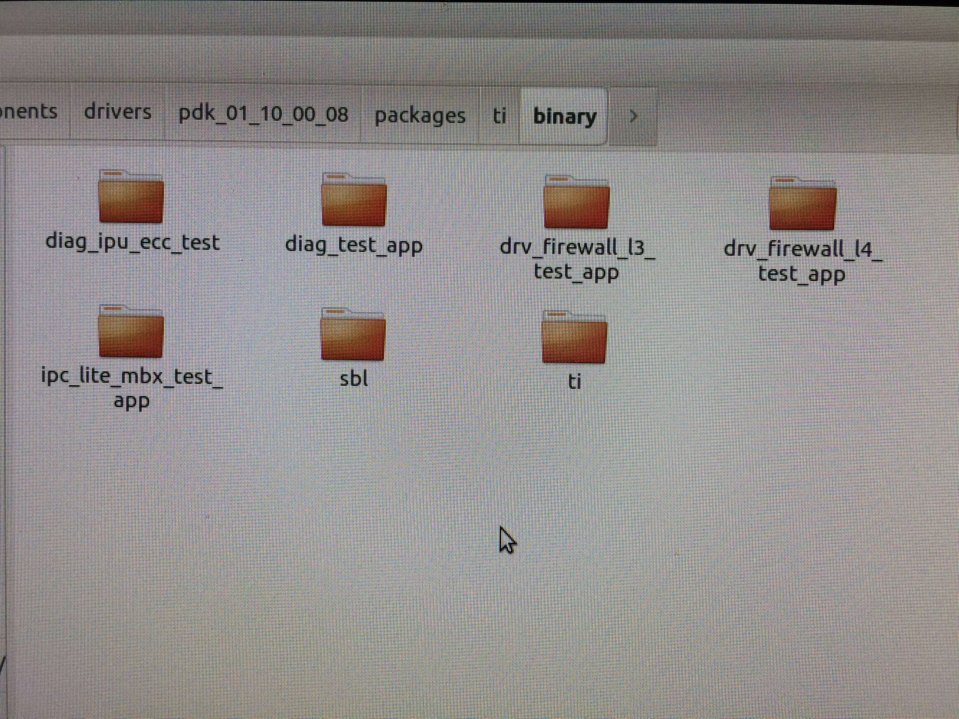

  • Hi Rishabh,
    Yeah, but that was second question. My original first question is no boot message printed out in Tera Term. I guess the reason is that micro use port was connected to uart1 port of TDA3X SOC in our custom board but default port is uart3 in SDK. So I want change this first.
    Two pics below are all directories I got in binary and sbl. I have no idea which binary file I should use. Please give me some directions. Thank you.
    Daniel

  • Hi Daniel,
    You should not load Vision SDK binaries if you want to validate PDK example.
    Pad mux seems to be same as that of TDA3 EVM.
    Can you share a screenshot for contents of folder PROCESSOR_SDK_VISION_03_04_00_00\ti_components\drivers\pdk_01_10_00_08\packages\ti\binary.
    Rishabh
  • Hi Rishabh,
    Which file should I load if I want to validate PDK example?
    And the contents of folder binary is as below:
    Daniel
  • Hi Daniel,
    Did you build qspi test app? You should get a sub-folder named "csl_qspi_test_app" in binary folder.
    Rishabh

    Daniel
  • Hi Daniel,
    I checked the makefile. It seems that you should be able to run the tda3xx-evm qspi test binary on the RVP board.
    Rishabh
