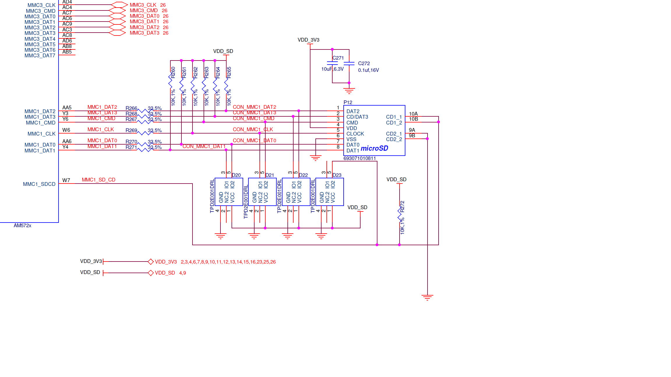

I am using Wurth SD CARD push pull type connector (693071010811) instead of Alps type as shown in the TI-AM5728 EVM board.
But when i am trying to boot up - it is showing that - SD CARD is NOT detected.
I have the exact same schematic as shown in TI-AM5728 EVM.
I noticed that when i plug in the SD CARD to this Wurth connector- MMC1_SDCD Pin does NOT get pulled down to 1.8V. instead- it is still set to 3.3V.
Am i missing something ?
Thanks for the help-
really appreciate it.
