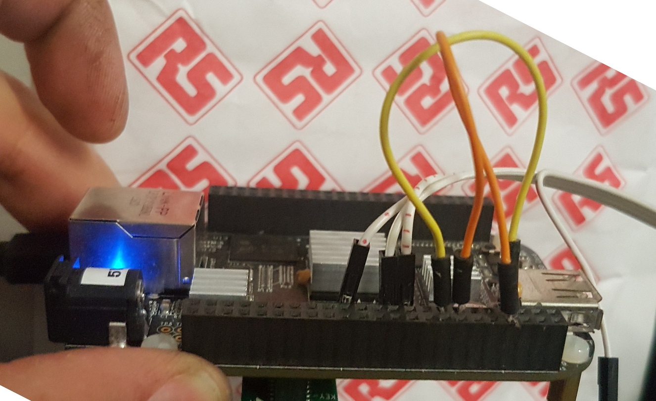

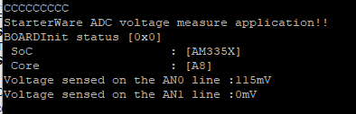

  • Matt,
    I have attached an example that works on the BBB based on the Starterware ADC example.
    The CCS project is attached along with a .txt of the software changes made to the pinmux files. Some of the changes are noted as "might not be needed" as I didnot go back to check if this was indeed needed.
    The only piece that needs to be enabled are the clocks and enabling the interface in Software. Hopely you can follow along in the example on the libraries and other dependencies that enabled this example to be built. Some of the source files were included in the project so that breakpoints can be set and the code can be stepped through.
    The Starterware and Board libraries would need to be rebuilt once any changes are infused to ensure they are used in the application.

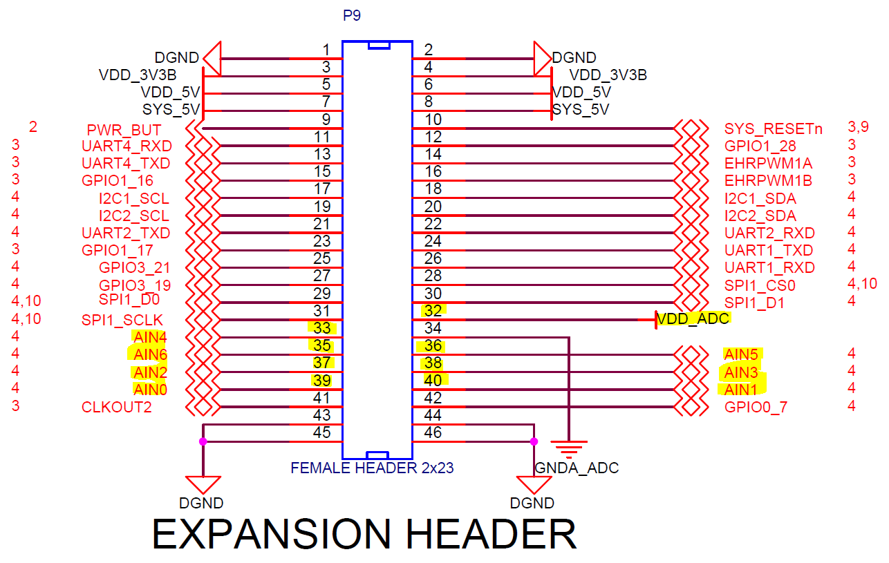

    In the below example, AIN0 and AIN1 are both grounded but AIN0 is showing some voltage. Some drfit in the reading, not sure why.
    Please note that you cannot put more than 1.8V on the AIN pins as this will damage the SoC.
    FYI, Pin 32 on header P9 produces 1.8V (VDD_ADC)
    Hope this helps.
    Lali
    /cfs-file/__key/communityserver-discussions-components-files/791/BBB_5F00_ADC_5F00_PDK_5F00_example.zip
    /cfs-file/__key/communityserver-discussions-components-files/791/BBB_5F00_ADC_5F00_PDK_5F00_softwarechanges.txt
  • Dear Lali,
    Thank You a huge leap forward for myself.
    Re offset I am getting serious problems here on AIN 1
    I use pin 32 (VDD_ADC) and 34 (GND_ADC) for reference of AIN0 and AIN1
    I then flip the AIN0 and AIN1 from VDD_ADC to GND
    Output is
    StarterWare ADC voltage measure application!!
    Voltage sensed on the AN0 line :4095 /4095
    Voltage sensed on the AN1 line :7 /4095
    Voltage sensed on the AN0 line :0 /4095
    Voltage sensed on the AN1 line :3991 /4095
    When you have advice please let us know.
    Warm Regards,
    MB

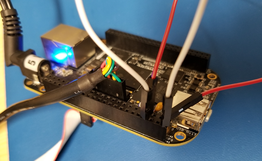

  • Dear Lali,
    That is correct,
    Voltage sensed on the AN0 line :4095 /4095 (Connected to ADC_VCC)
    Voltage sensed on the AN1 line :0 /4095 (Connected to ADC_GND)
    and when flipped.
    Voltage sensed on the AN0 line :0 /4095 (Connected to ADC_GND)
    Voltage sensed on the AN1 line :4095 /4095 (Connected to ADC_VCC)
    Currently getting a significant offset of almost 100 as per example above.
    Warm Regards,
    MB
  • MB,
    This could be a noise issue on the board causing the strange values.
    A couple of things:
    - The ADC expects its negative input to be connected to VREFN anytime it is configure to perform a single-ended measurement. So the SEL_RFP_SWC_2_0 bit field should always be configured to a value of 1xxx when the DIFF_CNTRL bit field is configured to a value of 0.
    - Try turning off averaging to see if that helps.
    If none of these help, implement a post processing software filter that is able to detect an outlier value and discard it.
    Other than that, I don't have any more input. Thanks.
