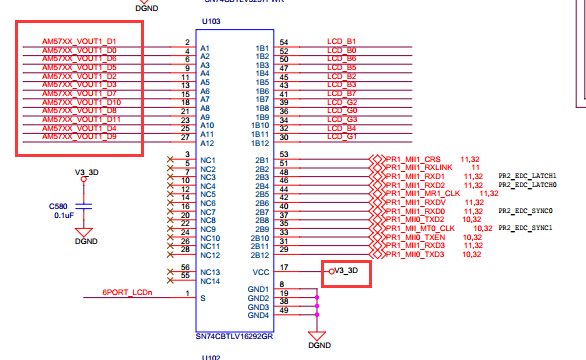

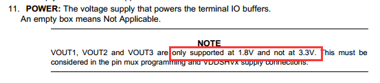

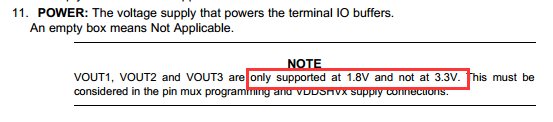

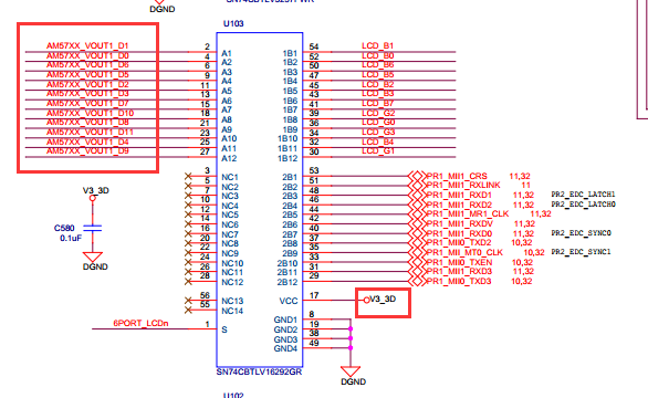

Hi
    I am looking the datasheet for AM5718,the page12 of datasheet  11. POWER: noted  VOUT1, VOUT2 and VOUT3 are only supported at 1.8V and not at 3.3V.  When I look the AM571x EVM Schematic,in the page 20,AM5728 VOUT1 PIN connect to SN74CBTLV16292GR,and this chip VCC is 3.3V. I'm puzzled,If VOUT1 can support 3.3V?
