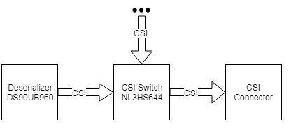

    In order to help you understand our problem, I will try to explain our whole setup and I’ll be more precise about it.
    So our adapter board is custom TDA2Px SoC based board. On the other side we have TDA3xx-evm board.
    The part of adapter board setup is like this:

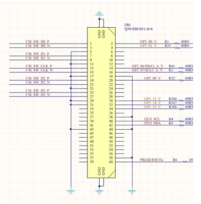

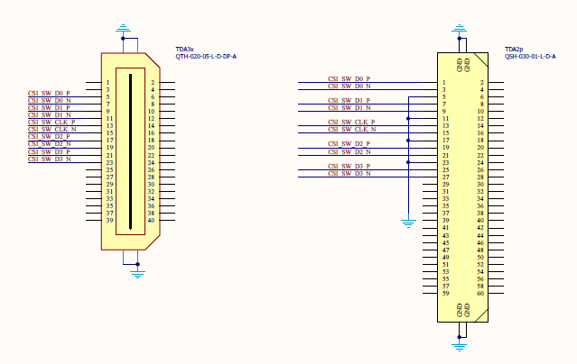

    This is datasheet of the CSI Connector on TDA2p side:
    CSI_SW_Dx_P/N is output of the switch. Ignore right side of the connector.
    This is datasheet of custom CSI connector which is used to properly connect our adapter board and Tda3xx-evm board:
    We configure deserializer UB960 in pattern mode RGB888 1280x720. After running everything, CAL registers on TDA3x looks like this:

    We are sure that deserializer is configured properly and that the signals are getting through switch to CSI connector. Also, we have put correct line orders on TDA3x side:
    1, 2, 4, 5 - Data lanes
    3 - Clock lane
    Stefan.
  • Hi Stefan,
    I would request you to check the data-lanes mapping. With reset-done, the clock seems to be OK.
    From the snippet of schematics that's provided, we really cannot comment.
    Sujith
  • Hi Sujith,

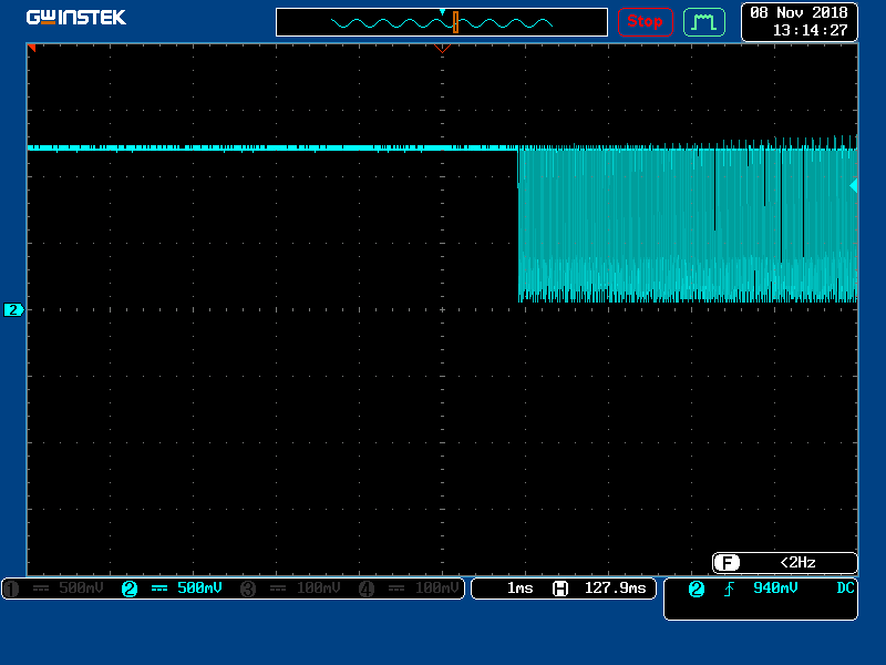

    Ok, we succeeded to capture data from UB960 on TDA3x side, there were some HW issues with CSI connector. Now we want to capture test pattern data from HDMI2CSI device (TC358743XBG) over CSI switch, but we are not able to do that. So, I have one question. These is case where data sending starts from UB960, data lanes are initially at ~0.6 V and when transaction starts all lanes jumps to 1.2 V (LP11 state):
    In second case, with TC358743XBG device, we have following:
    So, data lanes are initially at 1.2 V. Can this cause to TDA3x driver don't detect transition to LP11 state and because of that there is no data captured?
    Stefan.
  • Hi Stefan,
    In case of HDMI2CSI converter, i do not see LP transitions at all. Can you check with a differential probe?
    Sujith
