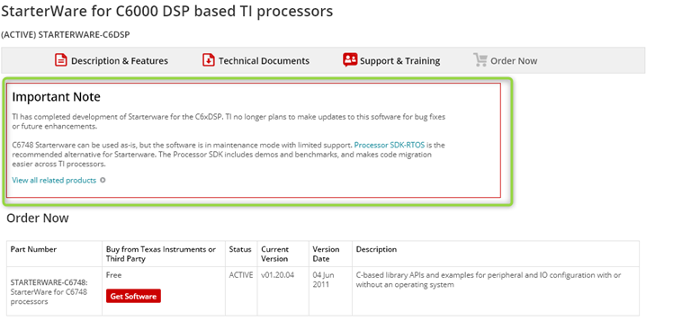

  • Hi Tony,
    Starterware is no longer supported. Recommendation is to migrate to the latest Processor SDK RTOS:
    www.ti.com/.../PROCESSOR-SDK-C6748
  • Sahin,
    If no support, why starterware still exist under PDK? there are many customer refer Starterware.
    did you verify this feature? it is not related to which specific SDK or Starterware.
    my question is the timer 64bit mode works abnormal.
  • Starterware is still supported/part of Processor SDK for AM335x/AM437x devices, but for OMAP-L13x/C674x it is no longer supported. We provide this guidance on the Starterware download page, and we urge customers to start new development using the Processor SDK baseline.
    I recommend testing the timer example provided in Processor SDK to see if you are still running into the same issue. It can be found under C:\ti\\pdk_omapl138_1_0_5\packages\ti\csl\example\timer. I hope this is an option for you.
