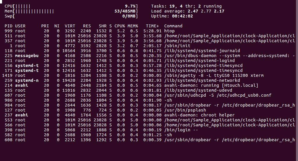

I am using am335x processor based custom board and using Beaglebone BSP.I am using ti-processor-sdk-linux-am335x-evm-04.01.00.06 and kernel version is 4.9.41.
when I am running htop command
As soon as i connect musb for taking the ssh of the board it is showing cpu load 100%
Kindly suggest me what can i do to reduce the CPU load.

    musb is device port on my development board.I am trying to connect my board to PC.
    when i connect musb to usb cable on my system i get below interface on my PC
    enp0s29u1u2c2 Link encap:Ethernet HWaddr 46:f9:2c:a4:37:e5
    inet addr:192.168.7.1 Bcast:192.168.7.3 Mask:255.255.255.252
    inet6 addr: fe80::6ff:f4b:5a42:b1c9/64 Scope:Link
    UP BROADCAST RUNNING MULTICAST MTU:1500 Metric:1
    RX packets:45 errors:0 dropped:0 overruns:0 frame:0
    TX packets:42 errors:0 dropped:0 overruns:0 carrier:0
    collisions:0 txqueuelen:1000
    RX bytes:7542 (7.5 KB) TX bytes:7902 (7.9 KB)
    after that I am doing ssh of my board on my PC.
    ssh root@192.168.7.2
    it is taking around 30 second to connect.
    Thank you.

    my main issue is when i connect musb very first time it htop shows me normal cpu load 20-30% but after some time cpu load increased 80-100% and it dont reduce till i disconnect my usb from the system.

    2.dts entry for usb is given below
    &usb {
    status = "okay";
    control@44e10620 {
    status = "okay";
    usb-phy@47401300 {
    status = "okay";
    usb-phy@47401b00 {
    status = "okay";
    usb@47401000 {
    status = "okay";
    usb@47401800 {
    status = "okay";
    dr_mode = "host";
    dma-controller@47402000 {
    status = "okay";
    usb kernel logs are given below
    [ 92.162035] g_multi gadget: adding config #1 'Multifunction with RNDIS'/bf54190c
    [ 92.163506] rndis_register: configNr = 0
    [ 92.163536] g_multi gadget: adding 'rndis'/ddb66a80 to config 'Multifunction with RNDIS'/bf54190c
    [ 92.163588] rndis_set_param_medium: 0 0
    [ 92.163602] g_multi gadget: RNDIS: dual speed IN/ep1in OUT/ep1out NOTIFY/ep2in
    [ 92.163626] g_multi gadget: adding 'acm'/ddb68200 to config 'Multifunction with RNDIS'/bf54190c
    [ 92.163717] g_multi gadget: acm ttyGS0: dual speed IN/ep3in OUT/ep2out NOTIFY/ep4in
    [ 92.164094] g_multi gadget: adding 'Mass Storage Function'/dcff3900 to config 'Multifunction with RNDIS'/bf54190c
    [ 92.175903] g_multi gadget: I/O thread pid: 581
    [ 92.176083] g_multi gadget: cfg 1/bf54190c speeds: high full
    [ 92.176096] g_multi gadget: interface 0 = rndis/ddb66a80
    [ 92.176107] g_multi gadget: interface 1 = rndis/ddb66a80
    [ 92.176118] g_multi gadget: interface 2 = acm/ddb68200
    [ 92.176128] g_multi gadget: interface 3 = acm/ddb68200
    [ 92.176138] g_multi gadget: interface 4 = Mass Storage Function/dcff3900
    [ 92.176155] g_multi gadget: adding config #2 'Multifunction with CDC ECM'/bf5419b0
    [ 92.176885] g_multi gadget: adding 'cdc_ethernet'/ddb66300 to config 'Multifunction with CDC ECM'/bf5419b0
    [ 92.176968] g_multi gadget: CDC Ethernet: dual speed IN/ep1in OUT/ep1out NOTIFY/ep2in
    [ 92.176996] g_multi gadget: adding 'acm'/db2a8600 to config 'Multifunction with CDC ECM'/bf5419b0
    [ 92.177032] g_multi gadget: acm ttyGS0: dual speed IN/ep3in OUT/ep2out NOTIFY/ep4in
    [ 92.177056] g_multi gadget: adding 'Mass Storage Function'/ddb6ab40 to config 'Multifunction with CDC ECM'/bf5419b0
    [ 92.177077] g_multi gadget: cfg 2/bf5419b0 speeds: high full
    [ 92.177089] g_multi gadget: interface 0 = cdc_ethernet/ddb66300
    [ 92.177098] g_multi gadget: interface 1 = cdc_ethernet/ddb66300
    [ 92.177108] g_multi gadget: interface 2 = acm/db2a8600
    [ 92.177117] g_multi gadget: interface 3 = acm/db2a8600
    [ 92.177127] g_multi gadget: interface 4 = Mass Storage Function/ddb6ab40
    [ 92.177147] g_multi gadget: g_multi ready
    [ 92.373377] usb0: eth_open
    [ 92.374415] IPv6: ADDRCONF(NETDEV_UP): usb0: link is not ready
    [ 98.432808] gs_open: ttyGS0 (db300000,db220e80)
    [ 98.433150] gs_close: ttyGS0 (db300000,db220e80) ...
    [ 98.433166] gs_close: ttyGS0 (db300000,db220e80) done!
    [ 98.448262] gs_open: ttyGS0 (db300000,ddf04b40)
    [ 98.448459] gs_close: ttyGS0 (db300000,ddf04b40) ...
    [ 98.448473] gs_close: ttyGS0 (db300000,ddf04b40) done!
    [ 98.681833] gs_open: ttyGS0 (db0ef000,d7a48580)
    [ 98.682239] gs_close: ttyGS0 (db0ef000,d7a48580) ...
    [ 98.682259] gs_close: ttyGS0 (db0ef000,d7a48580) done!
    [ 98.683958] gs_open: ttyGS0 (db772800,dce72340)
    after connecting musb
    [ 187.555540] g_multi gadget: high-speed config #2: Multifunction with CDC ECM
    [ 187.557711] g_multi gadget: init ecm
    [ 187.557733] g_multi gadget: notify connect false
    [ 187.557866] g_multi gadget: reset acm ttyGS0
    [ 187.557877] g_multi gadget: activate acm ttyGS0
    [ 187.557980] gserial_connect: start ttyGS0
    [ 187.560035] g_multi gadget: acm ttyGS0 serial state 0003
    [ 187.561877] g_multi gadget: set_config: interface 4 (Mass Storage Function) requested delayed status
    [ 187.561894] g_multi gadget: delayed_status count 1
    [ 187.568204] g_multi gadget: usb_composite_setup_continue
    [ 187.568291] g_multi gadget: usb_composite_setup_continue: Completing delayed status
    [ 187.569142] g_multi gadget: activate ecm
    [ 187.569850] usb0: qlen 10
    [ 187.569905] g_multi gadget: ecm_open
    [ 187.570018] usb0: eth_start
    [ 187.570541] g_multi gadget: packet filter 0c
    [ 187.570558] g_multi gadget: ecm req21.43 v000c i0000 l0
    [ 187.572004] g_multi gadget: acm ttyGS0 req21.20 v0000 i0002 l7
    [ 187.586357] IPv6: ADDRCONF(NETDEV_CHANGE): usb0: link becomes ready
    [ 187.889284] hrtimer: interrupt took 165417 ns
    [ 188.393355] g_multi gadget: packet filter 0e
    [ 188.393382] g_multi gadget: ecm req21.43 v000e i0000 l0
    [ 188.424264] g_multi gadget: notify connect true
    [ 188.456257] g_multi gadget: notify speed 425984000
    [ 188.501614] g_multi gadget: packet filter 0e
    [ 188.501640] g_multi gadget: ecm req21.43 v000e i0000 l0
    [ 188.503814] g_multi gadget: packet filter 0e
    [ 188.503828] g_multi gadget: ecm req21.43 v000e i0000 l0
    [ 188.606238] g_multi gadget: sending command-failure status
    [ 188.790565] g_multi gadget: packet filter 0e
    [ 188.790592] g_multi gadget: ecm req21.43 v000e i0000 l0
    [ 188.871693] g_multi gadget: packet filter 0e
    [ 188.871721] g_multi gadget: ecm req21.43 v000e i0000 l0
    [ 189.666702] g_multi gadget: acm ttyGS0 req21.22 v0003 i0002 l0
    [ 189.667095] g_multi gadget: acm ttyGS0 req21.20 v0000 i0002 l7
    [ 189.669017] g_multi gadget: acm ttyGS0 req21.22 v0002 i0002 l0
    [ 189.769802] g_multi gadget: acm ttyGS0 req21.22 v0003 i0002 l0
    [ 190.726146] g_multi gadget: packet filter 0e
    [ 190.726174] g_multi gadget: ecm req21.43 v000e i0000 l0
    [ 191.055831] g_multi gadget: packet filter 0e
    [ 191.055858] g_multi gadget: ecm req21.43 v000e i0000 l0
    [ 203.069444] g_multi gadget: acm ttyGS0 req21.22 v0000 i0002 l0
    [ 203.121345] g_multi gadget: acm ttyGS0 req21.22 v0003 i0002 l0
    [ 203.121532] g_multi gadget: acm ttyGS0 req21.20 v0000 i0002 l7
    [ 209.067681] g_multi gadget: acm ttyGS0 req21.22 v0000 i0002 l0
    kindly help me and let me know if any other info is required.
