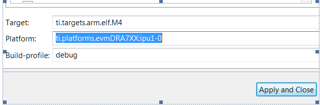

  • Kaka,
    When you want to split the memory for each core, I assumed that you want to run different programs in each. If you run the cores in SMP, you don't need to do this.
    Below is an example how we did this:
    our IPC examples append “ipu1-0” and “ipu1-1” to the evmDRA7XX platform:
    C:\ti\am57xx-5.1\ipc_3_50_01_01\examples\DRA7XX_bios_elf\ex02_messageq\shared\Config.bld:
    Build.platformTable["ti.platforms.evmDRA7XX:ipu1-0"] = {
       externalMemoryMap: [
           [ "IPU1_0_PROG", {
               name: "IPU1_0_PROG", space: "code/data", access: "RWX",
               base: 0x86000000, len: 0x800000,
               comment: "IPU1-0 Program Memory (8 MB)"
           [ "SR_0", SR_0 ]
       codeMemory:  "IPU1_0_PROG",
       dataMemory:  "IPU1_0_PROG",
       stackMemory: "IPU1_0_PROG"
    Build.platformTable["ti.platforms.evmDRA7XX:ipu1-1"] = {
           [ "IPU1_1_PROG", {
               name: "IPU1_1_PROG", space: "code/data", access: "RWX",
               base: 0x86800000, len: 0x800000,
               comment: "IPU1-1 Program Memory (8 MB)"
           [ "SR_0", SR_0 ]
       codeMemory:  "IPU1_1_PROG",
       dataMemory:  "IPU1_1_PROG",
       stackMemory: "IPU1_1_PROG"
    And then we change the platform in CCS:
    You can apply the same idea to A15.
    Regards, Eric
