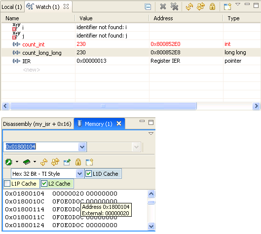

This my_isr() is extremely short so there is no possibility for nesting, or interrupting with other code. Contrary to my expectation that both counters (use two like a double check) should increment with every new field which is 60 per second, they actually increase their value for over 100000 per second, almost unbelievable.
Here is the screenshot showing very large quantity after seconds of running:
As a comparison, and also to ensure that the interrupt controller is configured and working properly, I map VPBE's VENCINT to CPUINT4, which also indicates end-of-frame event. In this way my_isr() is being triggered by VENCINT which happend 60 times per second. The experiment runs as expected and the following screenshot show the counter value after around about 4 seconds:

    This is an update on the question:
    The cause of the problem has been identified to be an erroneous CCDC register setting in the example code provided with the EVM to me. The EVM is from a third party provider, not TI or Spectrum. In page 127 of TMS320DM643x DMP Video Processing Front End (VPFE) User's Guide, SPRU977a, CCDC.SYN_MODE.VDHDOUT (bit 0) is described as:
    VDHDOUT VD/HD sync direction.
    0 Input
    1 Output
    For BT.656 stream which has embedded VD/HD sync signal within SAV/EAV bits, the VDHDOUT register should be set to 0 (input). However, they set that as 1 (output) in the default initialization code.
    Not sure if the 6437 chip has some internal "error correcting/tolerance" capability such that even with this opposite VD/HD direction setting, VPFE could still send the data to the correct address and VPBE also output it correctly. But when I tried to capture the interrupts, CCDC sends me around 500,000 interrupts per second. After I corrected VDHDOUT to 0 (input), everything went back to normal and CCDC gives exactly 60 VDINT0 interrupts for NTSC BT.656 stream.
