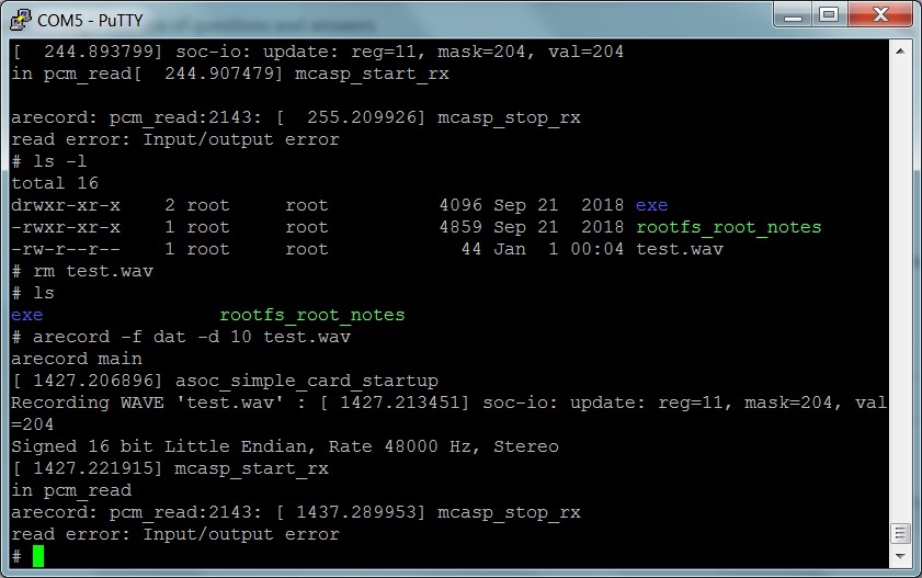

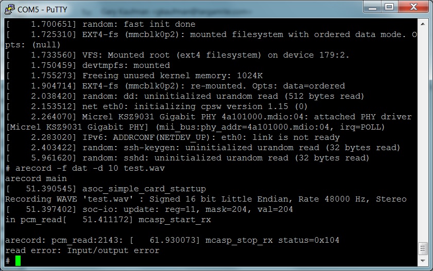

I put printk statements in the davinci-mcasp.c code in the mcasp_start_rx(), mcasp_stop_rx() and davinci_mcasp_rx_irq_handler() functions. Here's a terminal capture when I run arecord:
The davinci_mcasp_rx_irq_handler() never gets called. I have an anlyzer on the i2s bus. Here is what it is showing while arecord is running:
It looks like the clocks and data are valid but the irq handler never gets called. I think there must be something wrong with my configuration of mcasp0 in the .dts file.
Any help or insight into this problem would be appreciated.
