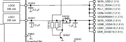

  • Thanks again Christina!  Can you also comment on two other items?
    1.What is the purpose of the FET below?  I understand it delays power from LDO1 until DC-DC #2 is alive, BUT why would we need to do that?  The power sequencing the datasheet recommends is 1.2V --> 1.8V --> 3.3V.  The LDOs by default don't start until DC-DC #3 (1.2V) is up, so why would I want to wait to bring up the 1.8V?
    2. Am I okay to power the memory controller off DC-DC #2?  The reference design uses LDO #1, but I am worried about exceeding its max current.
    Can you provide the link to the appnote where you got the image from?  I'll like to see what else is connected.
    The image came from the TPS65070 datasheet, page 72.
    Thank you for the estimated power requirement table.
    In my design, all I/O is 3.3V, and it all runs off DC-DC converter #1.  I use DC-DC #2 (1.8V) to power DDR_DVDD18 and a single DDR memory chip to avoid exceeding LDO #1's max current.
    My main question is the purpose of having a FET delay LDO #1 (1.8V) until DC-DC #2 (strapped for 1.8V in my design) comes up
    I also wonder if there any issues with running DDR memory on a switcher, specifically on DC-DC #2.  I know my power budget is okay.  This question is about noise or any issues apart from maximum current, which will not be a problem.
    I think I might have part of the answer to my sequencing question.  The sequencing we want is 1.2V --> 1.8V --> 3.3V.  I keep saying that at the default configuration TPS65070 won't bring up the LDOs until DC-DC #3 (1.2V) is up.  Therefore the 1.2V comes up before the 1.8V LDO.  What I was forgetting is the other LDO is 1.2V.  We need to make sure LDO #1 (1.8V) does not come up until LDO #2 (1.2V) comes up.
    Why not gate LDO #1 (1.8V) with LDO #2 (1.2V)?  In other words, why not connect that resistor at the BJT's base to LDO #2's output? Maybe the answer is the transistor would turn on when LDO #2 hit 0.7V, which is too early.  But I could make that same argument if we gate off of the DC-DC #2, as shown in the diagram, b/c the two LDOs and DC-DC #2 are ALL delayed inside TPS65070 until DC-DC #3 comes up (assuming default LDO_CTRL1 and CON_CTRL1 register settings)?

  • Have you looked at this document, http://focus.ti.com/lit/an/slva371a/slva371a.pdf?  It is similar to the TPS65070 datasheet, but is focused on interfacing it with the OMAP-L138.  Below is taken from page 2 of the document.
    slva371a said:
    If DVDD3318 (DCDC2) is configured for 1.8 V (DEFDCDC2 = low), LDO1 is isolated from the OMAP-L138
    with an external transistor, T2. T2 connects the output of LDO1 to the OMAP-L138 delayed by an external
    circuit consisting of T1, T2, R3, and R4 to meet the correct power-up sequence requirements. If
    DVDD3318 (DCDC2) is configured for 3.3 V (DEFDCDC2 = high), this external delay circuit is not
    required. The LDO output can be directly connected to the OMAP-L138.
    It seems like the original purpose of the delay circuit is to delay LDO1 after DCDC2 (at 1.8V) is powered on.  If DCDC2 is operating at 3.3V, you would want to remove the delay circuit, or else it might break the required power sequence.
