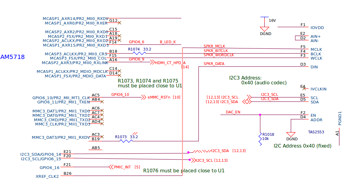

Hello everyone,
We have developed our board in which we use the TAS2553 ic.
Please check the attached image for the connection of  IC with AM5718.
Also check the dtsi configurations as below.

Below is the Schematic snap of connection from AM5718 to TAS2553

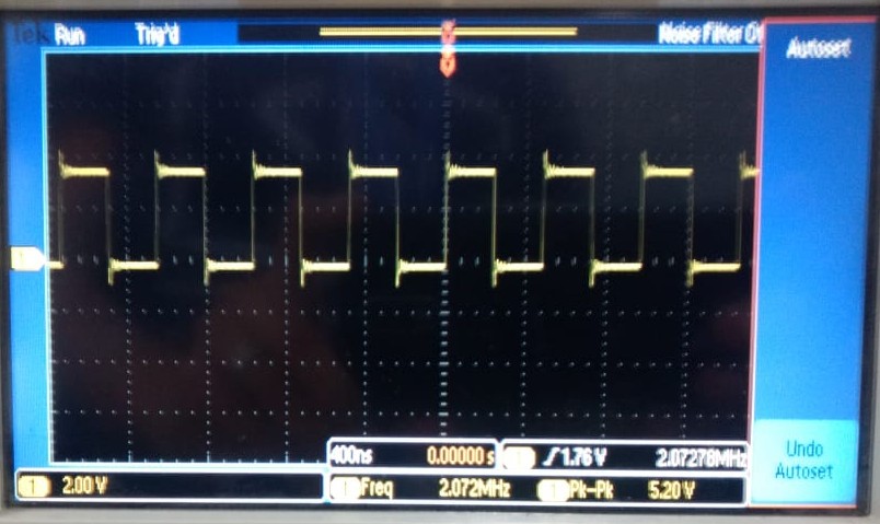

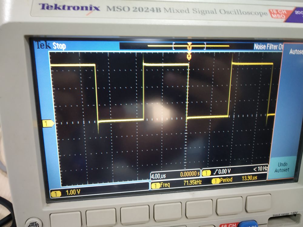

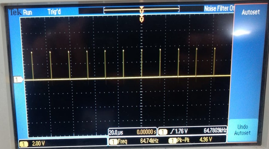

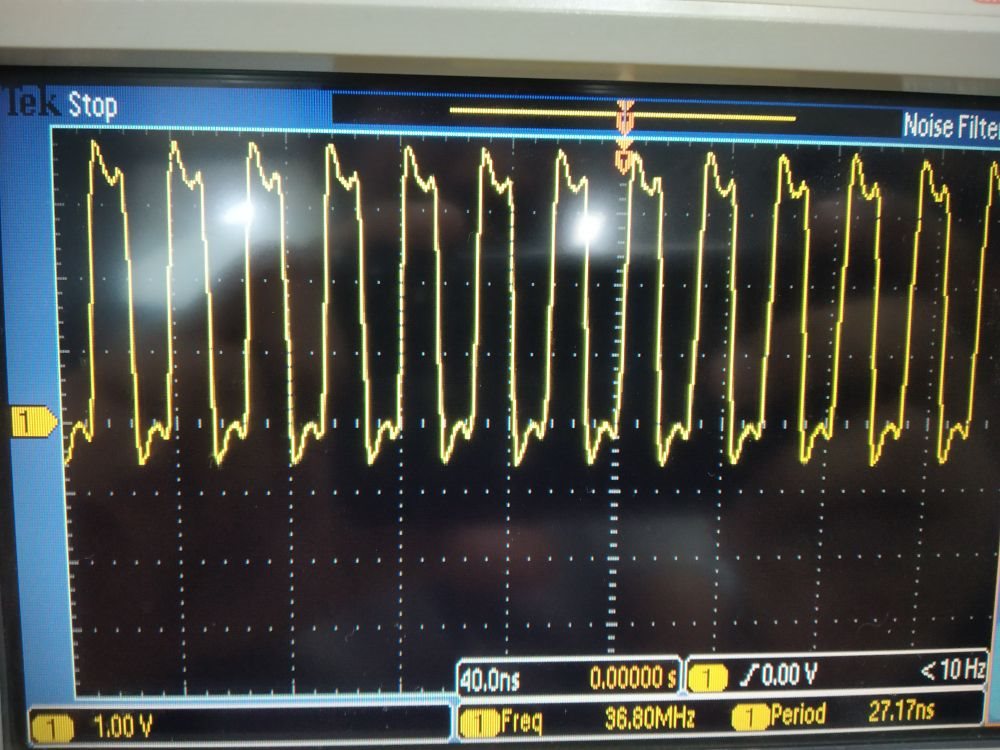

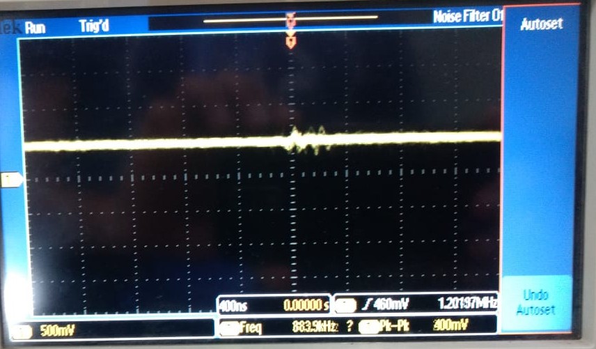

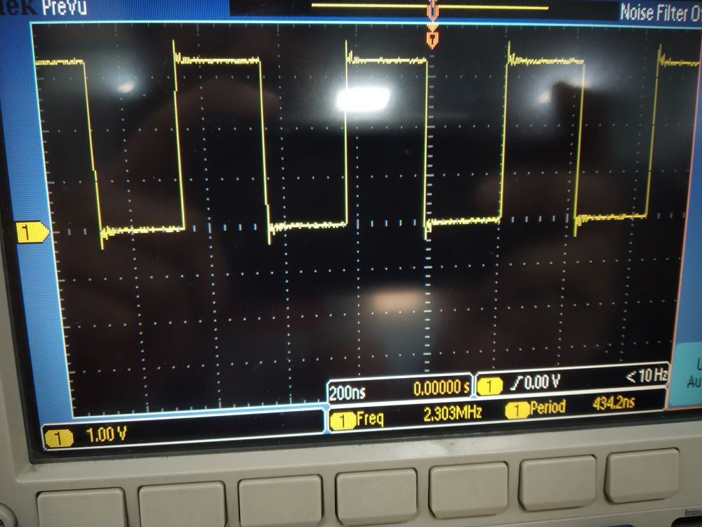

  • Hi Pavel,
    Thanks for your reply.
    We are using the "{XREF_CLK2, (M0 | PIN_INPUT)}, /* xref_clk0" mode and then checked with the scope and there was no any frequency on this pin.
    so please help us to select the proper mode which can be generate 12 MHz Frequency.
    bythe way we have added the "clk_id=TAS2552_PLL_CLKIN_1_8_FIXED;" line in "tas2552_set_dai_sysclk" api of tas2552 codec driver to enable the internal oscillator.
    Also, modify below changes in dts.
    sound0_master: simple-audio-card,codec {
    sound-dai = <&tas2552>;
    system-clock-frequency = <1800000>;
    Then after we neasured the signals as attached
    1) MCLK
    2) BITCLK
    3) WORDCLK
    As per mesuring signal using CRO still MCLK does not proper and still sound is not proper.
    Thanks & best Regards;
    Nikunj Patel
  • Nikunj,
    You can try to set pin B26 in mode 3 (mcasp3_ahclkx). Check the below e2e thread for details:
    e2e.ti.com/.../574916

    Do you need to output 12MHz or 20MHz on B26 pin (mode mcasp3_ahclkx)? What is the current frequency (if any) you have on that pin?
    Ans: We need 20Mhz on B26 Pin. We have measured using CRO as per attached image which has some garbled value.

    Now We got the frequency 36.80 MHz on MCLK as per attched images. so please help us  for how to set the MCLK for 20 MHz.
    Also as per the reply by the  "Ivan Salazar"  the WCLK for "44.1ksps sampling rate" should be 44.1 Khz but why our wclk is 71.95 Khz.
    so is there required another parameter setting for that?
    BCLK=2.303 Mhz
    WCLK=71.95KHz
    MCLK=36.80MHz
    Thanks & Best Regards;
    Nikunj Patel

  • Hi Pavel;
    then we have added one line as below then we can run the wav file.
    simple-audio-card,cpu {
    sound-dai = <&mcasp3>;
    system-clock-direction = "out";
    + system-clock-frequency = <24000000>; [just for testing]
    Now we measured the frequency on B26 Pin and it was approx 3.1 Mhz.
    Please check the below register values.
    [ 99.429250] DAVINCI_MCASP_AHCLKXCTL_REG 8000
    [ 99.433624] DAVINCI_MCASP_ACLKXCTL_REG b0
    [ 99.437733] DAVINCI_MCASP_PDIR_REG bc000004
    [ 99.442016] CM_L4PER2_MCASP3_CLKCTRL 02
    [ 21.992556] CM_CLKSEL_PER_ABE_X1_GFCLK_MCASP_AUX 00
    Nikunj Patel
  • Hi Pavel
    Above measured frequency was wrong. Now frequency on B26 is 19.97MHz.but now no any audio sound. so can you help us to get the 12Mhz frequency on this pin.
    Nikunj Patel

  • Hi Pavel;
    We changed dtsi file as per below then we are able to run the .wav file but sound are not clear.
    1. I see you are missing bitclock-master, frame-master, sound0_master entries in the sound0 node. Please update and try again.
    Ans: we changed as per below but then TAS2553 IC become master. We measures the WCLK is 64 Khz, BCLK is 2.1 Mhz and MCLK is 20MHz. As per our understanding WCLK should be 44Khz. also we refered the different dtsi files for tas2552/tas2555/tas2557 IC and all are using the TAS255x IC as slave not master.
    2."model = "ti-tas2550";" - what is this? Looks suspicious. From where you get info that such entry should be used?
    Ans: we removed this
    3. "system-clock-id = <TAS2552_PLL_CLKIN_1_8_FIXED>;" - what is this? Looks suspicious. From where you get info that such entry should be used?
    Ans: TAS2553 IC support different clock selection for "PLL_CLKIN". we don't have 22.5792 MHz so we are using the internal Oscillator so we have chnaged this and is was varified.
    sound0: sound0 {
    status = "okay";
                   compatible = "simple-audio-card";
                   simple-audio-card,name = "TAS2552";
                   simple-audio-card,format = "i2s";
                   simple-audio-card,widgets =
    "Speaker", "Speaker External";
                   simple-audio-card,routing =
                  "Speaker External", "OUT";
                   simple-audio-card,bitclock-master = <&sound0_master>;
    simple-audio-card,frame-master = <&sound0_master>;
                   sound0_master:simple-audio-card,codec {
  • Nikunj,
    The AM571x or the codec may be driving the clocks (master):
    - MCLK is the codec clock. The IC needs it to be working. Some codecs are able to use BLCK as their clock. It is sometimes referred as the system clock.
    - BCLK is the bit clock. It is provided by the master (either AM571x or the codec).
    -WCLK is the word clock. It is often called LRCLK (Left Right clock) or FCLK/FSCLK (Frame clock). It is provided by the master (either AM571x or the codec). Its rate is the sample rate.
    - DIN and DOUT are the data lines.
    - The relationship between BLCK and WCLK is:
    Bclk = Wclk ∗ Nchannels ∗ BitDepth
    - usually the codecs will expect MCLK to be a multiple of BCLK. Usually specified as a multiple of Fs.
    - however, some codec have a great set of PLLs and dividers, allowing to get a precise BCLK from many different MCLK rate
    - quite often, not the case for the SoC, then use the codec as master!
    From what I understand your latest decision is to make Codec to be master (driving bclk and wclk), is this correct? In this case you need to check with Audio team what frequency you need on codec MCLK input, as the codec to be able to produce the correct bclk/1.4112 MHz and wclk/44.1KHz:
    44.1 kHz × 16 × 2 = 1.4112 MHz
    I can help you with your setup from the AM571x MCASP side, but from audio codec side, you should check with Audio team.
    So, from AM571x MCASP side, you to need to know how to change output clock frequency on pin B26 from 20MHz to 12MHZ, is that correct?
    If yes, try with the below DTS update and report back the result:
                      - system-clock-frequency = <1800000>;
                    + system-clock-frequency = <12000000>;
    Pavel
  • Hi Pavel
    Sound0_master:simple-audio-card,codec {
    We check with above changes but still MCLK is 20MHz.
    Note: We use speaker of 8Ohm. also, we use only DIN pin of TAS2553 we don't use the DOUT pin of TAS2553.
    Can you more explanation about the channels?
    Ans: Yes.  I also post the query on Audio forum but still no any reply. but as per checking different forum it should be 12MHx or 22.579200 MHz if we select the 12MHz so tas2552 driver will set the PLL automatically which is verified.
    Nikunj Patel
  • Nikunj,
    I see two options we can try here:
    1. We can try to increase McASP aux clock from 20MHz to 24MHz, then divide it by 2 with setting MCASP_AHCLKXCTL[11:0] HCLKXDIV = 0x1 (divide by 2)
    2. Or we can try to decrease McASP aux clock from 20MHz to 12MHz in DPLL_ABE settings.
    For both options, I need from you to provide me the below registers settings you have on your board:
    CM_CLKSEL_DPLL_ABE
    CM_CLKMODE_DPLL_ABE
    CM_DIV_M2_DPLL_ABE
    CM_DIV_M3_DPLL_ABE
    CM_IDLEST_DPLL_ABE
    CM_CLKSEL_ABE_PLL_REF
    CM_CLKSEL_ABE_PLL_SYS
    Also, what is the frequency of SYS_CLK1 (OSC0), it can be 19.2, 20 or 27MHz?
    Do you have OSC1 on your board? If yes, what frequency?
    Pavel
  • Hi Pavel;
    Thanks for the Great help;
    Ans: 20MHz
    Actually, There was our board/speaker issue. Today we prepare two new boards and test new boards with below changes and the there was clear sound. still you can check the below our dtsi setting and tell us if we miss/wrong configuration.
    sound0: sound0 {
    status = "okay";
    &mcasp3 {
    #sound-dai-cells = <0>;
    status = "okay";
    op-mode = <0>;          /* MCASP_IIS_MODE */
    tdm-slots = <2>;
    serial-dir = <
    1 0 0 0
    tx-num-evt = <8>;
    rx-num-evt = <8>;
