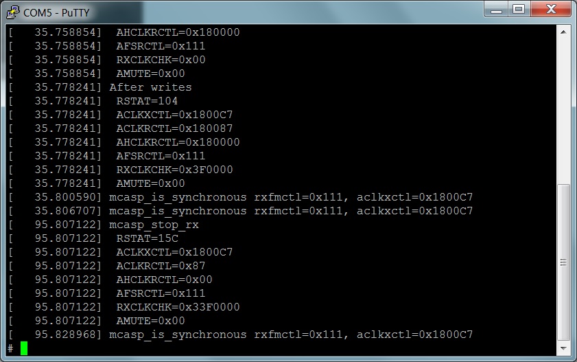

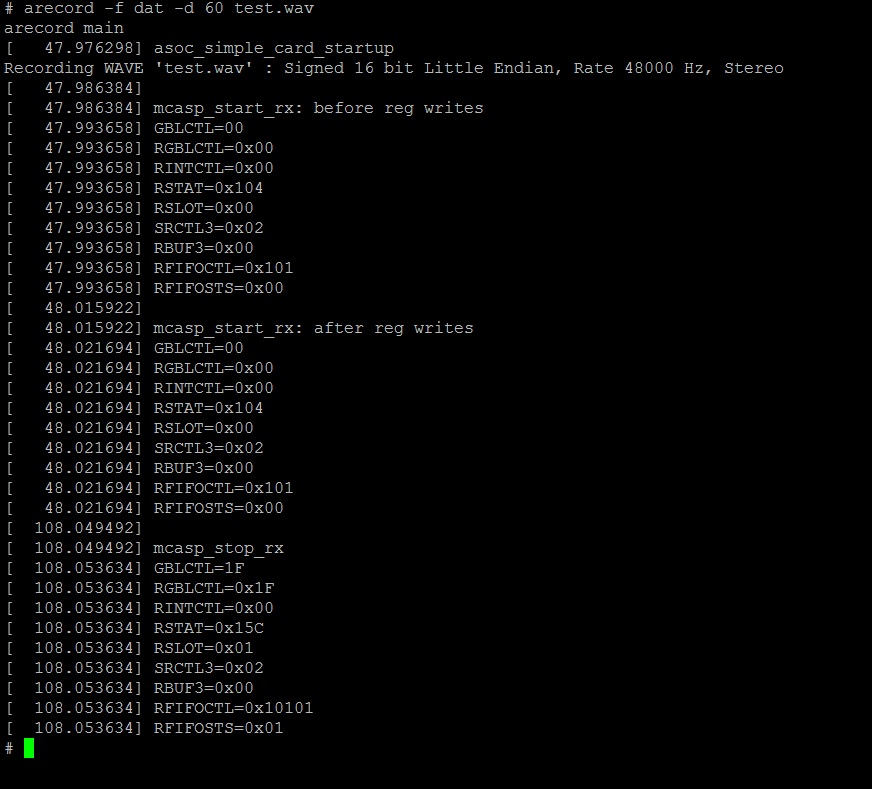

My problem is that when I run arecord all of the samples in the captured file are 0x0000.
I have a pcm1862 connected to mcasp0 as defined in the .dts file here:

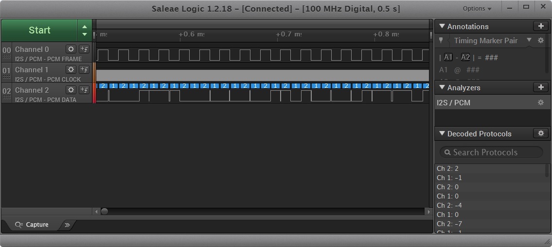

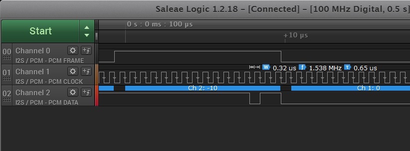

There are no connections to the other mcasp0 signals. Here are analyzer captures during arecord showing the BCK, LRCK and DATA signals on the i2s bus connected to mcasp0.
I added register reads, writes and printk statements to davinci-mcasp.c to help troubleshoot this problem. The labels should match the names in "AM437x and AMIC120 ARM® Cortex™-A9 ProcessorsTechnical Reference Manual" with the omission of MCASP_. The first captures shows the contents of the registers that I think have an impact prior to writing to them in start_rx.
The next capture shows the contents of the registers after the writes and then when stop_rx is called. Here is the code for the register writes which includes setting bit 6 in ACLKXCTL so that there is no dependency between the TX clocks and RX clocks. Here is code where I write new values to registers:
mcasp_set_reg(mcasp, DAVINCI_MCASP_RXCLKCHK_REG, 0x003F0000);
mcasp_set_reg(mcasp, DAVINCI_MCASP_RXSTAT_REG, 0xFFFFFFFF);
mcasp_set_bits(mcasp, DAVINCI_MCASP_ACLKXCTL_REG, TX_ASYNC);
__davinci_mcasp_set_clkdiv(mcasp, MCASP_CLKDIV_BCLK, 8, 0);
Setting bit 6 of ACLKXCTL got me passed the problem of the interrupt not firing but the captured file is all zeros (except for the header) even though the analyzer trace shows data. I am still getting an RX clock failure indication and I think it might be related to my problem.
I would like to get some direction where to look next. Any help would be appreciated.

  • We started with ti-processor-sdk-linux-am437x-evm-04.03.00.05 but are using buildroot-2018.05 because the sdk did not have the pcm186x driver. As was indicated in a previous post TI is no longer supporting the pcm186x driver for linux.
    The register reads and writes in my terminal captures are directly from the MCASP interface from the davinici-mcasp driver. The initial values may be impacted by the OS via the davinci-mcasp but the driver is in control of the mcasp register access.

  • In the above terminal captures
    CTRL_CONF_MCASP0_AHCLKR  is AHCLKRCTL,
    CTRL_CONF_MCASP0_ACLKR  is ACLKRCTL,
    CTRL_CONF_MCASP0_FSR is AFSRCTL and
    CTRL_CONF_MCASP0_AHCLKX is ACLKXCTL as seen by the davinci-mcasp driver. My goal is to have mcasp0 operate asynchronusly (rx clocks do not depend on tx clocks) and the LRCK and BCK clocks not derived from AHCLKR. Because I am still getting an RX clock failure in RSTAT there may be a configuration problem.
    I tried changing the mcasp0 pins to use PIN_INPUT_PULLDOWN instead of PIN_INPUT but got the same results. Also, I updated the mcasp0 definition as follows:

  • Sorry, I wasn't aware of how the pinmux actually works. I thought you meant the mcasp register values. Here's what I got using devmem (from busybox):
    Right or wrong, I think this is consistant with the device tree enteries. All four pins are active and in mode 0 except CTRL_CONF_MCASP0_AHCLKX (0x44E109AC) set to mode 2 (if I'm reading the spec correctly).
    Are there pin options I should try to see if they make a difference?
    Thanks for all your help so far on this.

  • The quick answer is:
    - Which PCM1862 pin is connected to McASP0 AHCLKR pin? Both pins are connected to an external oscillator
    - What is the frequency you have on McASP0 AHCLKR pin?  12.288mHz
    - What is the frequency you have on McASP0 ACLKR pin? 1.536mHz
    - What is the frequency you have on McASP0 FSR pin? 48kHz
    Here are the details:
    A 12.228Mhz oscillator is connected to pin 1 (CLKIN) of a PI6CV304 clock buffer with pin 3 (OE) tied to 3.3v.
    pcm1862 pin 15 (SCKI) is connected to pin 8 (Y3) of the PI6CV304 with a 22ohm resister in line.
    McASP0 AHCLKR (M24) is connected to pin 3 (Y0) of the PI6CV304 with a 22ohm resister in line.
    I have test leads on pin 18 (DOUT), pin 17 (BCK) and pin 16 (LRCK) of the pcm1862.
    From the analyzer traces above:
    BCK is ~ 1.536Mhz (consistent with stereo 16 bit samples at a sample rate of 48Khz).
    LRCK is ~ 48Khz (consistant with the specified -f dat parameter supplied with arecord)
    I also verifed that the registers in the pcm1862 have the proper values written over the i2c interface for these clock rates.
    McASP0 ACLKR (L23) is connected to pcm1862 pin 17 (BCK) with a 22ohm resister in line.
    McASP0 FSR (K23) is connected to pcm1862 pin 16 (LRCK) with a 22ohm resister in line.
    McASP0 AHCLKX (L24) is connected to pcm1862 pin 18 (DOUT) with no resister in line.
  • Nick,
    From what I understand, you do not need to use mcasp0_ahclkr pin at all. When output, this pin is used to supply other chips with clock. When input, this pin is used to produce the bit clock. But you are using McASP0 as slave, thus supply the bit clock from external chip.
    But mcasp0_ahclkr pin is not related to your main issue. Please provide me the values of the below McASP0 registers for review:
    GBLCTL
    RGBLCTL
    RINTCTL
    RSTAT
    RSLOT
    SRCTL3
    RBUF3
    RFIFOCTL
    RFIFOSTS
    You should get these register values from the mcasp linux driver, after running arecord command.
    Pavel
  • Pavel,
    Here's the results of the register reads:
  • Hope this helps,

  • Pavel,
    If you look at the value of RGBLCTL after the capture it is 0x1F like your example. I believe this shows that the mcasp must be setup correctly but the data pin isn't seeing data. I'm going to try to verify the connection from the pcm1862 DOUT to the mcasp pin on an unstuffed board. I thank you for your patience. I going to consider this problem resolved. There is a lot of good troubleshooting information here that other people can use.
