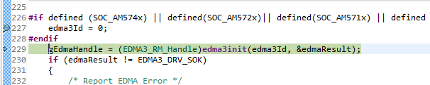

When trying to send data via the UART low level drivers, I call at the beginning the function 'UART_initConfig(true)' and this function calls as a result the function 'UartApp_edmaInit()'. I hit a breakpoint inside that function 'UartApp_edmaInit()' , see here:
The next instruction is a DMA library function 'edma3init' and calling this one leads to a termination of the program, see here:
The 'edma3init' function is a pre-compiled library so further debugging with the JTAG is not possible. I verified that the following lines are inside the *.cfg file:

    When crashed, you may use CCS tools----->ROV classic to see if any exception, stack, heap issues: processors.wiki.ti.com/.../Processor_SDK_RTOS:_TI_RTOS_Tips_And_Tricks
    If you need to step through the EDMA code for edma3init() function:
    Check the map file:
    E.g: C:\ti\edma3_lld_2_12_05_30C\packages\ti\sdo\edma3\drv\sample\lib\tda2xx-evm\a15\debug\edma3_lld_drv_sample.aa15fg(sample_arm_init.oa15fg)
    ./main_uart_test.o (edma3init)
    So you know which edma library is used, then you can add the source code file (E.g: C:\ti\edma3_lld_2_12_05_30C\packages\ti\sdo\edma3\drv\sample\src\sample_arm_init.c) of this function into your project to build (use -O0) without any optimization, then you should be able to step through the code (which was provided in a library format).

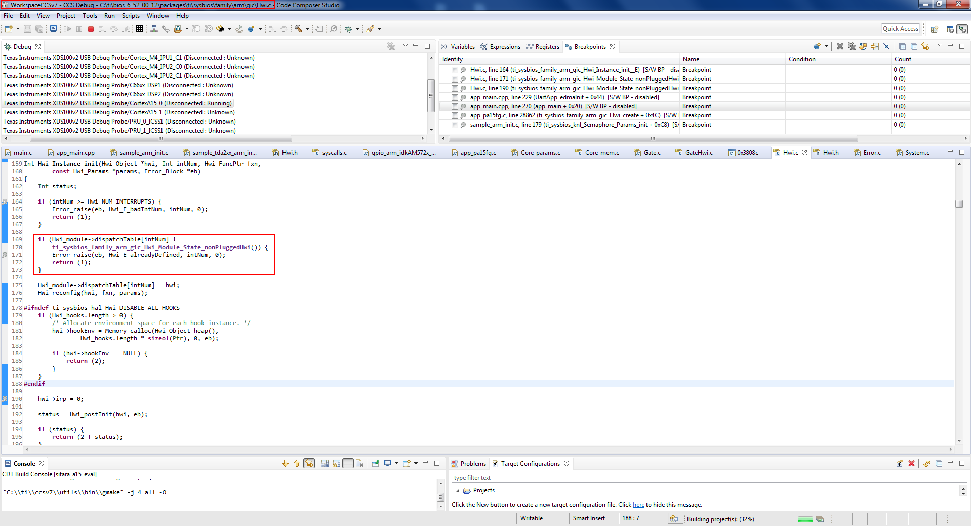

    Both functions UartApp_edmaInit() and the GPIO_init() call after a chain of function calls finally a function called Hwi_Instance_init() inside the file:
     C:\ti\bios_6_52_00_12\packages\ti\sysbios\family\arm\gic\Hwi.c.

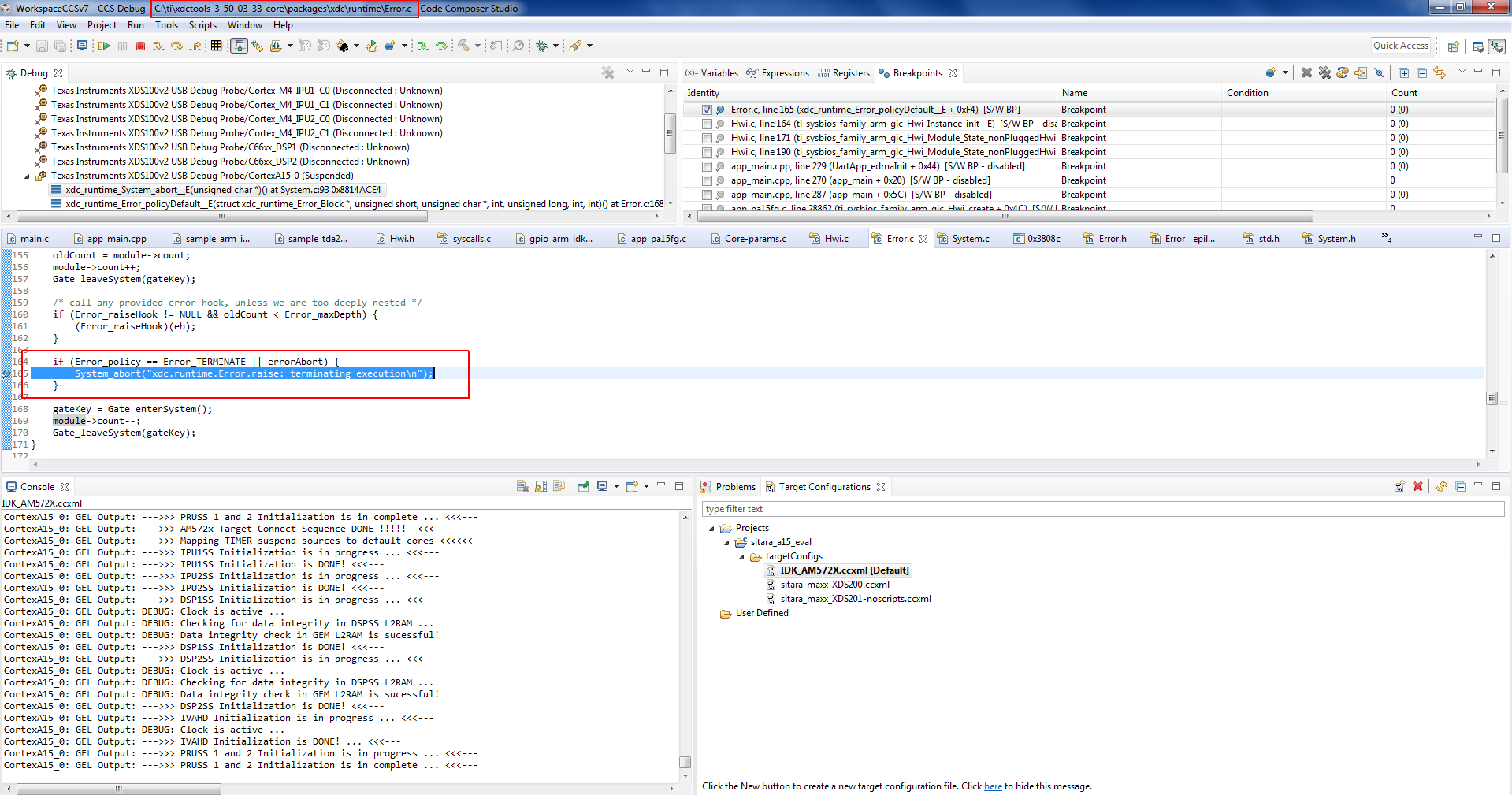

    We don’t face any issues in case that this function is called for the first time, but if that function is being called for the second time, then we finally end up with the below Error_raise() function call.
    This function call causes the program termination inside function Error_policyDefault of the file C:\ti\xdctools_3_50_03_33_core\packages\xdc\runtime\Error.c.
    So if UartApp_edmaInit() is called first, then GPIO_init() causes the program termination and vice versa. But both functions are required since we want to use the UART in combination with DMA based transfer to/from the Tx/Rx FIFOs and also the GPIOs must be properly initialized.

  • Hi All,
    It looks duplication of e2e.ti.com/.../739574
    We got software abort because we re-used 2 examples, both use the same IRQ 67 for two (2) different purposes - interrupt from Input and UDMA.
    If you do not mind, I suggest to close this thrread and continue in e2e.ti.com/.../739574
