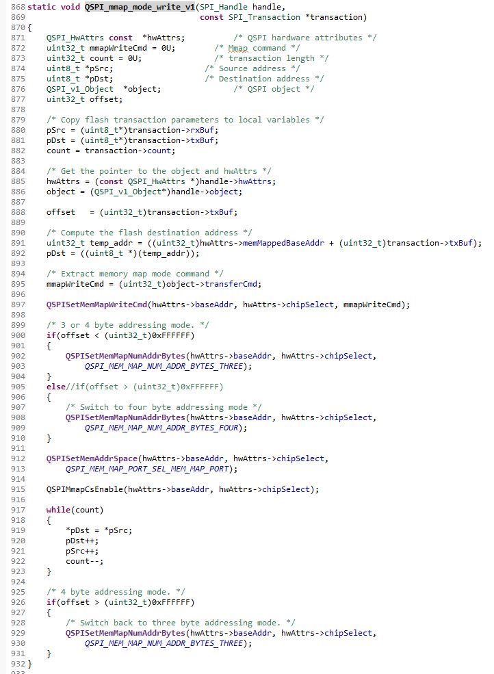

I am trying to write to flash on the AM437x Industrial Development Kit.
I have access to the QSPI_BasicExample_idkAM437x_armExampleProject.
I have also integrated the spi_test() and spi_read_write() from the example.
Here is the problem: If this number is changed to anything below 64, it works. When this number is 64 or greater it fails.
void spi_test()
    SPI_Params   spiParams;              /* SPI params structure */
    S25FL_Handle flashHandle;            /* Flash handle */
    bool         retVal = false;         /* return value */
    /* Init SPI driver */
    SPI_init();
    /* Default SPI configuration parameters */
    SPI_Params_init(&spiParams);
    /* Open QSPI driver */
    flashHandle = SF25FL_open(((QSPI_INSTANCE - 1)+(QSPI_OFFSET)), &spiParams);
    /* Print flash Id */
    FlashPrintId(flashHandle);
    /* Set the transfer length in number of 32 bit words */
    transferLength = 50;
    /* read/write test on block 0, address 0 */
    retVal = spi_read_write(flashHandle, 0, transferLength);
    if (retVal == true)
        /* read/write test on block 256, address 16M */
        retVal = spi_read_write(flashHandle, 256, transferLength);
    SF25FL_close(flashHandle);
    if(true == retVal)
        DebugLog::Write("\n All tests have passed. \n");
    else
        DebugLog::Write("\n Some tests have failed. \n");
    while(1);

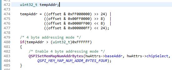

I have narrowed it to failing at the highlighted line below in the function in the class S25FL.cbool SF25FL_bufferWrite(S25FL_Handle flashHandle, S25FL_Transaction* flashTransaction)
if(QSPI_OPER_MODE_MMAP == object->qspiMode)
    for(idx = 0; idx < length; idx++)
        /* Write enable */
        S25FLFlash_WriteEnable(flashHandle);
        /* Perform the transfer */
        transaction.txBuf = (unsigned char *)dstOffstAddr;
        transaction.rxBuf = srcAddr;
        transaction.count = 1;
        transferType = SPI_TRANSACTION_TYPE_WRITE;
        if (dstOffstAddr > 0xFFFFFFU)
           transferCmd  = QSPI_LIB_CMD_PAGE_PRG_4B;
        else
            transferCmd  = QSPI_LIB_CMD_PAGE_PRG;
        SPI_control(handle, SPI_V1_CMD_TRANSFERMODE_RW, (void *)&transferType);
        SPI_control(handle, SPI_V1_CMD_MMAP_TRANSFER_CMD, (void *)&transferCmd);
        retVal = SPI_transfer(handle, &transaction);
        /* Check flash status for completion */
        while ((FlashStatus(flashHandle) & 0x1U));
        dstOffstAddr += 1;
        srcAddr += 1;
Seeing as I am using example code, I am wondering why this is failing.
Any help would be greatly appreciated.
  • The RTOS team have been notified. They will respond here.
  • I think it may have to do with the file: QSPI_v1.h because it says it is implementing drivers for the AM572x and that isn't even the correct board.
    Not sure if this is the issue or how to resolve it.

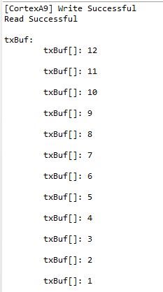

  • Thank you for your response.
    I took those two files and started doing some testing.
    I can still get it to fail with those two files.
    In the file: 'main_flash_read_test.c' line 120
    `unsigned int blockNumber = 0U;`
    If you change that to anything above 63, it fails.
    Do you know the reason for this or how to fix it?

    I will try to help you. First of all, I can see that you try to use memory map mode write. This write mode is slow, as you have to call SPI_control two times, and SPI_transfer one time FOR EACH BYTE you are writing. You should try to use config mode when writing.
    In my code, I use config mode (single mode) when writing, and mmap mode (quad mode) when reading.
    Second, i see you have an issue with a number > 64. I assume this is the number of uint32_t 's to write to flash. A hint is that 64*4 = 255 = 0xFF, so only 1 byte are used for the offsetValue. If you compare the S25FLFlash_BlockErase and SF25FL_ConfigMode_Write, you can see that the offsetValue bytes are correctly "flipped / switched around" in the erase function, but this is not done in the write function. Try doing that in the SF25FL_ConfigMode_Write function as well. "Luckily", this works for only 1 byte addressing, but is not tested for big data sets.
    If you want to read in quad mode. (It does not seem to be necessary when writing, as the single/quad is not the limitation when writing), you have to re-write the S25FLFlash_QuadModeEnable function as well. This small function has a lot of code error, and do not work at all. You can easily be fooled to think that the function is working if you manage to set the quad mode enable one time, as this bit is non-volatile on flash. Please find attached the S25FL.c we are using in our codebase.
     please see the attachment S25FL.c for a fix of the quad mode enable function.
    Also see attachment QSPI_v1.c for a improvement of QSPI_cmd_mode_write_v1(..), with support for up to  128 bit transfers.

    bool S25FLFlash_Enable4ByteAddrMode(S25FL_Handle flashHandle,
                                        bool enable4ByteMode)
        SPI_Handle handle = flashHandle->spiHandle; /* SPI handle */
        unsigned char writeVal;          /* data to be written */
        SPI_Transaction transaction;     /* SPI transaction structure */
        unsigned int operMode;           /* temp variable to hold mode */
        unsigned int rxLines;            /* temp variable to hold rx lines */
        unsigned int transferType;
        QSPI_v1_Object  *object;
        unsigned int rxLinesArg;
        /* Get the pointer to the object and hwAttrs */
        object = handle->object;
        /* These operations require the qspi to be configured in the following mode
           only: tx/rx single line and config mode. */
        /* Save the current mode and rxLine configurations */
        operMode = object->qspiMode;
        rxLines  = object->rxLines;
        /* Update the mode and rxLines with the required values */
        SPI_control(handle, SPI_V1_CMD_SETCONFIGMODE, NULL);
        rxLinesArg = QSPI_RX_LINES_SINGLE;
        SPI_control(handle, SPI_V1_CMD_SETRXLINES, (void *)&rxLinesArg);
        /* Command to control the 4 byte mode */
        if (true == enable4ByteMode)
            writeVal = QSPI_LIB_CMD_ENTER_4_BYTE_ADDR;
        else
            writeVal = QSPI_LIB_CMD_EXIT_4_BYTE_ADDR;
        /* Write 4 byte enable/disable command to flash */
        transaction.count = 1U;                    /* Frame length in bytes */
        transaction.txBuf = (unsigned char *)&writeVal;  /* Value to be written */
        transaction.rxBuf = NULL;                  /* Nothing to read */
        transaction.arg   = NULL;                  /* Not applicable */
        /* Restore operating mode and rx Lines */
        object->qspiMode = operMode;
        SPI_control(handle, SPI_V1_CMD_SETRXLINES, (void *)&rxLines);
        return retVal;

    static void QSPI_mmap_mode_read_v1(SPI_Handle handle,
                                       const SPI_Transaction *transaction)
        QSPI_HwAttrs const  *hwAttrs = NULL;
        uint32_t *pDst = NULL;
        uint32_t *pSrc = NULL;
        uint8_t *pDst_8 = NULL;
        uint8_t *pSrc_8 = NULL;
        uint32_t count;
        uint32_t mmapReadCmd = 0U;
        uint32_t offset;
        const uint32_t nNumBytesToTransfer = 4;
        /* Input parameter validation */
        OSAL_Assert(!((handle != NULL) && (transaction != NULL)));
        pDst = (uint32_t *)transaction->rxBuf;
        pSrc = (uint32_t *)transaction->txBuf;
        count = transaction->count;
        hwAttrs = (const QSPI_HwAttrs *)handle->hwAttrs;
        object = (QSPI_v1_Object*)handle->object;
        uint32_t temp_addr = ((uint32_t)hwAttrs->memMappedBaseAddr + (uint32_t)transaction->txBuf);
        pSrc = ((uint32_t *)(temp_addr)); // change this to 8 or 16 as well
        offset = (uint32_t)transaction->txBuf;
        /* Extract memory map mode read command */
        mmapReadCmd = (uint32_t)object->transferCmd;
        /* Set the number of address bytes to three */
        QSPISetMemMapNumAddrBytes(hwAttrs->baseAddr, hwAttrs->chipSelect,
            QSPI_MEM_MAP_NUM_ADDR_BYTES_THREE);

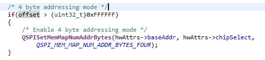

        /* 4 byte addressing mode */
        if(offset > (uint32_t)0xFFFFFF)
            /* Enable 4 byte addressing mode */
                QSPI_MEM_MAP_NUM_ADDR_BYTES_FOUR);
        /* validate receive lines */
        OSAL_Assert(object->rxLines > 2);
        switch(object->rxLines)
            case QSPI_RX_LINES_SINGLE:
                QSPISetMemMapReadCmd(hwAttrs->baseAddr, hwAttrs->chipSelect,
                    mmapReadCmd);
                QSPISetMemMapReadType(hwAttrs->baseAddr, hwAttrs->chipSelect,
                    QSPI_MEM_MAP_READ_TYPE_NORMAL);
                QSPISetMemMapNumDummyBits(hwAttrs->baseAddr, hwAttrs->chipSelect,
                    0x0U);
                while(count)
                    // Do the normal memory to memory transfer. Copy will be in bytes
                    *pDst = *pSrc;
                    pDst++;
                    pSrc++;
                    count--;
                break;
            case QSPI_RX_LINES_DUAL:
                    mmapReadCmd);
                    QSPI_MEM_MAP_READ_TYPE_DUAL);
                    0x8U);
                while(count)
                    *pDst = *pSrc;
                    pDst++;
                    pSrc++;
                    count--;
                break;

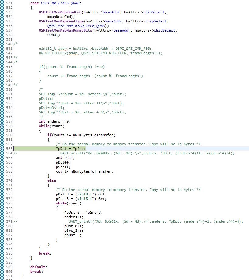

            case QSPI_RX_LINES_QUAD:
                    mmapReadCmd);
                    QSPI_MEM_MAP_READ_TYPE_QUAD);
                    0x8U);
                uint32_t addr = hwAttrs->baseAddr + QSPI_SPI_CMD_REG;
                HW_WR_FIELD32(addr, QSPI_SPI_CMD_REG_FLEN, frameLength-1);
                if((count %  frameLength) != 0)
                    count += frameLength -(count %  frameLength);
                SPI_log("\n*pDst = %d. before \n",*pDst);
                pDst++;
                SPI_log("*pDst = %d. after ++\n",*pDst);
                pDst=pDst+4;
                SPI_log("*pDst = %d. after +=4\n",*pDst);
                int anders = 0;
                while(count)
                    if(count >= nNumBytesToTransfer)
                        /* Do the normal memory to memory transfer. Copy will be in bytes */
                        *pDst = *pSrc;
    //                    UART_printf("%d. 0x%08x. (%d - %d).\n",anders, *pDst, (anders*4)+1, (anders*4)+4);
                        anders++;
                        pDst++;
                        pSrc++;
                        count-=nNumBytesToTransfer;
                    else
                        pDst_8 = (uint8_t*)pDst;
                        pSrc_8 = (uint8_t*)pSrc;
                        while(count)
                            *pDst_8 = *pSrc_8;
                            anders++;
    //                        UART_printf("%d. 0x%02x. (%d - %d).\n",anders, *pDst, (anders*4)+1, (anders*4)+4);
                            pDst_8++;
                            pSrc_8++;
                            count--;
                break;
            default:
            break;
             * After the transfer switch back to 3 byte addressing mode.
             * This is the default mode.

    static void QSPI_mmap_mode_write_v1(SPI_Handle handle,
        QSPI_HwAttrs const  *hwAttrs;          /* QSPI hardware attributes */
        uint32_t mmapWriteCmd = 0U;        /* Mmap command */
        uint32_t count = 0U;               /* transaction length */
        uint8_t *pSrc;                   /* Source address */
        uint8_t *pDst;                   /* Destination address */
        QSPI_v1_Object  *object;               /* QSPI object */
        uint32_t offset;
        /* Copy flash transaction parameters to local variables */
        pSrc = (uint8_t*)transaction->rxBuf;
        pDst = (uint8_t*)transaction->txBuf;
        /* Compute the flash destination address */
        pDst = ((uint8_t *)(temp_addr));
        /* Extract memory map mode command */
        mmapWriteCmd = (uint32_t)object->transferCmd;
        QSPISetMemMapWriteCmd(hwAttrs->baseAddr, hwAttrs->chipSelect, mmapWriteCmd);
        QSPISetMemAddrSpace(hwAttrs->baseAddr, hwAttrs->chipSelect,
            QSPI_MEM_MAP_PORT_SEL_MEM_MAP_PORT);
        QSPIMmapCsEnable(hwAttrs->baseAddr, hwAttrs->chipSelect);
        /* 4 byte addressing mode. */
            /* Switch to four byte addressing mode */
        while(count)
            *pDst = *pSrc;
            pDst++;
            pSrc++;
            count--;
            /* Switch back to three byte addressing mode. */

  • Thanks for your response, I do agree that it is slow so I will confirm that it is okay to write in config mode.
    I have done some preliminary testing and it looks as though it is working.
    I did have to edit something in S25FL.c however to get it to work. (It never sets the return value to true)
    I just added two `retVal = ` otherwise it always returned false even if it worked.

    After Further testing, I have a question:
    I am trying to do direct memory reads instead of block reads.
    So in my read/write I pass the address in the block I want to access.
    In essence: instead of the address being 0x00000U, I make the address : (63* S25FL_FLASH_BLOCK_SIZE) and it works perfectly.
    However, I am back to the same issue when the number is bigger than 63. When the number is 64 or more, it does the write and read "successfully", but the data returned from the read is not even close to what it should be.
    Has anyone attacked this using direct memory read and write?

    Here are a few conclusions I have come too:
    1. In order to be able to read/write in QSPI_OPER_MODE_MMAP, you must leave out this snippet upon initialization:
    m_qSpiMode = QSPI_OPER_MODE_MMAP;
    SPI_control(m_spiHandle, SPI_V1_CMD_SETCONFIGMODE, (void *)&m_qSpiMode);
    It seems that the default is MMAP mode, and this line of code somehow sets it to config mode.
    2. When operating in QSPI_OPER_MODE_MMAP, you can only write up to block 63. I have done what you suggested with writing and reading of values to the corresponding blocks. It seems at any point up to the number 63 it works correctly. (FYI, the math I am doing for MMAP mode is: 63 * S25FL_FLASH_BLOCK_SIZE) When you replace the 63 with a 64, it fails here under SF25FL_bufferWrite(........):
            /* Write enable */
            else
            dstOffstAddr += 1;
            srcAddr += 1;
    I have figured out what I believe to be the fix for the write: Here is the updated code to what I believe to be the fix.
        tempAddr = ((dstOffstAddr & 0xFF000000) >> 24) |
                   ((dstOffstAddr & 0x00FF0000) >> 8)  |
                   ((dstOffstAddr & 0x0000FF00) << 8)  |
                   ((dstOffstAddr & 0x000000FF) << 24);
            /* Write enable */
            transaction.txBuf = (unsigned char *)tempAddr;//(unsigned char *)dstOffstAddr;
            else
            tempAddr += 1;
            dstOffstAddr += 1;
            srcAddr += 1;
    3. Same as 2. but read fails as well. In function SF25FL_bufferRead(...)
                //deleted this to save room on post.
            default:
            break;
        transaction.txBuf = srcAddr;
        transaction.rxBuf = (uint8_t *)dstOffstAddr;
        transaction.count = length;
        transferType = SPI_TRANSACTION_TYPE_READ;
        transferCmd  = (unsigned char)readCmd;
    I have figured out what I believe to be the fix for the read: Here is the updated code to what I believe to be the fix.
    	dstOffstAddr = flashTransaction->address;
    	srcAddr = flashTransaction->data;
    	length = flashTransaction->dataSize;
    			//Deleted to save room for post.
    		default:
    		break;
    The reason I reassigned the variables how there are within the if statement is because I did not want to affect config mode. This is solely a fix for MMAP mode.
    TO CLARIFY: This has only been tested with 3 byte address mode. Meaning that you can write blocks 0 - 255. I will next be trying to tackle 4 byte address mode and see if I can get that to work. If time permits on my project I will try to see if I can further improve Config Mode.
    I have attached my S25FL.c file which is the same as yours with some improvements to MMAP mode options.

    After further testing of QSPI_v1.c, I have run into a few issues.
    First, in: QSPI_mmap_mode_read_v1 there is a line of code that takes the already byte flipped address and checks to see if its bigger than 16MB. Shown below:
    This will always fail because the address has been byte flipped. So if the address was 0x01000000, and you did the byte flop which is required to get things working, it would change it to 0x00000001. While this does require 4 byte addressing, it will never pass.
    • This is in both the read and write functions of QSPI_v1.c
      • static void QSPI_mmap_mode_read_v1(SPI_Handle handle,const SPI_Transaction *transaction)
      • static void QSPI_mmap_mode_write_v1(SPI_Handle handle,const SPI_Transaction *transaction)
    The way I fixed this was to byte flip the address back as such:
    This now ensures that the address 0x01000000 will in fact be that when checking to see if 4 address bytes are needed.
    However it fails on this line in that same read_v1 function:
    It also fails at this same line when in:
    • QSPI_RX_LINES_SINGLE
    • QSPI_RX_LINES_DUAL
    • QSPI_RX_LINES_QUAD
    Any input to help me solve this problem would be greatly appreciated.
  • Hi Chris Taylor90 (5797900)
    I have previously only tested with less than 16 MB, so I have never got to test the if(offset > 0xFFFFFF) tests. But it seems like you are right:
    • If you start on an address offset on flash smaller than 16 MB, and write/read ONLY on address offsets < 16 MB, the code should work fine. ( 3 byte address mode is selected).
    • If you start on an address offset on flash greater than 16 MB, and write/read ONLY on address offsets > 16 MB, the code should work fine. (4 byte address mode is selected).
    • If, however, as I think is the case for you, you start with an address offset < 16 MB (<= 0xFFFFFF), and some of the data to read/write is > 16 MB, 3 byte address mode will be used, and therefore the program will start to read/write from offset 0 on flash (instead of 0x01000000).
    A solution / workaround would be to ALWAYS use 4 byte addressing. It seems like the 3 Byte addressing mode is used for backward compatibility, and that it should be fine to use 4 byte addressing mode, even when using an address offset < 16MB. So instead of having the  if(offset > 0xFFFFFF) tests in the code, use 4B commands. And also set addrLengthInBytes = 4.
    Let me now if this helps, I would like to implement this in my codebase as well.
    Anders.

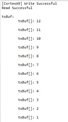

    Here is a sample run through of my program THAT WORKS:
    Block Number I want to access: 255. So the memory mapped address is (255 * S25FL_FLASH_BLOCK_SIZE)  Decimal: [16,711,680]  Hex: [FF 0000]
    It travels all the way down to drivers to the Function:
    For reference, at this point in time: (I am writing 12 values [12,11,10,...1] into flash memory at block 255, as shown in the pDst.
     And the QSPI_QPSI_SETUP_REG_0 reads:  00120203h (Which is correct at this point in time because this address is less than 0xFFFFFF) [We are currently in 3 Byte address mode]
    Then I progress and let the SPI write 1 byte at a time.
    Then I get to the read.
    At this point in time for reference:
    This shows that in flash the 12 is correct because again I should be reading from 12-1 from flash into a buffer.
    As I progress through the read, I can see the above pointers incrementing correctly. Shown:
    I let the read finish, I do the VerifyData function and it is successful.

    So I progress to the Write function (same one as above) and for reference here is the variables:
    So again, it seems to me that the variables are correctly pointed.
    Then comes the QSPI_QSPI_SETUP_REG_0 which still read 00120203h until the offset is checked:
    After this the register reads: 00120303h which is correct, it has now entered 4 byte mode.
    Now following this register change, it does the write to memory:
    My variables (pDst and pSrc) are still the same as shown above with the highlighted pDst.
    However, Once I execute this line of code [*pDst = *pSrc] the values should change, but they are still:
    When looking at actual memory, the value did not change either:
    That highlighted portion should read FFFFFF0C (AFTER FURTHER TESTING, YOU CANNOT TRUST THE VIRTUAL MEMORY MAP FOR ANYTHING OVER THE ORIGINALLY ALLOTTED 16 MB)
    After it executes the single loop through that shown while loop, it does another check to set back into 3 byte address mode.

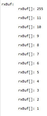

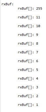

    Now it does the read function: Copies everything back over correctly I think.
    After this, it travels all the way back up.  I have some testing on the top layer and here is my response:
    I have not been able to figure out why the first entry is incorrect.
    I read the data back from flash front and backward and still come up with this result.
    Due to this, my thoughts are that the error is in the read.

        SPI_close(handle->spiHandle);
     *  ======== SF25FL_open ========
    S25FL_Handle SF25FL_open(unsigned int index, SPI_Params *params)
        S25FL_Handle s25flHandle;
        s25flHandle = &s25flObject;
        /* Open SPI driver for SF25FL */
        s25flHandle->spiHandle = SPI_open(index, params);
        return s25flHandle;
     *  ======== SF25FL_bufferWrite ========
        unsigned int idx;                           /* index */
        uint32_t dstOffstAddr;                      /* Flash offset address */
        unsigned char *srcAddr;                     /* Address of data buffer */
        uint32_t length;                            /* data length in bytes */
        unsigned char transferCmd;
        uint32_t offsetValue;
        uint32_t tempAddr;
        //SPI_log("In function SF25FL_bufferWrite. 1\n");
        if(QSPI_OPER_MODE_CFG == object->qspiMode)
            offsetValue = *((uint32_t *)dstOffstAddr);
            //SPI_log("In function SF25FL_bufferWrite. (cfg mode) 2\n");
             * Config mode write supports 256 bytes at a time. So if the length is
             * greater than 256, then multiple transactions have to be performed till
             * all the bytes are written.
            while(length > 256)
               retVal = SF25FL_ConfigMode_Write(dstOffstAddr, srcAddr, 256, flashHandle);
                *((uint32_t *)dstOffstAddr) += 256;
                srcAddr += 256;
                length -= 256;
            if(length > 0)
                retVal = SF25FL_ConfigMode_Write(dstOffstAddr, srcAddr, length, flashHandle);
            *((uint32_t *)dstOffstAddr) = offsetValue;
                S25FLFlash_Enable4ByteAddrMode(flashHandle, true);
            else
                /* Write enable */
                dstOffstAddr += 1;
                srcAddr += 1;
                S25FLFlash_Enable4ByteAddrMode(flashHandle, false);
        return retVal;
    bool SF25FL_bufferRead(S25FL_Handle flashHandle,
        unsigned char writeVal[4];               /* data to be written */
        uint32_t addrLengthInBytes = 3U;         /* Flash address length in bytes */
        uint32_t readCmd;                        /* Read command */
        uint32_t numDummyBits;                   /* Number of dummy bits */
        uint32_t frameLength;                    /* Frame length */
    /*  unsigned int *tempPtr = (unsigned int *)&writeVal[0]; */ /* temp pointer */
        unsigned int frmLength;
        uint32_t tempAddr;
        srcAddr = (unsigned char *)flashTransaction->address;
        dstOffstAddr = (uint32_t)flashTransaction->data;
            offsetValue = *((uint32_t *)srcAddr);
            if(offsetValue > 0xFFFFFF)
                /* Enter 32 bit addressing mode */
                addrLengthInBytes = 4;
                        readCmd = QSPI_LIB_CMD_READ_SINGLE_4B;
                    else
                        readCmd = QSPI_LIB_CMD_READ_SINGLE;
                    numDummyBits = 0U;
                    /* total transaction frame length in number of words (bytes)*/
                    frameLength = length + 1 + addrLengthInBytes;
                    break;
                        readCmd = QSPI_LIB_CMD_READ_DUAL_4B;
                    else
                        readCmd = QSPI_LIB_CMD_READ_DUAL;
                    numDummyBits = 8U;
                    frameLength = length + 1 + 1 + addrLengthInBytes;
                    break;
                        readCmd = QSPI_LIB_CMD_READ_QUAD_4B;
                    else
                        readCmd = QSPI_LIB_CMD_READ_QUAD;
                    numDummyBits = 8U;
                    break;
                default:
                break;
            /* total transaction frame length */
            frmLength = frameLength;
            SPI_control(handle, SPI_V1_CMD_SETFRAMELENGTH, (void *)&frmLength);
            /* Write read command */
            writeVal[0] = readCmd;
            transaction.txBuf = (unsigned char *)&writeVal[0];
            /* Write dummy bits for fast read if required */
            if(0 != numDummyBits)
                writeVal[0] = 0U;
                transaction.count = (numDummyBits >> 3);      /* In bytes */
            /* Write Address Bytes */
    /*      *tempPtr = (unsigned int)srcAddr; */
    /*      transaction.txBuf = (unsigned char *)tempPtr; */
            transaction.txBuf = (unsigned char *)srcAddr;
            transaction.count = addrLengthInBytes;
            /* Read the actual flash data */
            transaction.txBuf = NULL;
            transaction.rxBuf = (unsigned char *)dstOffstAddr;
            /* Enable 4 byte addr mode */
            if(flashTransaction->address > 0xFFFFFF)
                    else
                    break;
                    else
                    break;
                    else
                    break;
                default:
                break;
        return retVal;
