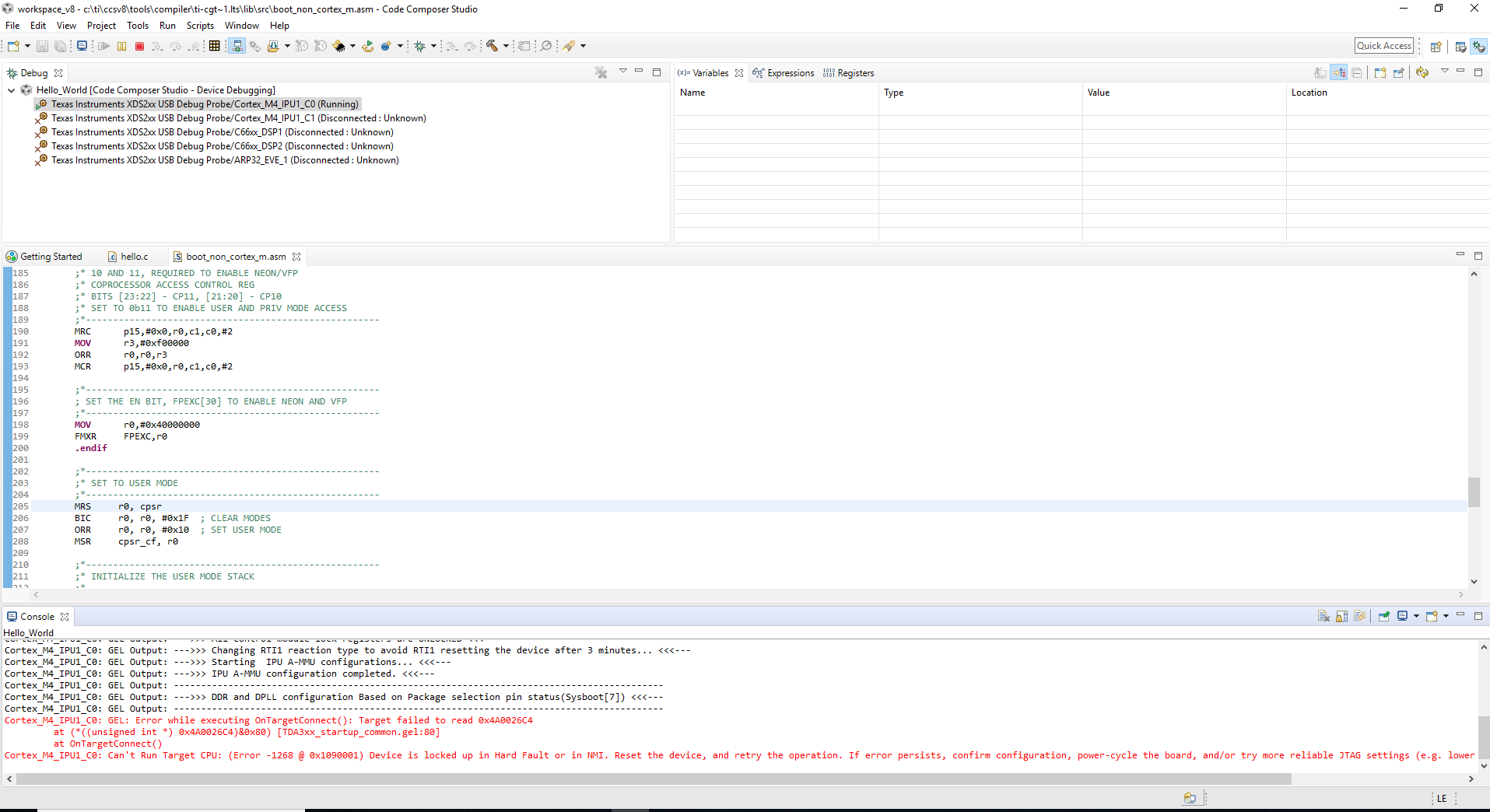

I get load error when I try to load Hello World Program from CCS version 8.2 debugger ?
Attached is the error:

Hi Rishabh
Following is my setup of CCS Hello_World Project:
What might be the problem?
There is no linker command file.
When I installed CCS, I think it selects XDS100 Debug Probe.
When I created the project, I selected XDS2xx as shown above. This is because I'm using XDS200 Debug Probe.

Hi Amer,
Endianness should be LE.
You can pick Processor SDK Vision from http://www.ti.com/tool/PROCESSOR-SDK-TDAX to start the development.
