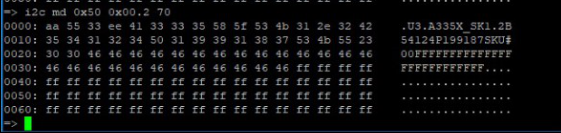

  • Hi Yordan
    I see mac_addr define in both ti_am_eeprom and ti_common_eeprom in board_detect.h
    We put EEPROM back to board, and write data as below picture
    Could you teach me how to read it in board_eth_init and board_late_init?
    You should use I2C or SPI reads, depending on how you connect your EEPROM to the AM3352.
    Yordan

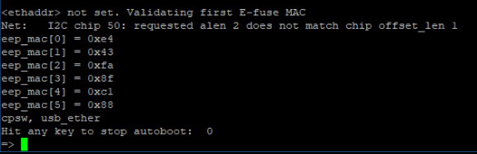

  • hi Yordan
    I add code in board.c as below
    but I can get correct data, could you help me check the code?
    Our i2c bus is 0, eeprom address is 0x50
    my eeprom data
    Data read by my code
    thanks.
    In your board.c file, do you have the enable_i2c0_pin_mux() and i2c_init() functions.
    I would suggest to use the same approach as with the board detect (which reads a magic number from the EEPROM). Use the above functions to initialize the i2c interface, then use ti_i2c_eeprom_am_get() to init eeprom chip and then use ti_i2c_eeprom_read() to get data from eeprom.
    Yordan
