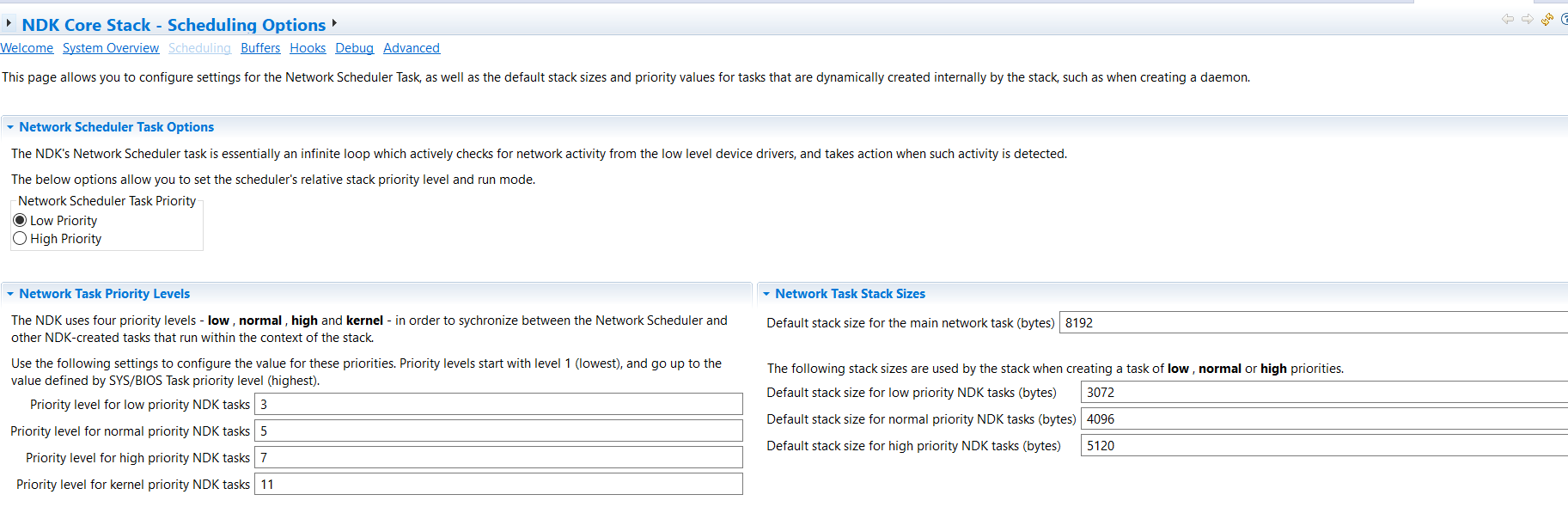

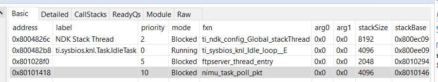

    I don't know what is the NDK task, is it the packet polling from EMAC driver? I take a look of our NDK example on other processors, using CCS ROV view:
    The NIMU driver has to have the highest task priority. You may increase your receiver task priority higher. Will this help?
    Also, in the .cfg file when you create the CCS project, if you open it with XGCONF tool, under scheduling:
    You may check NDK user guide to see how to set this up.
