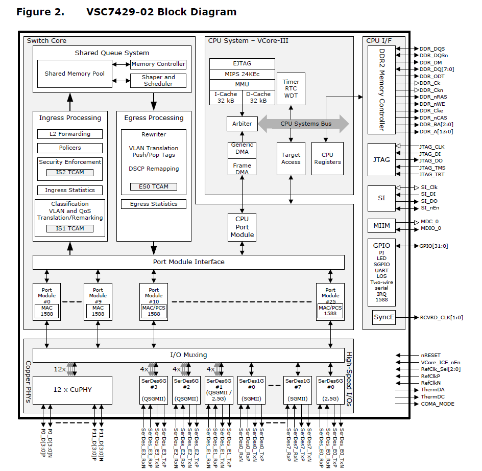

    I have attached the ethernet topplogy for your reference. K2H SGMII ports are connected to Ethernet switch's SGMII. Ethernet switch has 12 internal PHY's and 4 of them are connected to RJ45.

    Why does the switch block diagram show 12 PHY blocks?  Does it truly connect directly to the RJ45 connectors with MDI pairs?
    We are not using all 12 PHY's. We are using only 4 PHY ports. They just shown the multiplexing in the block diagram.
    4 PHYs are directly connected to RJ45 .

    I have attached the ethernet switch block diagram for your reference.
