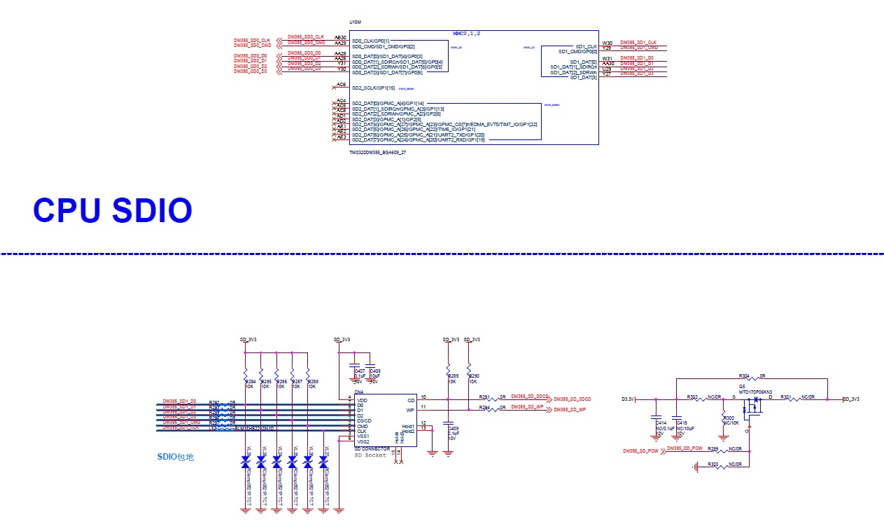

Hi SIr
We used DM385 with SDK 3.5.0. (Kernel 2.6.37).
We found SDcard Detection issue in some vendor sdcards (especially 32G).
below is the failed log message
mmc0: req done (CMD0): 0: 00000000 00000000 00000000 00000000
mmc0: clock 400000Hz busmode 1 powermode 2 cs 0 Vdd 7 width 0 timing 0

MKV_REC : Card not mounted
MKV_REC ERROR : card not inserted
BTW, attached file is the schematic
Please advise
BR
Yimin
