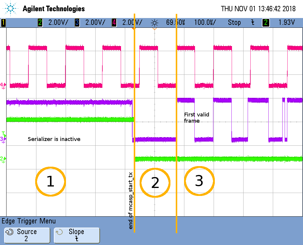

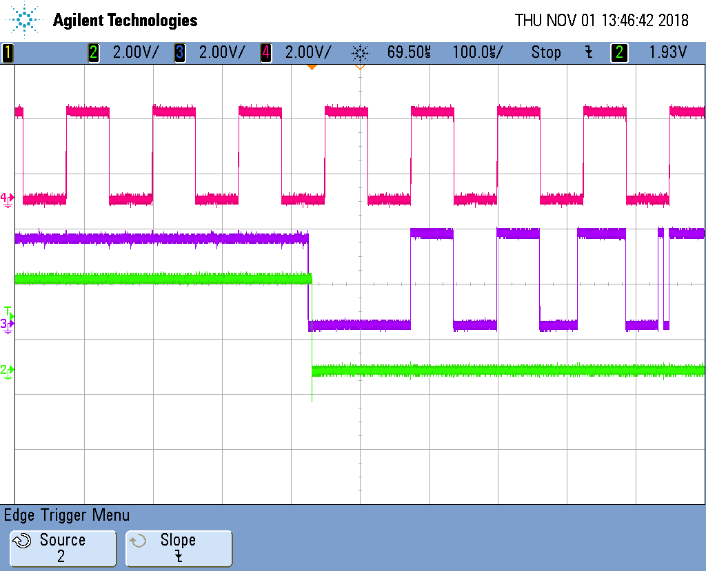

  • Can use devmem2 now, thanks.  Speeds things up.
    If I make the serialiser inactive (devmem2 0x4803818c w 0xC) then the pin changes from 0V to 3.3V which is good.  However, the original issue remains.
    Please refer to the following scope captures.  Pink is frame sync. purple is axr3.
    On the left of the screen, the axr3 pin is high.  This is because I have executed the following commands:
    devmem2 0x44E00034 w 0x2
    and the serializer is inactive.  The axr3 pin goes low when I aplay.  It stays low for approx 52ms.  This is not audio data.  The axr3 pin then becomes active after that 52ms.  Here is a close up of what's happening at the transition.
    The format is not quite I2S (there is no delay), but the axr3 pin should be transmitting when framesync is low.  To achieve this I'm using inverted framesync and time slot 0 (least amount of driver changes).  You can see axr3 goes high again in the 4th grid.  In this capture it's doing this in an inactive slot, but sometimes it happens in an active slot.  Either way the transition from FF to 00 creates a tick as does the transition from 00 to FF.  The real audio data begins in the 5th slot.  The data in the capture is 0xFF, 0x80, 0xFF, 0x00, 0xFF, 0x80, 0xFF, 0x00, 0xFF, 0x80.  The first byte of data in my file is 0xFF (ie. zero in ulaw).
    I don't yet understand what's going on in that 52ms.  Do you have any insights?
    Maybe I misunderstand how it's supposed to work, but:
    DISMOD says "when in inactive TDM slot of transmit mode or when serializer is inactive".
    XSMRST says "serializer drives the AXRn pin to the state specified for inactive time slot".
    Nowhere does it say that the serializer must be inactive when the transmit state machine is in reset?
    Stef

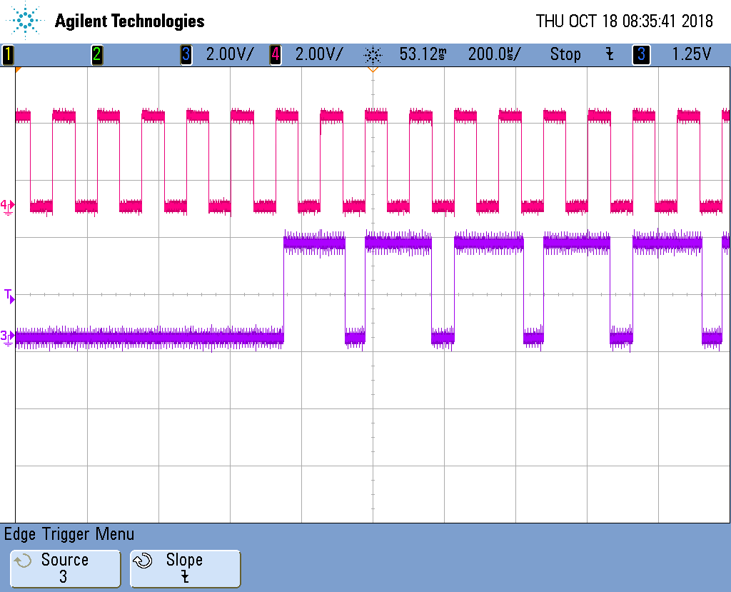

  • Hi Pavel,
    I have some new information.  I added some code to toggle a gpio during certain sections of code to zero in where axr3 was going unexpectedly low in post http://e2e.ti.com/support/processors/f/791/p/737730/2726383#2726383.
    This section of code is in davinci-mcasp.c in the function mcasp_common_hw_param():
    /* axr3 is high */
    	for (i = 0; i < mcasp->num_serializer; i++) {
    printk("[stef-] %s: (DISMOD tx_ser %d) 0x%08x\n", __func__, i,
    	mcasp_get_reg(mcasp, DAVINCI_MCASP_XRSRCTL_REG(i)));
    		mcasp_set_bits(mcasp, DAVINCI_MCASP_XRSRCTL_REG(i),
    			       mcasp->serial_dir[i]);
    		if (mcasp->serial_dir[i] == TX_MODE &&
    					tx_ser < max_active_serializers) {
    			mcasp_set_bits(mcasp, DAVINCI_MCASP_PDIR_REG, AXR(i));
    			mcasp_mod_bits(mcasp, DAVINCI_MCASP_XRSRCTL_REG(i),
    				       DISMOD_HIGH, DISMOD_MASK);
    /************** axr3 goes low here. *****************/
    			tx_ser++;
    		} else if (mcasp->serial_dir[i] == RX_MODE &&
    					rx_ser < max_active_serializers) {
    			mcasp_clr_bits(mcasp, DAVINCI_MCASP_PDIR_REG, AXR(i));
    			rx_ser++;
    		} else {

  • I ran another test.  I moved the DISMOD enable to after the transmitter is out of reset.  Per this snippet in mcasp_start_tx():
    	/* Release TX state machine */
    	mcasp_set_ctl_reg(mcasp, DAVINCI_MCASP_GBLCTLX_REG, TXSMRST);
    	/* Release Frame Sync generator */
    	mcasp_set_ctl_reg(mcasp, DAVINCI_MCASP_GBLCTLX_REG, TXFSRST);
    	/* enable transmit IRQs */
    	mcasp_set_bits(mcasp, DAVINCI_MCASP_EVTCTLX_REG,
    		       mcasp->irq_request[SNDRV_PCM_STREAM_PLAYBACK]);
    	/* enable tx serializers */
    		if (mcasp->serial_dir[i] == TX_MODE) {
    	/* Activate serializer(s) */
    	mcasp_set_ctl_reg(mcasp, DAVINCI_MCASP_GBLCTLX_REG, TXSERCLR);
    And the result:
    Pink is frame sync.  Green is a gpio that goes low just before davinci_mcasp_start() returns.  The purple trace is axr3.
    Note that DISMOD is working well up until the serializers are enabled in grid 5.  The first valid data doesn't come out until grid 7.
    Stef

    I'm not sure we're on the same page here (plus this forum layout is absolutely stupid).  Here's a picture I posted before with some markup so we can be sure we're talking about the same things.
    Two posts up I mentioned 3 conditions.  They are labelled on the above image.  The line marked end of mcasp_start_tx actually marks the end of davinci_mcasp_start().  Here is the code that belongs to the above image:

    - "DISMOD breaks when serializer is in transmit mode prior to data shifting out onto the bus." - does this happen during inactive time slot? Can you provide more details for that case? If you have JTAG, you might put breakpoint and explore the McASP module registers.
    Once it starts working again it works fine.  No JTAG header on this board.  Have another look at the scope capture 2 posts back.  Err wait a sec.  It seems to have disappeared?  I'll attach it again, but you may want to go back and read 2 post back where I describe this scope capture in relation to the code snippets.
    Have a look at the area marked first valid frame and you can see that DISMOD is working properly for each valid data sample.  What you see after the second orange line are two timeslots.  Timeslot 0 is unused and timeslot 1 is active.  However, there's a bit of trickery here.  The linux driver doesn't allow you to pick which timeslot you want to use.  I can't change how the codec works and it wants to exchange data when framesync is low; in timeslot 1.  To avoid having to make a bunch of patches to have the serializer transmit in timeslot 1 instead of timeslot 0, I've told the mcasp to use an inverted frame sync.  So the mcasp thinks it's transmitting in timeslot 0 when framesync is low, but this is actually timeslot 1 on the bus.
    From the mcasp perspective, the start of valid data actually happens on the falling edge of framesync before the second orange line that marks the first valid frame.  But region #2 appears to be some kind of no man's land where the serializer is behaving is an unexpected manner.  Due to the inverted frame sync, the serializer could have written zero to the bus in the "timeslot 0" (wrt to the serializer) which occurs on the left side of the second orange line.  However, if the serializer did write zero, that zero did not come from the dma.    I've put prints in the dma handler and I know my data buffer begins with 0x00, 0x01, 0x02.
    In region 3 I can see my data come out: 0x00, 0x01, 0x02 in timeslot 1.  Meanwhile the serializer is behaving properly during timeslot 0 (timeslot 1 wrt to the serializer).
    -Stef

  • Hi Stefano,
    I was able to reproduce the issue with the following setup:
    BeagleBone White + audio cape (aic3106 codec).
    I have the following series: http://mailman.alsa-project.org/pipermail/alsa-devel/2018-November/141935.html
    I configured the AXR3 (tx serializer) in DT to pull up.
    Due to the codec on the cape, my setup for 8bit audio is to have 4 TDM slots, DISMOD is set to high.
    Codec as clock master:
    Codec as clock slave:
    The gpio3_19 is going low just before the PDIR for the AXR3 is set to output. In both capture we can see that as soon as we set PDIR to 1 (output) the line immediately pulled down for some reason.
    In my experimentation however I have seen other pattern as well: if I set the PDIR to 1, but the bitclk is _not_ running the AXR3 stays high till the point when the bclk starts to run.
    The command I use for playback:
    aplay -Dplughw:0,0 -c1 -r44100 -fS8-v /dev/zero
    From the first FS after the serializer is enabled the AXR3 pin looks OK: 8bit 0, 3x8bit 1 (DISMOD is high) as I only have timeslot 0 as active, the rest is inactive.
    When the codec is generating the clocks we have bclk and FS already on the bus when the McASP is enabled so the codec will interpret at least one sample with 'garbage'.
    When the codec is slave the misbehaving AXR3 is not an issue as the codec will only going to look at the AXR3 line after the first FS and from that point the line behaves correctly.
    After this experiment my conclusion is that DISMOD (high) is not behaving how it should based on the documentation and DISMOD_HIGH in codec master mode will generate at least one corrupted sample for the codec. The codec slave mode on the other hand can be safely used with DISMOD_HIGH.

    There will be always a race if you try to manage the pull, imho
    It is one thing that the shift registers are loaded with data via the DMA (or the FIFO is filled). The most critical one is that for some unknown reason McASP will not honor the DISMOD _before_ the first start condition and it is pulling down the AXR line.
    So it does not matter (imo) when you will release the hard pull it is most likely not going to align with the last bclk of a previous time slot which should not contain any invalid 0 because of McASP pulling the line down.
    Kind regards,
    Peter
  • Hi Peter,
    Peter Ujfalusi said:
    You can configure McASP as BCLK slave and FS master by configuring the dai link to SND_SOC_DAIFMT_CBM_CFS. In this case your codec must not generate FS on the bus, but it is required to run the bitclock.
    This won't work.  The codec needs to see it's own frame sync for internal synchronization.
    From what I've seen on the scope there is a point in time where AXR goes low when it should be staying high.  I can't recall if that's when PDIR is set or at some other line of code.  With the code modification I made to enable the AXR after that McASP has been started, this always occurs in the frame preceeding start of data.  So I think, all I  need is a little bit of hardware to start pulling up hard on AXR3 before DISMOD has a chance to pull the line low, and then release it on the rising edge of the next frame sync.
    So this piece of hardware would:
    1. arm via gpio (ie. pull up)
    2. disarm via rising edge of frame sync (ie. tristate)
    Do you see any issues with this approach?
    Stef

  • Hi Stefano,
    Yes, the first byte is correct, tested with 0xaa and 0x55 as well.
    I think I have found some pattern in how the AXR3 line is behaving, but I need to investigate it more
    In the scope pic: aic3106 is master, I'm using i2s mode, 16bits, stereo, DISMOD is 3 and playing raw 0xaa:
    gpio1_17 is high while the PDIR is changed for the AXR3, gpio3_19 is high during the time the TX state machine is released and the Frame sync generator is released.
    As you can see the AXR3 line goes low when AXR3 is set to output, then it goes up after the McASP is released. The data (0xaa) will be on the bus on the first left (fs low) channel after the McASP is released.
    However, if in the same setup I play 0x55 then the AXR3 line would _not_ go high after the McASP is released. It looks to me that McASP will pull the AXR3 line to the level of the first bit in the data before the first start condition. In case of 0xaa it is high, in case of 0x55 it is low.
    As for the MU_LAW: it is in the sound/core/pcm_misc.c, the 0x7f  value predates the Linux move to git. A_LAW silence is 0x55.
    Kind regards,
    Peter

  • Hi Stefano,
    I'm really interested to hear more about the circuit and how it performs!
    I have the following captures: aic3106 is master, i2s mode, 16bits, stereo, DISMOD is 3, gpio1_17 is high while the PDIR is changed for the AXR3, gpio3_19 is high during the time the TX state machine is released and the Frame sync generator is released.
    Playing raw 0xaa:
    Playing raw 0x55:
    AXR3 drops to low right after the pin is configured to output in both cases, but when the MSB bit is 1 it is going to be driven high after the frame sync generator/tx state machine is released.
    I think after the McASP is released the MSB bit of the first sample is pulling the line to either direction, depending if it is 0 or 1. Bit it does pull down the line between PDIR and McASP release by itself which I can not explain or understand.
    This issue also affects non MU law use cases when the codec is master as if the first sample's MSB is 1 then the line will be kept high until the first start condition appears on the FS line.
    Kind regards,
    Peter
