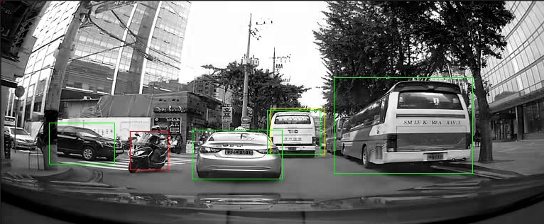

Hi All,
I have already confirmed that it works well on TDA2p EVM  as below when running tidl usecase using the already converted model bin(NET_OD/PRM_OD)
   -. bbox : ok,   display fps : ok(16fps)
However, I confirmed that the bin(NET_OD, PRM_OD) changed through tild_model_import.out does not work as it did before.
  -. bbox: no, display fps : fail(8.4fps)
Below is the problem log and import file file. Can you help me with what is wrong?
 modelImportIssue.zip
My development environment is as follows.
   VSDK :  3.3.0.0
   TIDLSRC:  1.1.1.0
   bootmode ; SDBOOT
   EVM: tda2p
   protobuf ver : 3.2.0rc2
   model: JDetNet
Thank you in advance.
 BR,
 Khethan

  • Hi Praveen,
    I've  just checked with the new version(1.1.2.0) you mentioned, but I still have problems.
    please refer my log file.

    I have tested on TDA2P EVM, but the output data is initialized as below attachment files.
    evm_output.zip
    This phenomenon seems to be the same in PC simulation mode.
    As mentioned earlier, if I use eve_test_dl_algo.out.exe, which is included in the package by default, the output is very good.

  • Hi Praveen,
    I tried to compile eve and dsp again with TIDL_SRC(1.1.2), and confirmed that the generated file (dsp_test_dl_algo.out, eve_test_dl_algo.out) works fine on EVM through CCS as output file(stats_tool_out.bin).
    However, when I execute the same model file with "tidl od usecase" in EVM(sd_boot), the video is played but the bbox is not displayed.
    please refer my data.

    But there was another problem.
    1. When tidl usecase is executed, bbox is not displayed from the beginning and box is displayed from about 20sec of video.
    2. When video(inData and inHeader) are replaced with mine, frame is played at 1 ~ 2fps slowly, resulting in frame reversal. the Problem is not reproduced when using ti demo clip.
        I made this clip using the program(ffmpeg&ffprobe&sizeBin) and It seem like to have no problem.
