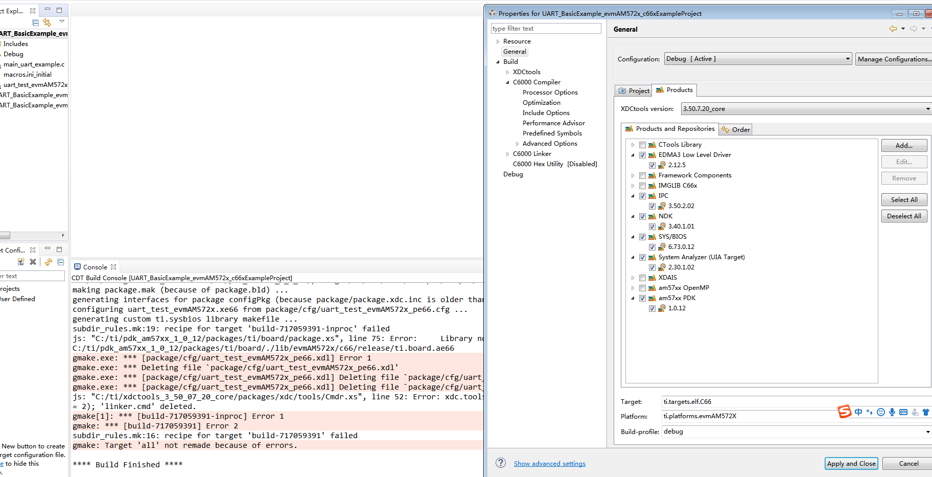

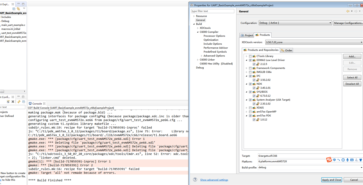

1.my board is am5728.CCS is CCS8 with processor_sdk_rtos_am57xx_5_01_00_11
2.I create the project by "pdkprojectcreat.bat"  like "UART_BasicExample_evmAM572x_c66xExampleProject"
3.when iI build the project,I get error
4.I try to change the XDCtool 3.32 (I have 3.50 and 3.32),but I still get the same error.
5.what should i do?
    You mentioned that you are using processor_sdk_rtos_am57xx_5_01_00_11. It looks to me you messed up 5.01.00.11 and 5.01.00.12 under the same directory. The RTSC you showed SYSBIOS 6.73.0.12 is for 5.1.00.12 and your build log also showed UART library is not found for 5.1.0.12.
    Please use the same PDK (either 5.1.0.11 or 5.1.0.12) to create the project and build.

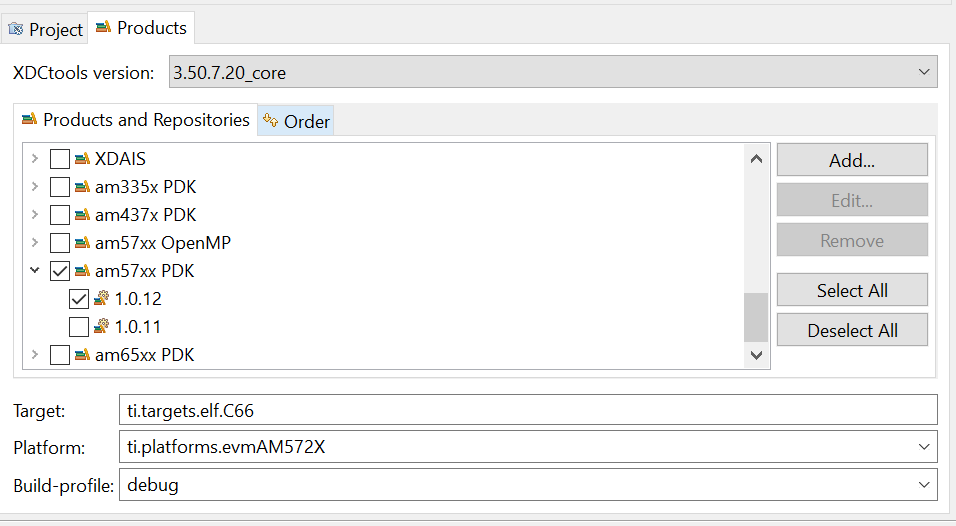

    It looks that you are using the latest Processor SDK RTOS 5.1 release for AM57x, with processor_sdk_rtos_am57xx_5_01_00_11 and pdk_am57xx_1_0_12. I mis-understood that, sorry.
    I tested by using:
    c:\ti\pdk_am57xx_1_0_12\packages>pdkProjectCreate.bat AM572x evmAM572x little uart all dsp
    Then import the  UART_BasicExample_evmAM572x_c66xExampleProject into CCS 8.1 and build, I didn't see any error:

    You log showed that the lib is not there: please double check the file is indeed in that folder (not accidentally deleted), and PDK 1.0.12 is properly detected and registered under CCS:

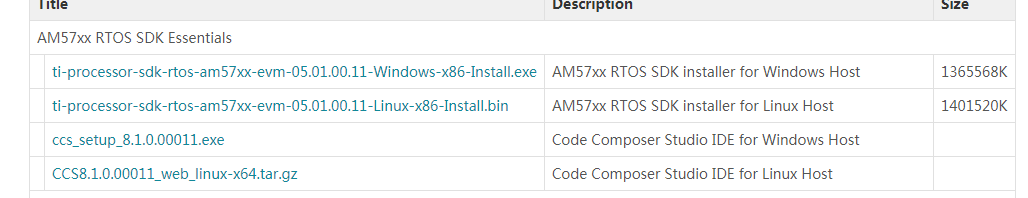

    1.I follew the new to install CCS8.1 and SDK0501  in Default Path(C:\ti )

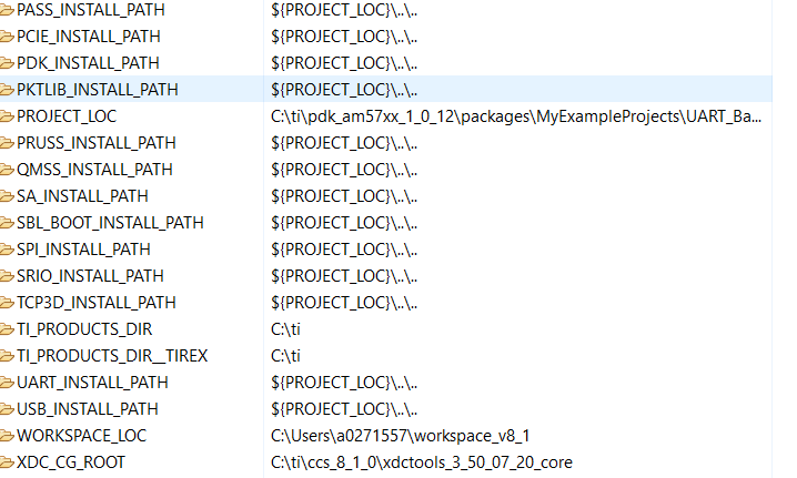

    the example have not the right link,so I add PDK_INSTALL_PATH
    Now the example is no error

    My pdk_am57xx_1_0_12 is installed under c:\ti and the CCS 8.1 is installed in C:\ti\ccs_8_1_0. The first thing is you need to launch CCS 8.1 to detect and register PDK 1.0.12.
    Then in pdkprojectcreat.bat I changed below to match my CCS location:
    if not defined CCS_INSTALL_PATH (
       set CCS_INSTALL_PATH=C:/ti/ccs_8_1_0/ccsv8
    I didn't see any problem to create/import/build the project. I didn't explicitly setup PDK_INSTALL_PATH.
