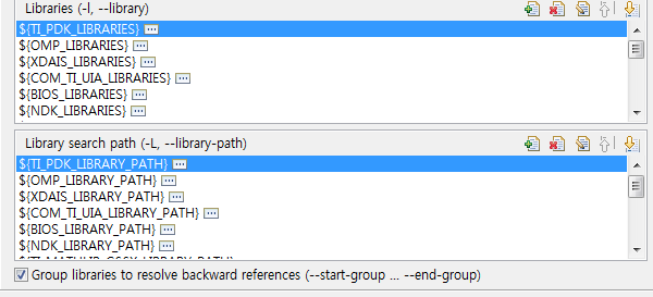

  • Hello SI,
    Their cfg file looks OK. Can you provide full build logs for us to look at?
    Also, please make sure they have "Group libraries to resolve backward references" checked in Project Properties > GNU Linker > Libraries.
  • Hi Sahin,
    Their SW are RTOS PSDK 5.0 and CCSv8.
    They checked "Group libraries to resolve backward references" as below.
    And their full log is attached in below.

  • Sahin,
    Here is more information.
    my customer found there was no error occurred when below codes were removed.
    In CpswEmacInit(),
    EMAC_HwAttrs_V4 cfg;
    EMAC_socGetInitCfg(0, &cfg);
    cfg.port[0].phy_addr = 0;
    cfg.port[1].phy_addr = 1;
    EMAC_socSetInitCfg(0, &cfg);
    NIMUDeviceTable[nimu_device_index++].init = &CpswEmacInit;
    #if 0
    #ifdef NIMU_DUAL_MAC_MODE
    #endif
    NIMUDeviceTable[nimu_device_index].init = NULL;
    #endif
    Thanks and Best Regards,
    SI.
