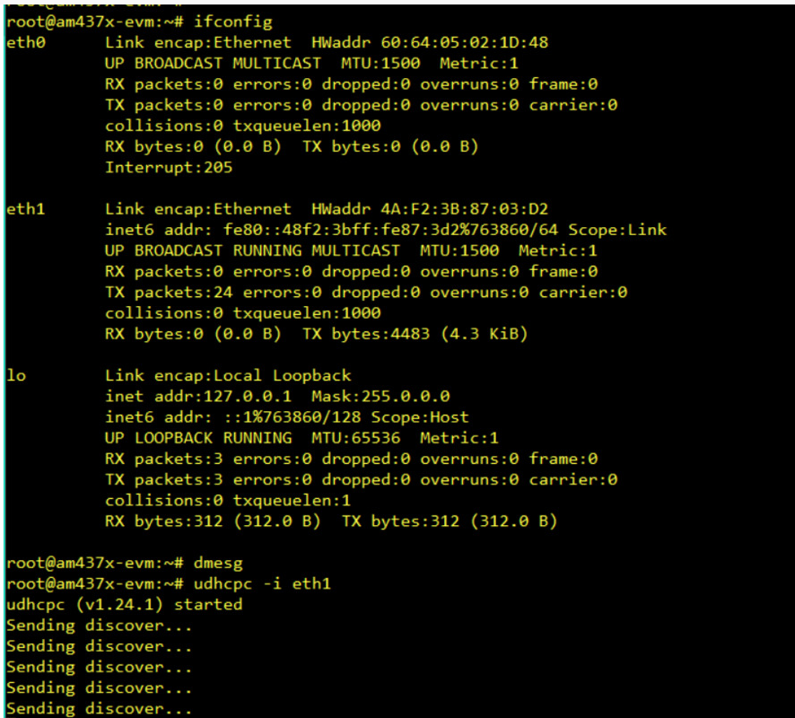

After do that, The eth1 is up,but can not get the ip.
the hardware is ok,because I use the kernel on sdk03.01,it can get the ip.

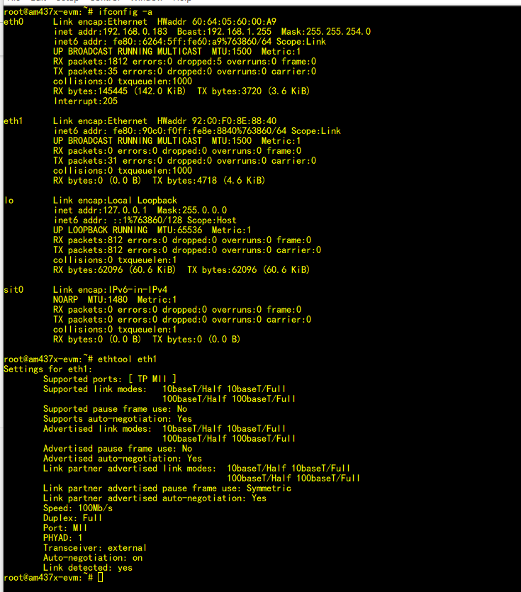

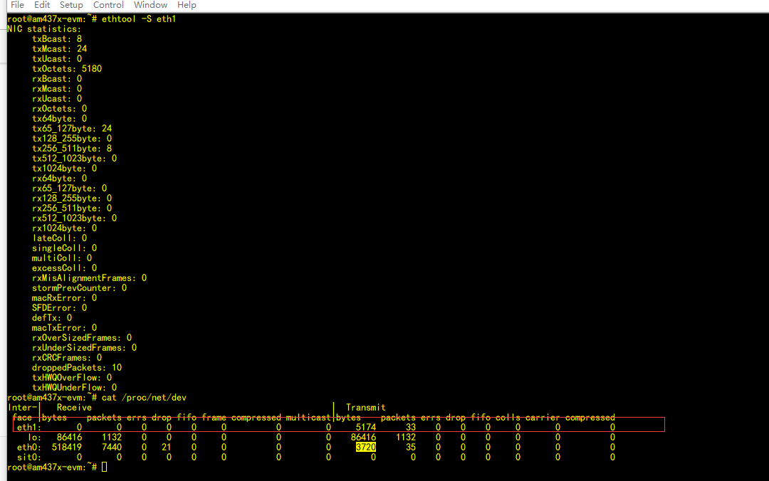

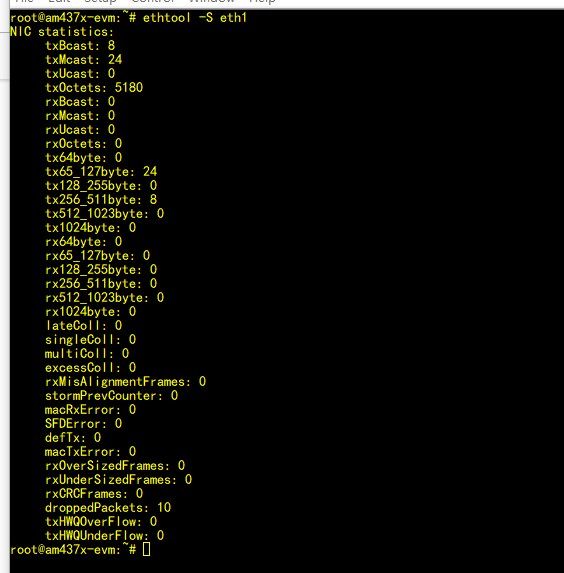

    There are a few things needed. Could you please supply the following results of these commands:
    ifconfig -a
    ethtool eth1
    ethanol -S eth1

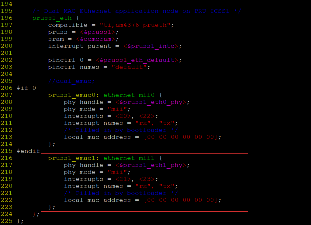

    Could you also supply the portions of the DTS file used to describe the RGMII port and the PRU port?
    Could you also describe how you plan to use the two ports?
    Could you also describe the topology of both the ports used and how the connect with each link partner? Are both ports on separate subnets?

    here the test resluts:
    1)
    It seems that the eth1 can not recive anything.
    2) dts configuration

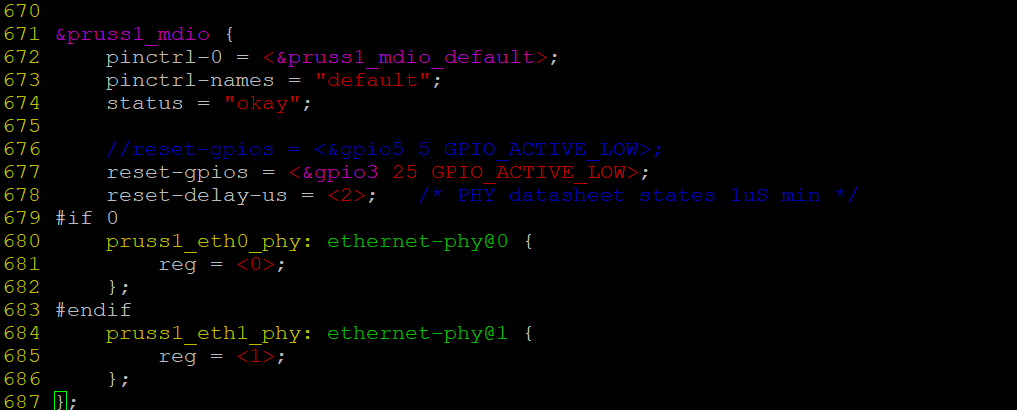

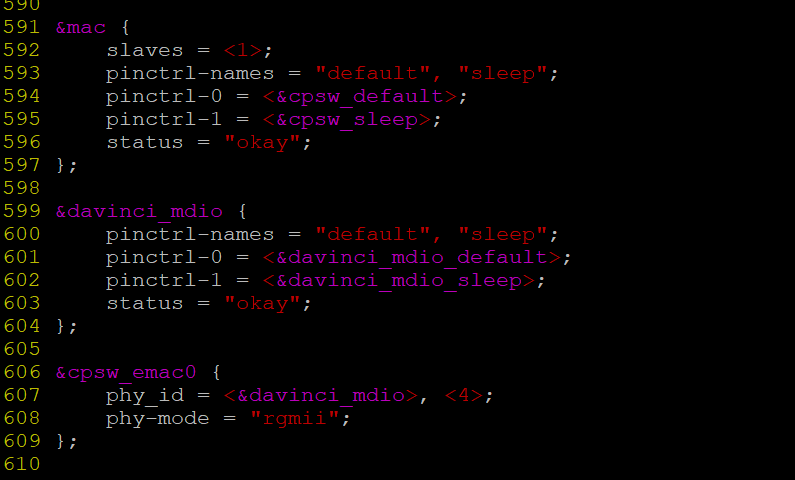

    rgmii:
    pruss eth:

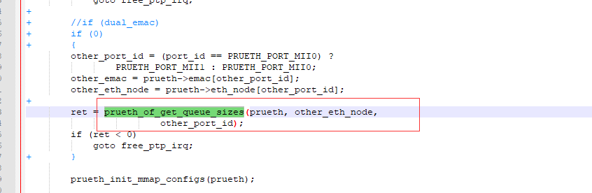

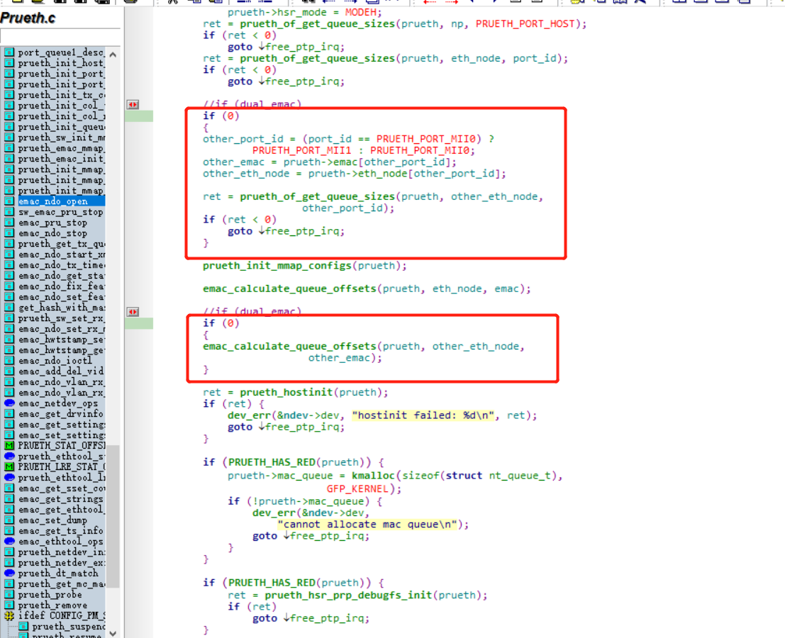

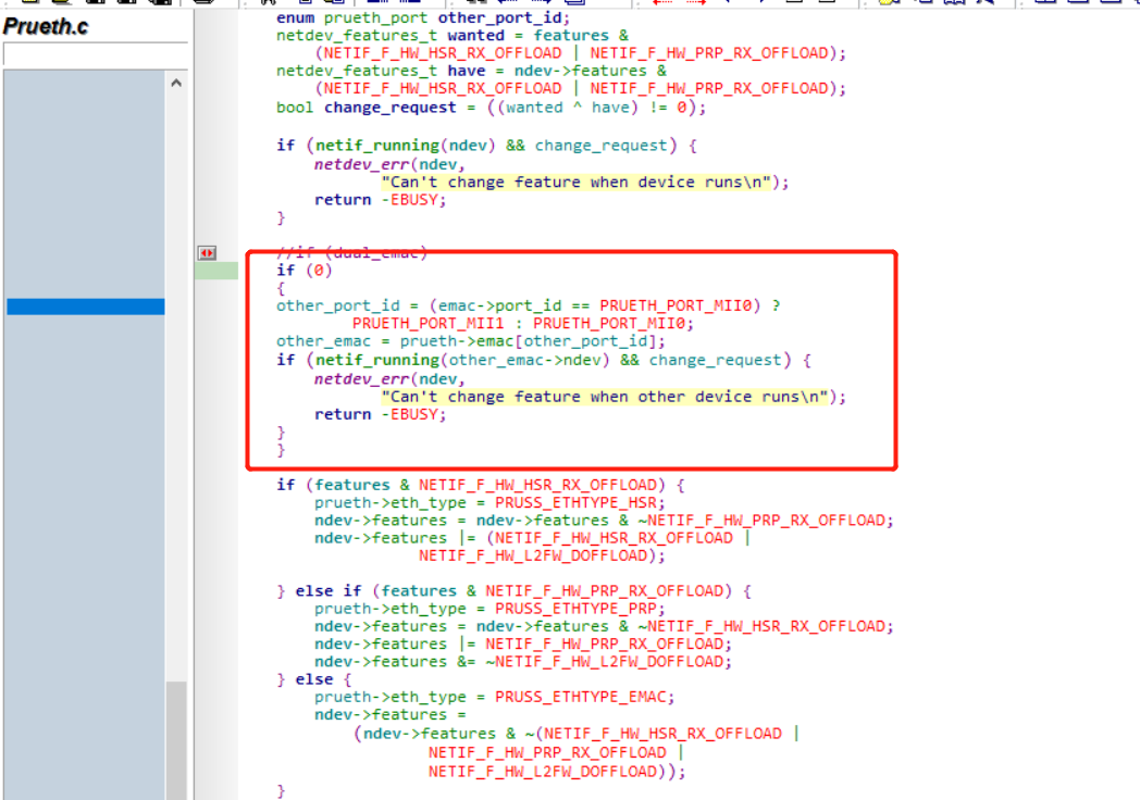

    3) modify on prueth.c like that
    https://e2e.ti.com/cfs-file/__key/communityserver-discussions-components-files/791/0005_2D00_must_2D00_reset.7z
    I found that commented the below code, the eth1 will not get the ip.
    4) I hope the rgmii and pru eth can get ip,but the pru eth can not get ip now.
    5) the prueth,c driver not work fine if there is only one pru eth on the board,so I want to modify the prueth,c,supprting one pru ethernet port.
    I had solved the problem.
    Here are the modify.

    diff --git a/Documentation/devicetree/bindings/net/ti-prueth.txt b/Documentation/devicetree/bindings/net/ti-prueth.txt
    index 7a4e637..f32b7fe 100644
    --- a/Documentation/devicetree/bindings/net/ti-prueth.txt
    +++ b/Documentation/devicetree/bindings/net/ti-prueth.txt
    @@ -11,6 +11,7 @@ Required properties:
     - pruss            : Must point to a pruss device node
     - sram	           : pHandle to OCMC SRAM node
     - interrupt-parent : pHandle to the PRUSS INTC node
    +- dual_emac        : Must add it if we use two emac on one pruss
     Must contain children, one for each of the MAC ports.
     Required properties for children:
    @@ -34,6 +35,8 @@ Example (am572x-idk board):
     		sram = <&ocmcram1>;
     		interrupt-parent = <&pruss2_intc>;
    +               dual_emac;
     		pruss2_emac0: ethernet-mii0 {
     			phy-handle = <&pruss2_eth0_phy>;
     			phy-mode = "mii";

     		return -EBUSY;
    -	other_port_id = (emac->port_id == PRUETH_PORT_MII0) ?
    -			PRUETH_PORT_MII1 : PRUETH_PORT_MII0;
    -	other_emac = prueth->emac[other_port_id];
    -	if (netif_running(other_emac->ndev) && change_request) {
    -		netdev_err(ndev,
    -			   "Can't change feature when other device runs\n");
    -		return -EBUSY;
    +	if (prueth->dual_emac) {
    +		other_port_id = (emac->port_id == PRUETH_PORT_MII0) ?
    +				PRUETH_PORT_MII1 : PRUETH_PORT_MII0;
    +		other_emac = prueth->emac[other_port_id];
    +		if (netif_running(other_emac->ndev) && change_request) {
    +			netdev_err(ndev,
    +				"Can't change feature when other device runs\n");
    +			return -EBUSY;
     	if (features & NETIF_F_HW_HSR_RX_OFFLOAD) {
