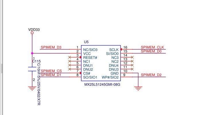

We have to disturb the SPI NOR clock((short the pin 15 and 16)) , and  let it can boot up from secode boot device eMMC(sdcard).

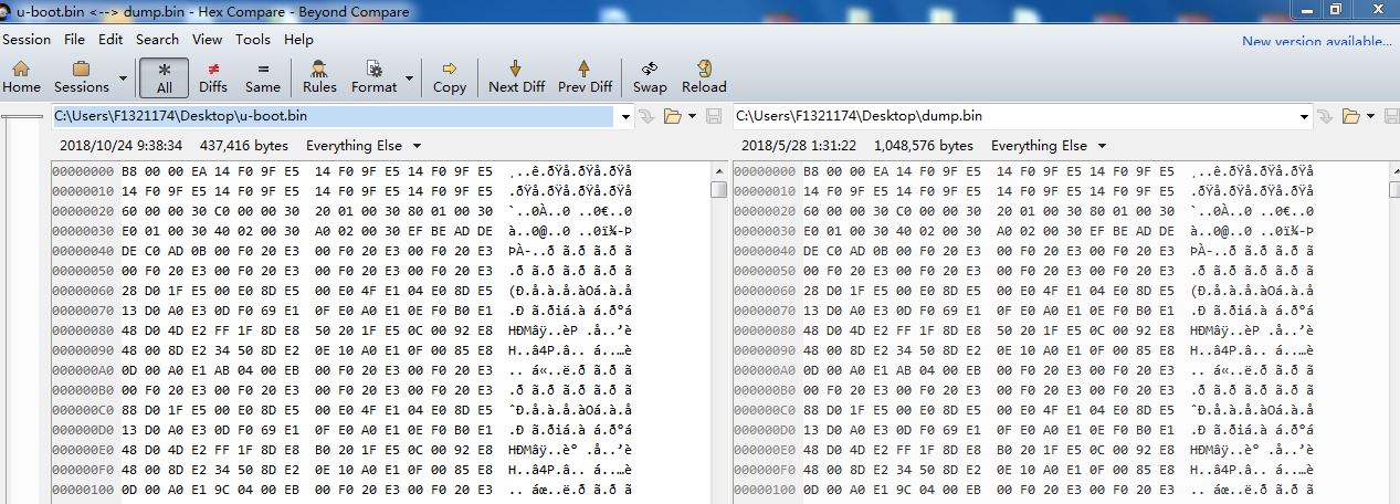

After boot up from the sdcard,  I use the dd command to dump the SPI NOR flash u-boot part,  and compare with the u-boot.bin which I compiled,  It is the same.

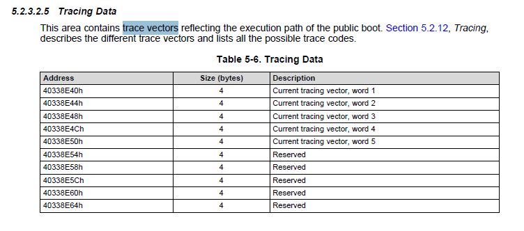

  • Please enable  u-boot debug logs.  This will provide more details and insight into the problem.
    An addition debug technical is to step thru the u-boot source code to localize where the problem occurs (CCS debug)
    Also take a memory dump, using CCS, of the ROM code trace vector values (see TRM for more details)

    Because we didn't reserved the debug port for connect to the CCS, Could we use the dev2mem to read the related registers from Sdcard booting up when the failure occured?
  • Correct enable #define DEBUG 1.
    You'll need to read the memory at the point when the boot failure occurs. Based on your problem statement, switching to SD boot results in a successful boot. Therefore, the previous boot vectors, when QSPI NOR boot was attempted, are overwritten with the SD boot vector statuses.
  • Yes, you are right, if boot from sdcard, we can not detect the correct info. It will be over right.

    I dump the uboot from the QSPI first 512 byte and compared with the original u-boot.bin compiled, It all the same.

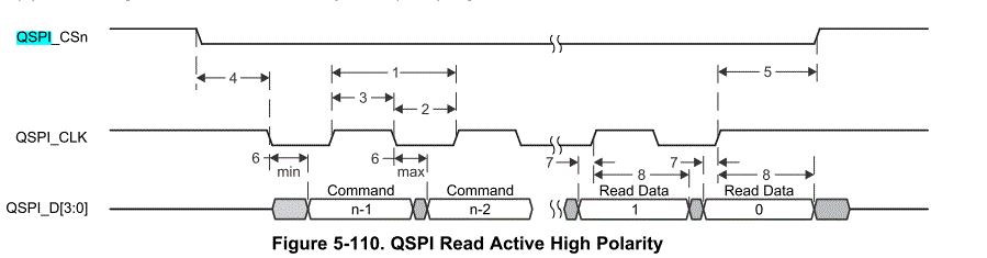

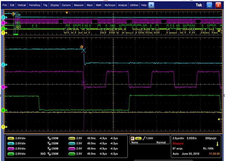

       there is another issue about the QSPI flash, the CS and clock pin is going down at the same time,  Acturally, its clock should be delay about 5ns for the CS pin.
     Please refer to the following picture to analyze the issue.
    The NO.4 shows that the td(CS-QSPI_CLK) should have 5ns delay, But the 3td picture shows that they are going down at the same time.Please give a suggestion about How to solve this?
    Does this will influence the power on/off test?
  • Rance, i think you have to zoom in much closer to see which signal falls first. Iit almost looks like the clock goes low first, which means technically that's not the first edge after CS active edge. I think the controller is setting up for active high polarity before the CS is active.
    At any rate, i don't think this is really affecting the on/off test. I'd be curious to see what the QSPI bus looks like when you fail to boot from QSPI.
    You should also check if you are violating the power up/down of the QSPI flash. There is a diagram in the QSPI flash datasheet that shows tPWD must be a minimum of 300us to ensure proper initialization will occur. Also, tVSL must be met to ensure you have waited long enough after power up for full device access.
