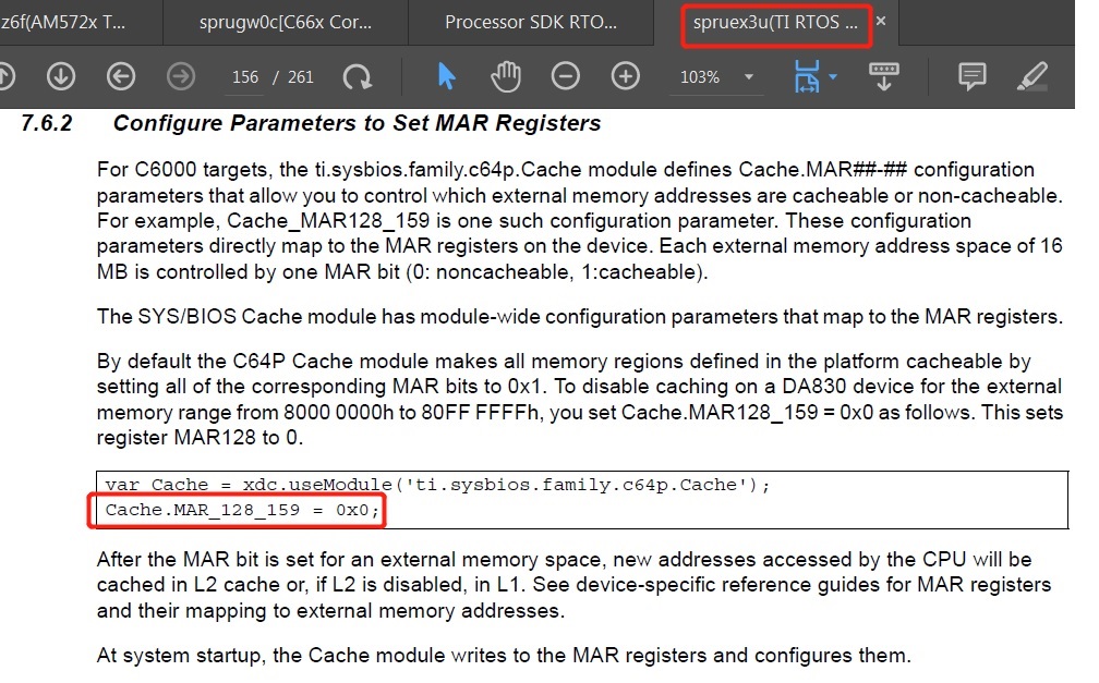

I want to user Cache on AM57xx DSP, According to SPRUEX3U TI-RTOS Kernel User's Guide 7.6.2 to set MAR.
get build error as below:

js: "C:/ti/pdk_am57xx_1_0_11/packages/ti/drv/gpio/test/led_blink/am572x/c66/bios/gpio_test_evmAM572x.cfg", line 51: XDC runtime error: ti.sysbios.family.c66.Cache: no element named 'MAR_128_159'

except manual configure Cache register, How to configure it in .cfg script?
Where can I find a updated/verified user guide?
