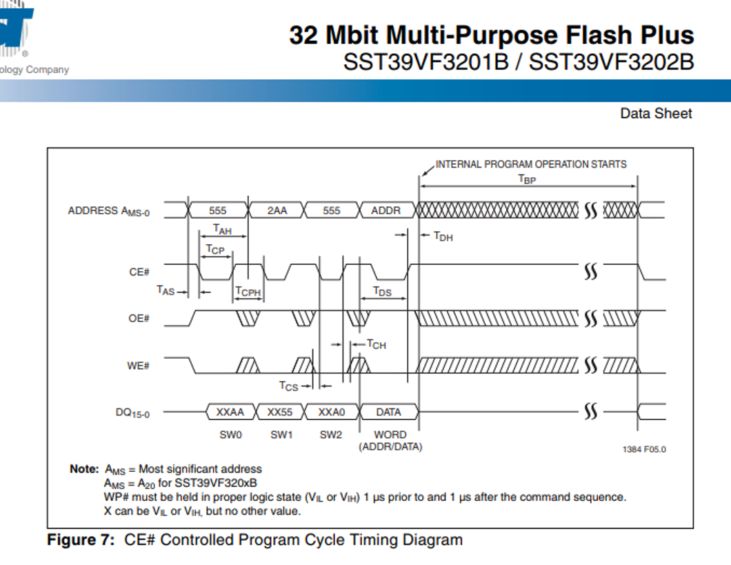

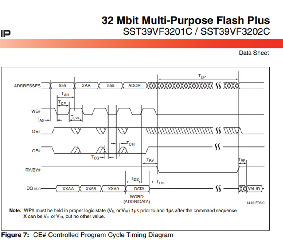

  • Hi There,
    I have attached both data sheets for the working and the non-working part.
    When Programming the device, the B variant (working) doesn't appear to care what is on the write enable line. The C variant appears to want this line held low.
    Could this be a reason why the B variant works and the C variant does not?
    Andrew
  • Andrew,
    This can potentially be an issue but we cannot confirm this. It would be ideally to check this with the NAND vendor to confirm that this can potentially cause an write failure as you are observing. Also, before getting the sfh writer over UART working, we would recommend that you use the CCS project based Nand writer that we provide in the package for easier debugging option and then port those changes to the sfh code base.
