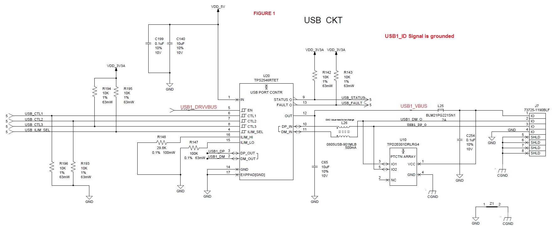

    Here i am attaching the portion of the schematic related to USB controller.

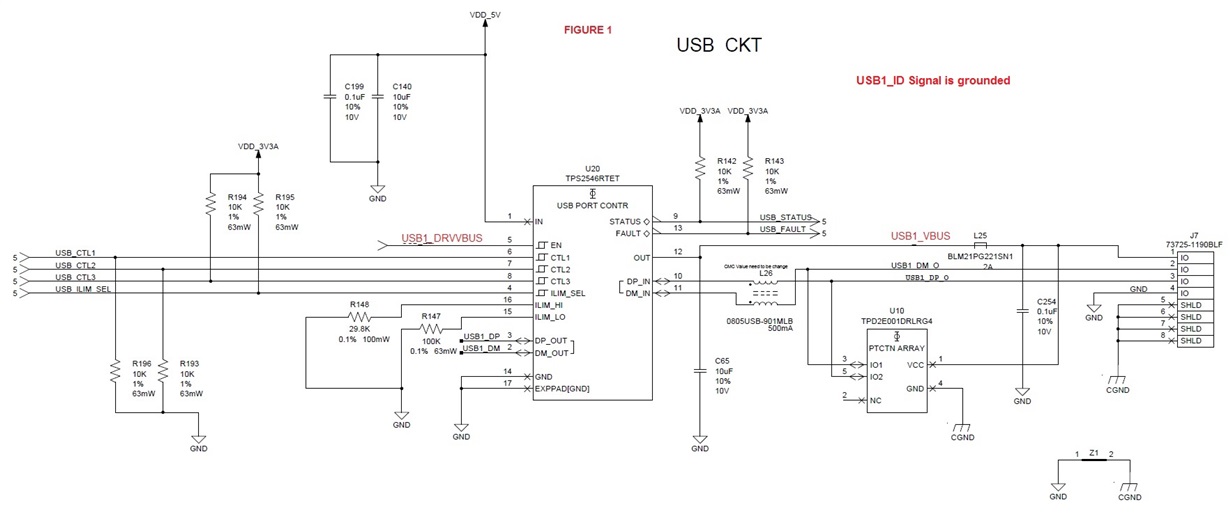

    Figure 1 is the initial configuration we used in the design : In this configuration we are not able to detect the thumb drive. Later we modified the schematic.

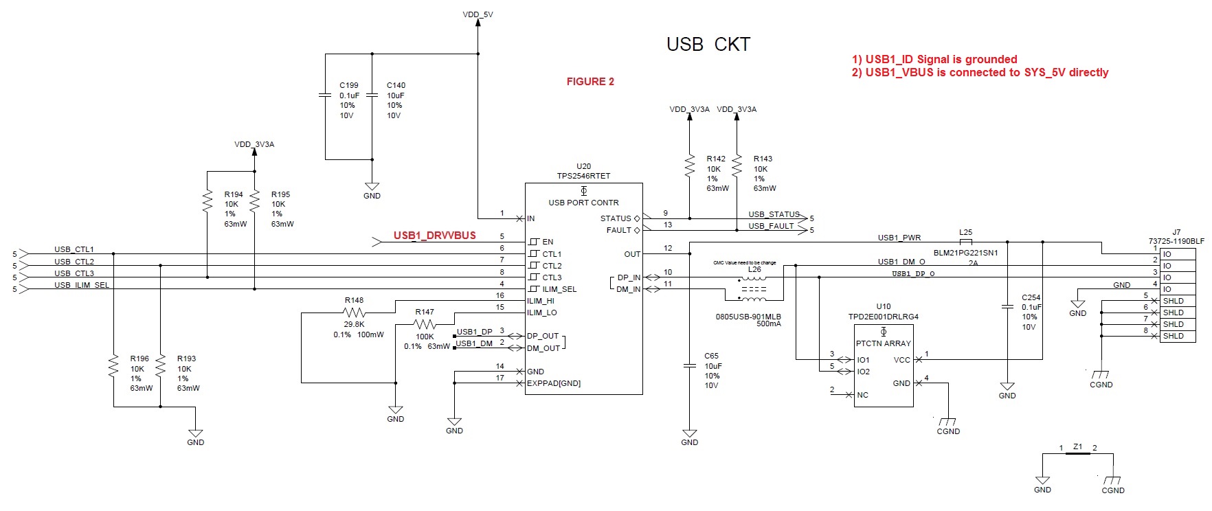

    Figure 2 is the modified schematic. After modification we are able to detect the thumb drive and we did few measurements to understand why circuit in the Figure 1 is not working.
    When we measured the output of the TPS2546 with respect to USB1_DRVVBS signal i.e enable signal of the TPS2546 we observed that 5V is appearing at the TPS2546 output (USB1_PWR)  after 200ms.
    But As per TPS2546 datasheet Propagation delay is 0.25ns (TYP).
    Can anybody tell me why my First circuit (Figure 1) is not working  correctly ? and also in the case of Modified circuit (Figure 2) from where  200 ms delay  i s getting added / introduced ?
    I don't see any difference between the two figures, other than the 2nd has a note saying USB1_VBUS is connected to SYS_5V directly. I can explain why the modified circuit works, but I don't know where the 200ms delay comes from, maybe the TSP2546 team has some idea.
    For the AM335x USB controller to work in host mode, after turning USB1_DRVVBUS pin high, USB1_VBUS pin should sense >4.4V within 100ms; otherwise, USB1_DRVVBUS will be turned low, and the USB controller will not transition to host mode. If there is 200ms delay on the output of TPS2546, the USB controller will not be able to detect any usb device on your first circuit.

  • I'm from the TPS2546 team.
    Can you please tell me the pin settings for CTL1, CTL2, CTL3, and ILIM?
    I also need to know what your target current output and any of the BC 1.2 or other power management modes you wish to suppor.
    This will help me support your questions.
    By default i am setting CTL1 = 0, CTL2 = 1, CTL3 = 1, ILIM = 0 and Target current is 1.5 A, any of the BC1.2
    Any update, what will be the issues with TPS2546?
  • The mode you have configured 0110 is DCP_AUTO mode for the TPS2546. This mode is utilized for a charge only mode when the host is in low power mode.
    If you intend the port to have active data, then I suggest you configure it as a SDP or CDP. 1110 or 1111 are good choices.
