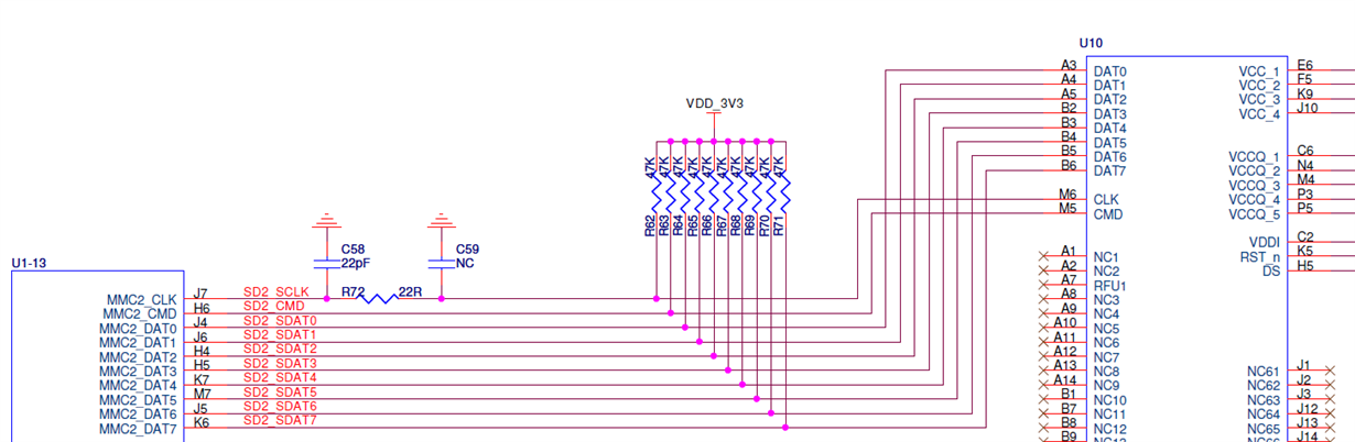

Hi, TI Team
We've produced 50 sets of AM5718AABCX.
We write eMMC(MMC2) using SD card(MMC1).
But eMMC did not respond to voltage select on some board.(failure: 13/50 pcs)
How to fix this problem?
Error:
__recalibrate_iodelay_start:4
IODELAY: Isolation of Device IOs failed
Whole log:
