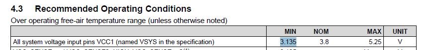

Our customer plan to use AM5728 for their product with PMIC(TPS659037).
And they sent us the question about PMIC.
They found the "VCC1 spec: 3.135V-5.25V" in the below PMIC-DataSheet: "4.3 Recommended Operating Conditions"
http://www.ti.com/lit/ds/symlink/tps659037.pdf
But the power supply range of their board is 2.97V-3.597V.
Question:
  Could you tell us the recommended way of power design for AM5728?
   - Are there any other PMIC for AM5728 which can meet the their power supply spec?
We would appreciate if you tell us recommended way with their board power supply(2.97V-3.597V).

    I support the TPS659037 device. From the PMIC side, we recommend not going below the 3.135V minimum input voltage specified in the datasheet. This number is determined by on one of the internal oscillators that may cause a reset if the input voltage goes lower than the specified minimum voltage.
    If the you go lower than 3.135V, then it is a datasheet violation, and we cannot guarantee performance across the many units that would be in production with a potentially lower VCC1.
    I recommend using a pre-regulator that has a tighter output voltage accuracy. This will also allow you to supply any 3.3V rails of the processor with accuracy.
