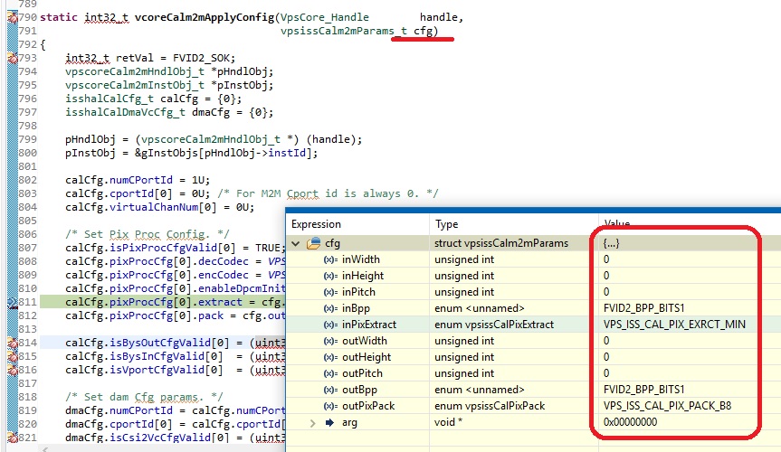

    But after the driver is created the problem is in vcoreCalm2mApplyConfig() in vpscore_calm2m.c. In the following line the pixel extract config is set to cfg.inPixExtract (also see attached image):
    calCfg.pixProcCfg[0].extract = cfg.inPixExtract;
    All other parameters from cfg are 0, so it seems this config isnt initialized. At least I couldn't find the init function. Do you know how to solve this?
    Thank you,
    Tobias
  • Hi Tobias,
    ok, so this is not in iss capture configrations. It seems you are trying to use new m2m path, which internally uses cal.
    we need to similarly configure cal even in m2m path. You could look into the example application in ti_components\drivers\pdk_01_10_01_06\packages\ti\drv\vps\examples\iss\m2mIssCal\src\ to understand how to configure it.  This example converts 12bit mipi to 12bit linear.
    Rgds,
    Brijesh
