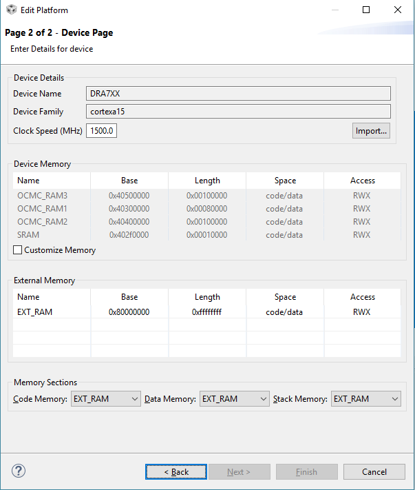

Hello, I've been trying to search the forums and guides on how to configure our project to utilize the 4GB of DDR on our board instead of the default 2GB. After trying to configure our project using the Software Guidelines for EMIF, the two forum posts below, and the EMIF_RegisterConfig tools, I'm still not sure I've gotten it setup correctly.

Then I modified the ti.platforms.evmAM572X configuration with the RTSC tools as shown in the screenshot. I've actually tried several different options in this editor, from 1 4GB section, or 2 2GB sections but neither seems to work. From looking at the TRM it looks like with the L3_MAIN Memory Map there is only 2GB available to EMIF1 and 2, but the MPU Memory Map it looks like you should be able to configure 4GB. I'm not sure how all that ties together with the EMIF tool and CCS configuration.

    Step4: Modify the platform memory map and/or linker command file to place code in that range. From software perspective it doesn`t matter that the the DDR is connected to EMIF1 and EMIF2 since it only relies on the address location to place/execute code. Steps you described to modify the platform are correct. you can also do the same by introducing a linker command file to place code in that area.

    These are all physical addresses. As you correctly pointed out, the virtual address space of the cortex-a15 is only 32-bit, so accessing addresses above 0xFFFF'FFFF requires setting up the mmu to perform suitable address mapping. As for the physical browser, CCS has no way of actually performing an access to a physical address. Apparently the physical memory view works by setting up MMU translation on the fly, but it needs to know a suitable physical address to place the translation table. See link for details.
