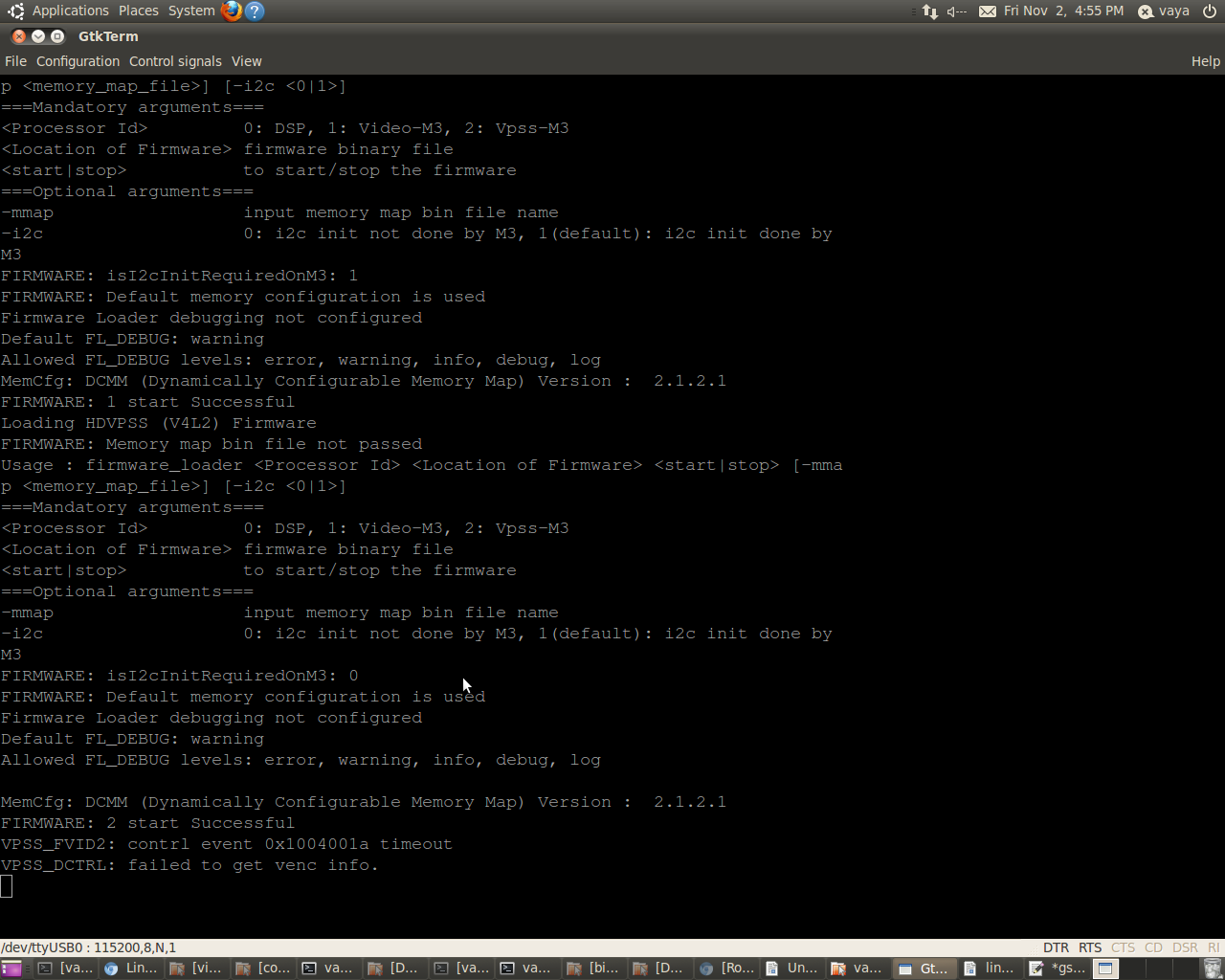

 Can some one  please help me , as I am using prebuild EZSDK-DM814x-EVM image (version : 5_05_02_00) on the DM8148-EVM and i am using LCD for display & USB camera for capture. I can play the demo videos through the demo applications but when i try to open the capture demo encode application, i got blank screen and i got the following error in gtkterm.
VPSS_GRPX : please open fb1 node first.

i have attached the screenshot for the error.

    --- Here my lcd is displayed into two partions
    and error capture is attached

    "Querying DV Preset failed."
    Setting/querying of DV preset fails means its not able to detect the input source.
    Capture source must be connected to the component input of IO EXPANSION board before run the sample application, otherwise the sample application reports error as in your case.
    Please refer this thread about USB capture.
    e2e.ti.com/.../894158
