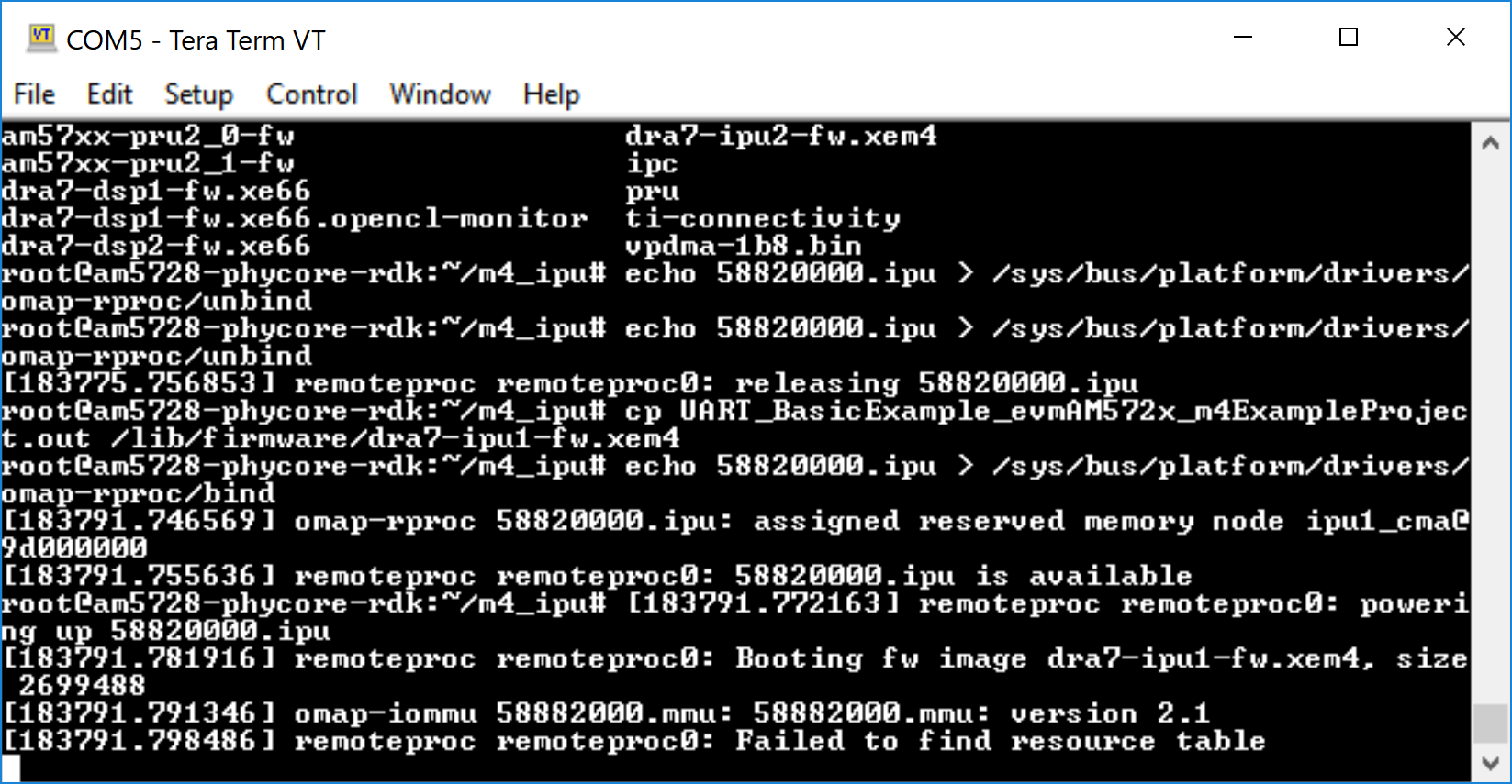

    Thanks a lot for the information. I have a project building, and an XDS110 on the way for programming.
    However, in the interim, is there any modifications I need to make to the .out file in order to load the firmware into /lib/firmware/dra7-ipu1-fw.xem4 ?
    I know you can start/ stop the firmware by calling the IPU number (58820000.ipu) into /sys/bus/platform/drivers/omap-rproc/<bind or unbind>.
  • Hi Lucas,
    The binary generated from above UART IPC example can be directly copied to dra7-ipu1-fw.xem4 without modification.
    Garrett
  • Garrett,
    I get the following error when loading the .out file into the firmware location, am I missing a step somewhere?
  • Hello Lucas,
    When loading an image onto a slave core with the ARM running Linux, a resource table is needed so that remoteproc knows how to allocate system resources and configure the MMU.
    Please refer to the following documents for more information on adding a resource table to your project:
    Hope this helps.

  • Hello Lucas,
    It looks like you are using the wrong version of XDCtools. You will want to use the version that came bundled with the SDK, which for PRSDK v5.1 is v3.50.7.20. You can change the version by going to your project's properties > CCS General > Products.
  • Hello Sahin,
    Good call on the XDC tools. It looks like the output is very close now. After unbinding the booted firmware in ipu1, and copying over the .out file (instead of linking), and then attempting to rebind, I get the following:
    echo 58820000.ipu > /sys/bus/platform/drivers/omap-rproc/bind
    [ 183.598856] omap-rproc 58820000.ipu: assigned reserved memory node ipu1_cma@9d000000
    [ 183.612887] remoteproc remoteproc0: 58820000.ipu is available
    [ 183.624467] remoteproc remoteproc0: powering up 58820000.ipu
    root@am5728-phycore-rdk:~/m4_ipu# [ 183.632915] remoteproc remoteproc0: Booting fw image dra7-ipu1-fw.xem4, size 4611936
    [ 183.644974] omap-iommu 58882000.mmu: 58882000.mmu: version 2.1
    [ 183.655302] omap-rproc 58820000.ipu: failed to allocate dma memory: len 0x3000000
    [ 183.662890] remoteproc remoteproc0: Failed to process resources: -12
    Any thoughts into where this issue may lie?
  • I was able to fix this bit, via changing the rsc_table_vayu_ipu.c IPU_MEM_DATA_SIZE  (for IPU2?) to 16 MB from 48. It appears as though  the BSP I was using defined a limit of 32 MB, so by changing it to 16 MB I did not overflow that space.
