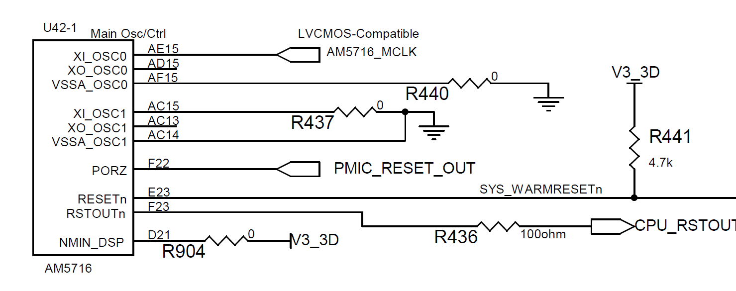

I'm developing a board with Sitara AM5716.
I give to the SItara a 20MHz clock from an external oscillator which has a 3.3V LVCMOS output. The oscillator is connected to the XI_OSC0 pin (AE15) (see picture below) and it is working before the PMIC exits from the reset.
Is there any problem if Sitara has the clock signal before powering up?
