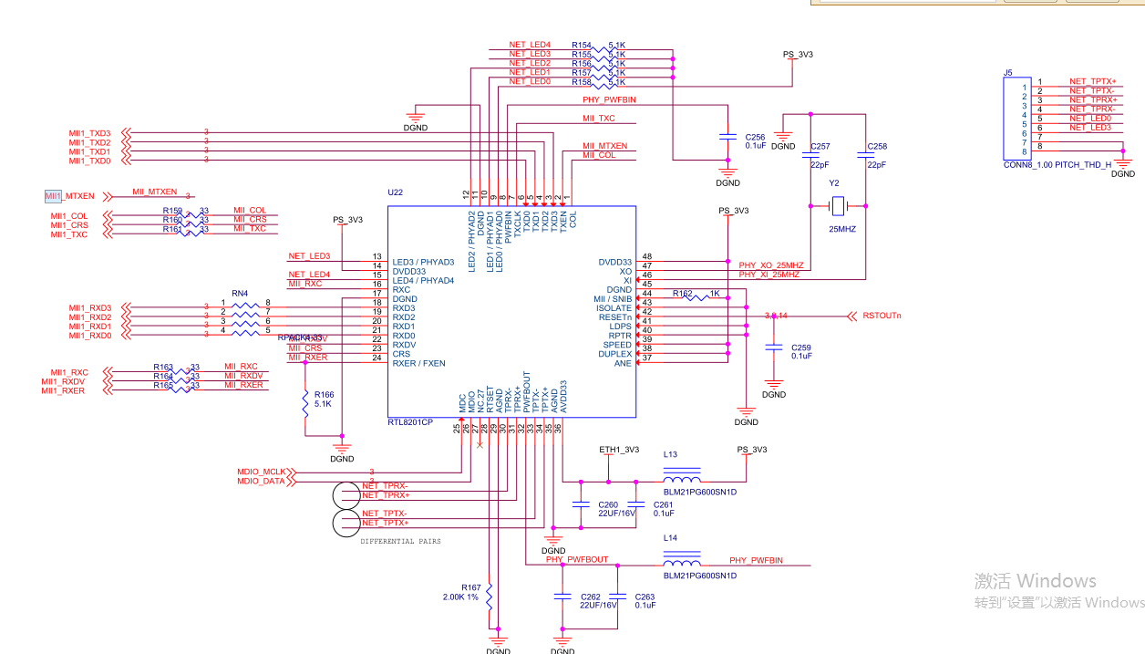

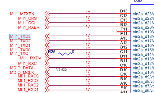

Just now we develop a custom am5708 board.
But There is some issues about the CPSW, It can not work.
Our network diagram is like below:
AM5708 chip CPSW(emac0) ----> Nothing.
AM5708 chip CPSW(emac1) ----> RTL8201CP.
We use MII mode between the CPSW(emac1) and the RTL8201CP chip.
Now the MDIO bus can read the RTL8201 chip and can get the Link info such as:
cpsw 48484000.ethernet eth1: Link is Up - 100Mbps/Full - flow control rx/tx
However we can not get the ip address from the router when using the udhcpc tool.
We also used the Oscilloscope to measure the mii1_txen, mii1_txd[3:0] singal, while test no signal.
So Anyone can help us.

  • Please complete this checklist and post the results here: processors.wiki.ti.com/.../5x_CPSW
  • Hi Biser
    Thanks for your reply
    We have read the doc and it can not solve my problem.
    We use Processor 4.3 sdk and the linux kernel is like below:
    Linux am57xx-evm 4.9.69-g9ce43c71ae #25 SMP PREEMPT Mon Nov 5 01:37:28 PST 2018 armv7l GNU/Linux
    Our filesystem is the same as tisdk-rootfs-image-am57xx-evm.tar.xz.
    Our AM5708 board is a custom board, the devicetree is like below:
    &davinci_mdio {
    phy1: ethernet-phy@1 {
    reg = <1>;
    phy0: ethernet-phy@3 {
    reg = <3>;
    &mac {
    status = "okay";
    dual_emac;
    &cpsw_emac0 {
    phy-handle = <&phy0>;
    phy-mode = "mii";
    dual_emac_res_vlan = <1>;
    &cpsw_emac1 {
    phy-handle = <&phy1>;
    phy-mode = "mii";
    dual_emac_res_vlan = <2>;
    The attachment is the kernel logs.

    Could you please attached the following?
    - The boot log, I would like to see the interface as it is initialized during the boot process.
    - A snippett of the PHY and MAC interface connections
    - The snippet of how the pin mux is being done in U-Boot
    Schuyler

    2 The snippett of the PHY and MAC interface connections is like below:

  • xixi,
    Schuyler is enjoying the Thanksgiving Holiday in the US and will not be able to reply until early next week. Sorry for any inconvenience.
    - Please post scope plots of both TXC and RXC. These should be taken as close to AM5708 as possible and while attached to a 100Mb link partner. 20/ns per division would be fine.
    - Please post total trace length for all MII signals.
    - Please test the interface with a 10Mb link-partner and provide the ethtool -s results for same.
    It has been a few days and we have not heard back so we are assuming the issue is resolved and will close the thread for now.
    Schuyler
