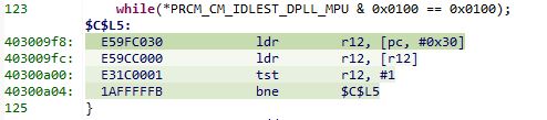

I confirmed that different asm files are output with the following two codes,.
(1) while(*PRCM_CM_IDLEST_DPLL_MPU & 0x0100 == 0x0100);
(2) while((*PRCM_CM_IDLEST_DPLL_MPU & 0x0100) == 0x0100);
In case of the asm code of (1), the code will check 0x001 instead of 0x100, so the program will not work properly.
  • Why is there a difference in the output code?
  • Is this a compiler bug?
  • Do I always need to write code in the way of (2)?
