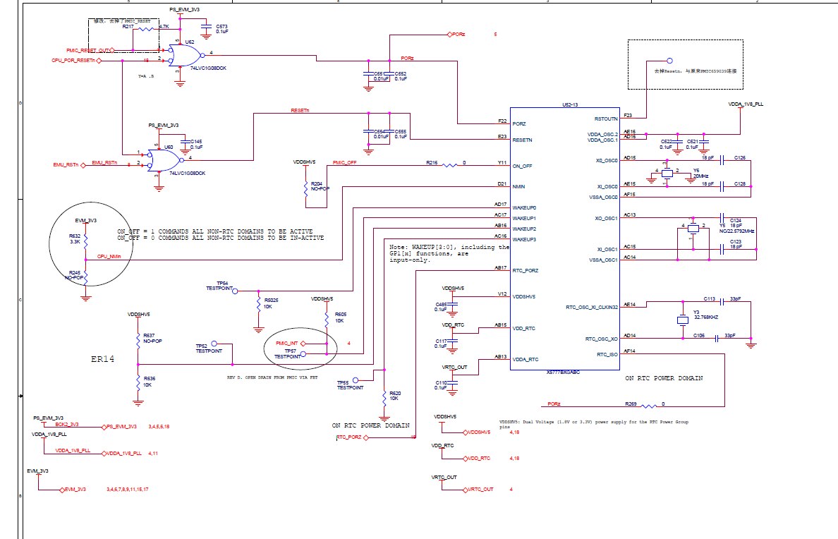

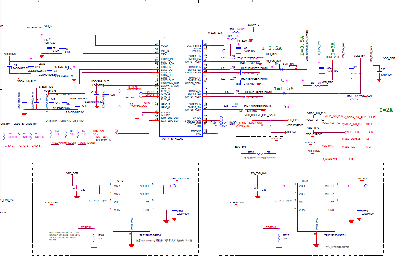

  I meet a problem ,  When I used PMIC (TPS659039Q1)  PO9039A387IZWSRQ1+ TDA2SXBTQABCRQ1 (BGA760) design ,  the
pin of TDA2X AE14,AD14 ( EXTERNAL 32.768 oscillator) is woriking , it has the RTC clock.   The rtc clock can be detected when powered up even without firmware in TF CARD.

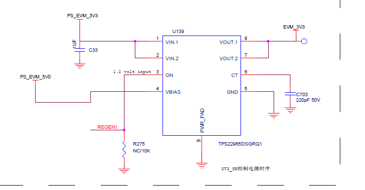

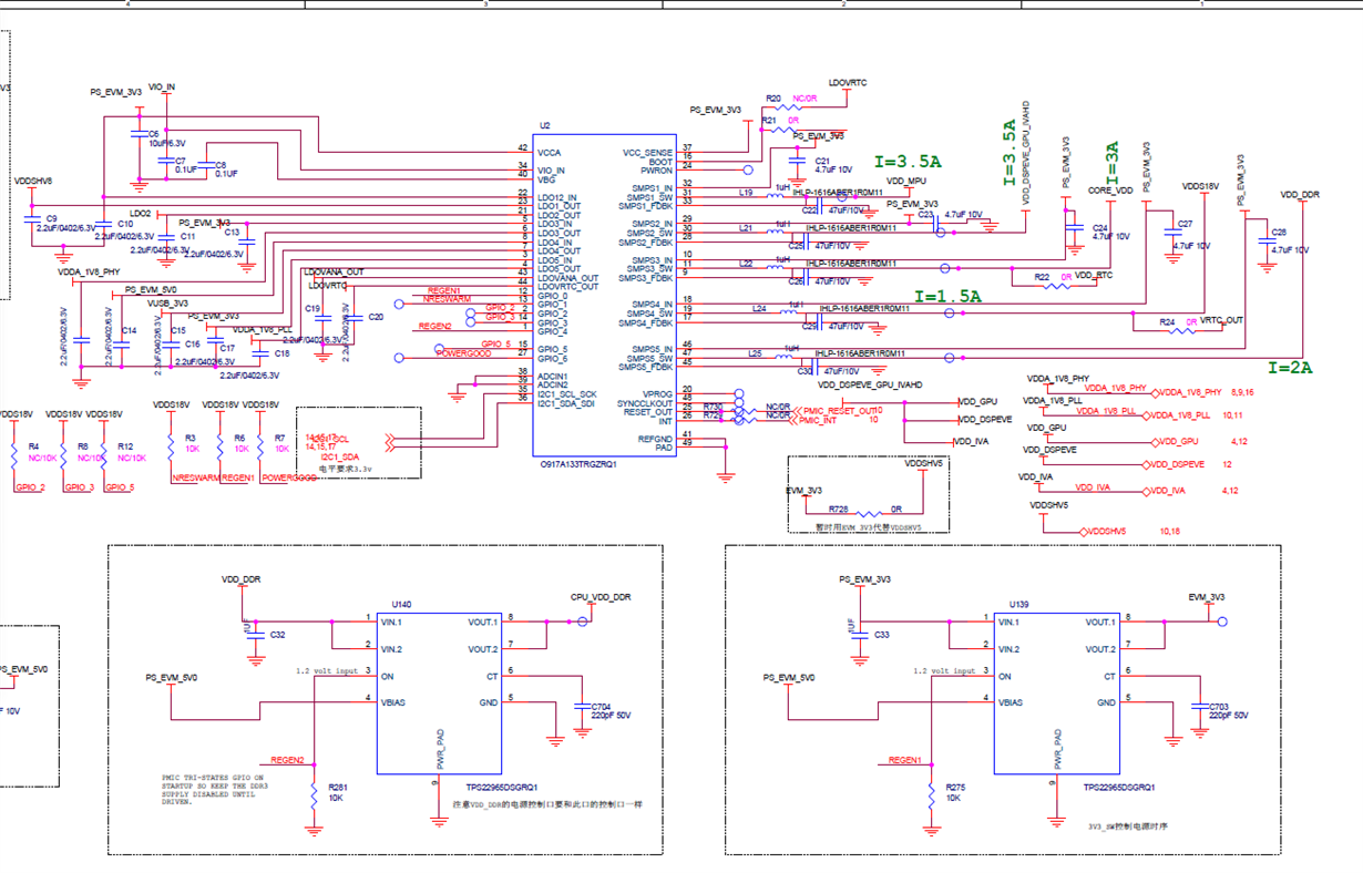

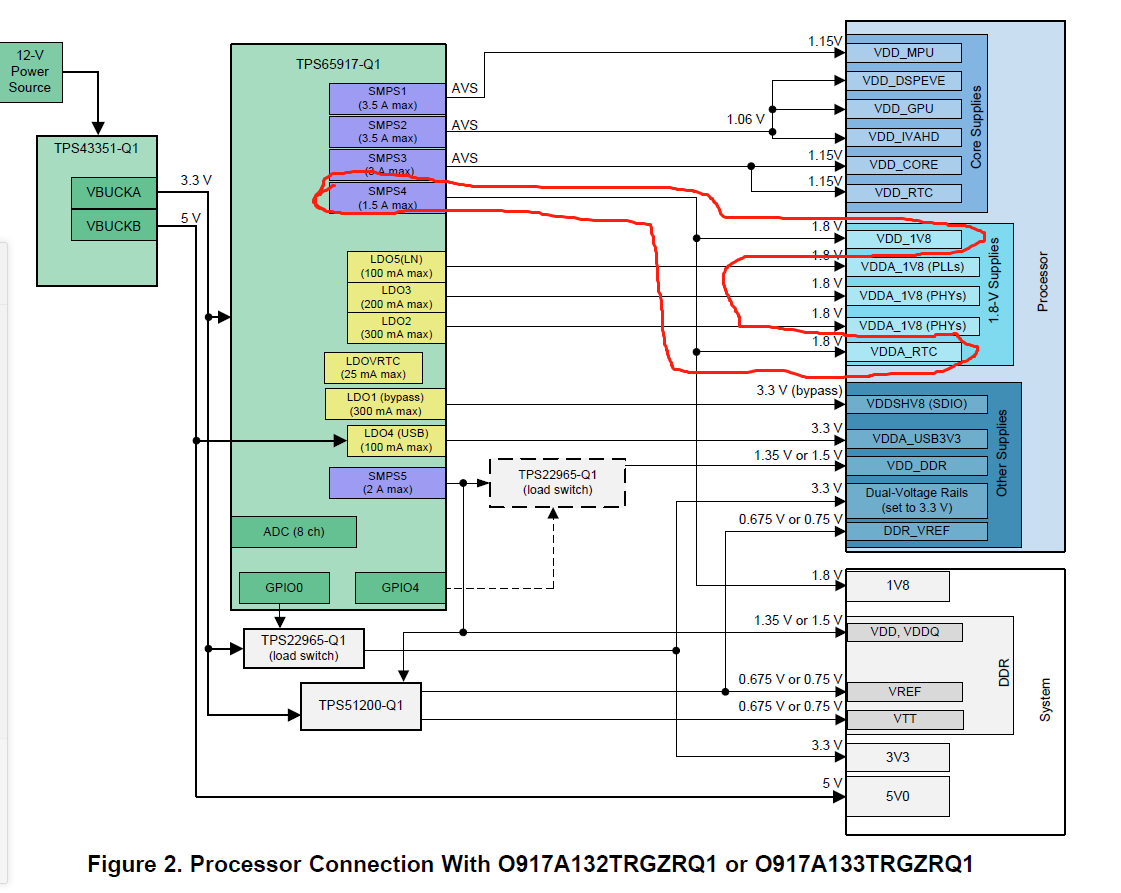

But ,the next HW version  we use  PMIC(TPS65917) O917A133TRGZRQ1 instead of tps659039.  These RTC CLOCK pins doesn't work , there is no 32.768 clock.
 please suggest what's the possible problem?
By the way, I found the RTC_OSC_REG   is related the settign , but  I am not sure that the tp659039 can set the enable Initialization , but the tps65917 can't set Initialization.??
