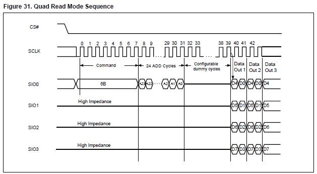

When AM4372 performs QSPI boot, how many bytes is the dummy data?

Hi Biser-san,
Thank you for your reply.
But I can't undaerstand it.
TMDXIDK437X's QSPI FLASH(MX66L51235) has the following waveform when looking at the MX66L51235's data sheet.
The dummy read of this waveform is written as 8 bits by default.
I think that the AM437x will read the QSPI after this dummy cycles.
I want to know the number of dummy cycles.
