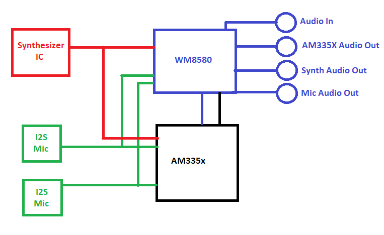

I have been fighting with this for awhile now, i know it am probably just forgetting something simple but can't seem to put my finger on it.  I thought maybe it was related to one of my prior posts (https://e2e.ti.com/support/processors/f/791/t/313430), but messing with the num-evt properties doesn't seem to help : /.
Anyways, my setup is i am using McASP0 and the AM335x is a slave and the master is only capable of I2S.  I have 1 output serializer (2 channels) and 3 input serializers (6 channels).  The 1 output channel works great, i can play audio via my codec no problem.  The issue is with the capture channels.  When i record from the any of the capture channels everything is all messed up.  For example Serializer 1 it seems to be putting both left and right channels together on channel 0 and for serializer 2 one of the channels is on channel 3 and the other is on channel 5?  That is why i thought it might be a similar issue to my other post because it seems like everything is all out of order : /.

    Could you please directly open the PCM (not via ALSA plugins) and check the recorded audio if it is matching? Also, I was looking at the datasheet for wm8580 and it does not support 6 channel capture (1 Stereo ADC).
    Krunal

    Thank you very much for the reply!  Sorry for the delay i was caught up into some other things.  Anyways the information you gave me has pointed me in the correct direction I think.  I didn't realize the channels were organized in the slots in that way, which is why i though everything was all mixed up!  I recorded from the raw PCM and opened the file and everything was on the correct channel for the 6 channel configuration you presented above, i will just have to redo my asound.conf to map them correctly.
    The other problems i am having that prevented me from realizing the channels are simply ordered different was a manufacturing issue with the microphones and something with the WM8580 ADC settings.  I thought the slots were messed up causing the garbled audio with the 2 channels for the ADC of the WM8580 but turns out something must be wrong in the WM8580 setup because it is not putting the data on the I2S bus properly, I verified by tieing the I2S data line from the ADC directly to a DAC output data line and sure enough the same garbled up audio, so nothing with the McASP setup.  I haven't been able to figure out the problem quite yet with the WM8580 setup, but i will keep working at it.  As for the microphones they were accidentally washed during manufacture and it damaged them, they just needed replaced.  I have multiple devices on the I2S bus so my setup is rather weird, as you pointed out the WM8580 only has 1 stereo capture, i actually have a couple I2S Mics and a Synthesizer chip (generates I2S audio data from MIDI input) providing the other inputs.  Here is a very simplified block diagram of what I have going on:
    The Synthesizer chip and Microphones need no configuration and they are working properly now, the synthesizer chip has to be the master so my setup is rather strange, pretending the WM8580 has 3 stereo captures so i can expose as 6 channels.
    Anyway i think you have given me the information to point me in the right direction.  I will keep working at the WM8580 ADC setup issue and post back my final asound.conf changes once i get everything working fully!  Thanks Peter!
    Jarrod
