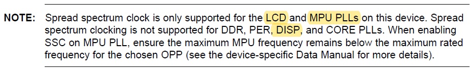

What is the LCD in the Note? is it not the DISP(display)? I did not find LCD PLL in AM335x TRM.
And only find void set_mpu_spreadspectrum(int permille) in clock_am33xx.c in UBOOT is there another one for LCD?

  • Tony,
    LCD PLL and DISP (Display) PLL is the same. And AM335x device support SSC on MPU PLL and DISP PLL:
    Additional timing margins are required when enabling Spread Spectrum Clocking (SSC). This prevents SSC from being enabled on any of the PLLs that source clocks to peripheral interfaces. We have determined SSC can be enabled on the MPU and Display PLL's since they only source clocks to dedicated circuits and interfaces that do not require low jitter clocks. The other PLLs will effect peripheral timing, so SSC should not be enabled on any PLLs other than MPU and Display.
    See also below e2e threads:
    e2e.ti.com/.../454523
    e2e.ti.com/.../198104
    I think the AM335x TRM needs an update for this NOTE. I will submit TRM update request. I will propose the below update:
    NOTE: Spread spectrum clock is only supported for the DISP/LCD and MPU PLLs on this device. Spread spectrum clocking is not supported for DDR, PER, and CORE PLLs. When enabling SSC on MPU PLL, ensure the maximum MPU frequency remains below the maximum rated frequency for the chosen OPP (see the device-specific Data Manual for more details).

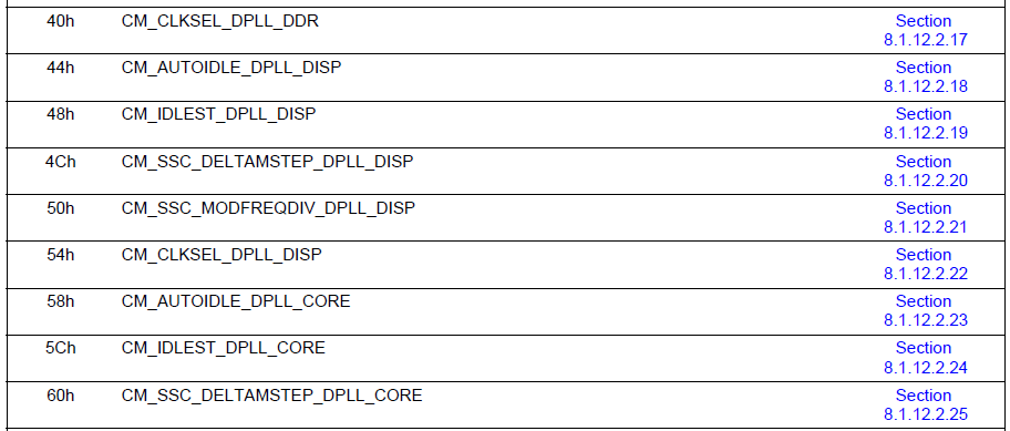

  • Pavel,
    #1. Is u-boot-2018.01/board/siemens/rut/board.c verified by TI? Or is it implemented by Simens and support by TI?
    #2. How to use it? replace the board.c under arch/arm/mach-omap2/am33xx?  or just add the this file to makefile to build for own board?
    #3. in TRM, the reserved register address is defined with name, why name it reserved in the UBOOT code?
    I would recommend to update u-boot/arch/arm/mach-omap2/am33xx/clock_am33xx.c and u-boot/board/ti/am335x/board.c files with DPLL_DISP setup, you can use RUT board.c as reference and also below file:
    I am not aware of the reason. I can state that we have these registers fully defined in linux kernel:
    linux-kernel/arch/arm/mach-omap2/cm33xx.h
    #define AM33XX_CM_AUTOIDLE_DPLL_DISP_OFFSET                      0x0044
    #define AM33XX_CM_AUTOIDLE_DPLL_DISP                                        AM33XX_CM_REGADDR(AM33XX_CM_WKUP_MOD, 0x0044)
    #define AM33XX_CM_IDLEST_DPLL_DISP_OFFSET                             0x0048
    #define AM33XX_CM_IDLEST_DPLL_DISP                                              AM33XX_CM_REGADDR(AM33XX_CM_WKUP_MOD, 0x0048)
    #define AM33XX_CM_SSC_DELTAMSTEP_DPLL_DISP_OFFSET      0x004c
    #define AM33XX_CM_SSC_DELTAMSTEP_DPLL_DISP                       AM33XX_CM_REGADDR(AM33XX_CM_WKUP_MOD, 0x004c)
    #define AM33XX_CM_SSC_MODFREQDIV_DPLL_DISP_OFFSET    0x0050
    #define AM33XX_CM_SSC_MODFREQDIV_DPLL_DISP                     AM33XX_CM_REGADDR(AM33XX_CM_WKUP_MOD, 0x0050)
    #define AM33XX_CM_CLKSEL_DPLL_DISP_OFFSET                         0x0054
    #define AM33XX_CM_CLKSEL_DPLL_DISP                                          AM33XX_CM_REGADDR(AM33XX_CM_WKUP_MOD, 0x0054)
