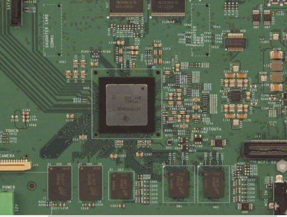

In the TI DRA777P evm (J6PEVM577P), there are 4mounting holes that can be seen in the snapshot attached. Is it for any heatsink part readily available in the market?
The four holes indicated are for SoC socket mounting. The only heat sink and fan for the EVM is an adhesive mounted version. Part numbers for the heat sink and fan used on the EVM are below:
CTS Corporation – Heatsink, Aluminum, 1”X1”X.35’, With Adhesive - P/N, BDN10-3CB/A01
Copal Electronics – Fan, 12VDC,25X10mm, .36W, 1.41CFM – P/N, F251R-12LLC
