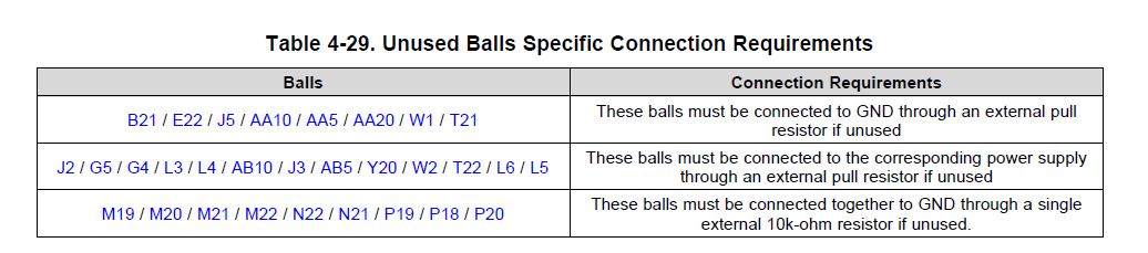

hello
What if I do not process the unused balls as shown below?
Can not Boot the Device?
Regards.
