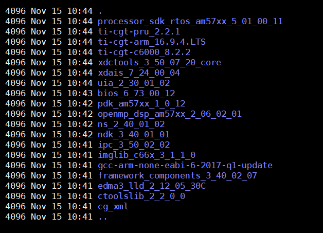

  • Hi
    Thank you for your reply. I restarted and installed Ubuntu 16.04.5 on a physical machine.
    Problem persists or at least looks worrying. Message is:
    Warning
    Problem running post-install step. Installation may not complete correctly.
    Error running /home/builder/ti/cgt6x_x86_installer --prefix /home/builder/ti --mode unattended:
    Child process exited abnormally.
    Any further recommendations?
    /Peter
    I have a Ubuntu 14.04 machine and tried installing   ti-processor-sdk-rtos-am57xx-evm-05.01.00.11-Linux-x86-Install.bin and I didn't have any issue.
    The warning you saw came from installation of TI C6x CGT. After installation, it should have a folder called  ti-cgt-c6000_8.2.2. Can you use command "du -ah ti-cgt-c6000_8.2.2" to check the files to see if anything missing? I attached a log of my output.

    Regards, Eric

    builder@Cewe-PeterLinux:~/ti$ ls -l
    total 83024
    drwxrwxr-x  7 builder builder     4096 nov 14 15:13 bios_6_73_00_12
    -rwxr-xr-x  1 builder builder 42954233 okt  6 05:47 cgt6x_x86_installer
    -rwxr-xr-x  1 builder builder 24104545 okt  6 05:47 cgt_arm_installer
    -rwxr-xr-x  1 builder builder 17890986 okt  6 05:47 cgt_pru_installer
    drwxrwxr-x  7 builder builder     4096 nov 14 15:11 cg_xml
    drwxrwxr-x  4 builder builder     4096 nov 14 15:11 ctoolslib_2_2_0_0
    drwxrwxr-x  9 builder builder     4096 nov 14 15:11 edma3_lld_2_12_05_30C
    drwxrwxr-x  9 builder builder     4096 nov 14 15:12 framework_components_3_40_02_07
    drwxrwxr-x  6 builder builder     4096 nov 14 15:12 gcc-arm-none-eabi-6-2017-q1-update
    drwxrwxr-x  9 builder builder     4096 nov 14 15:12 imglib_c66x_3_1_1_0
    drwxrwxr-x  9 builder builder     4096 nov 14 15:12 ipc_3_50_02_02
    drwxrwxr-x  5 builder builder     4096 nov 14 15:12 ndk_3_40_01_01
    drwxrwxr-x  4 builder builder     4096 nov 14 15:12 ns_2_40_01_02
    drwxrwxr-x  5 builder builder     4096 nov 14 15:12 openmp_dsp_am57xx_2_06_02_01
    drwxrwxr-x  4 builder builder     4096 nov 14 15:12 pdk_am57xx_1_0_12
    drwxrwxr-x  6 builder builder     4096 nov 14 15:28 processor_sdk_rtos_am57xx_5_01_00_11
    drwxrwxr-x  7 builder builder     4096 nov 14 15:14 uia_2_30_01_02
    drwxrwxr-x  9 builder builder     4096 nov 14 15:14 xdais_7_24_00_04
    drwxrwxr-x 10 builder builder     4096 nov 14 15:14 xdctools_3_50_07_20_core

    Here is my trial for a new download today:
    Windows PC:
    Ubuntu PC:
    This is my installation, I don't have any issue:
    Regards, Eric
