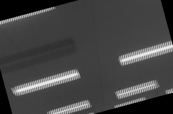

Why the odd lines are copied to the even lines? (deinterlaced??)
Have you ever seen this problem or similar?
Does anyone know the solution or comment for the problem we're seeing?
We modified the encodedecode DEMO in DM6446 EVM to do some video processing by replacing enc & dec part.
And it seems working fine at a glance except that the odd lines are copies to the even lines as shown below.
line0
line0
line2
line2
line4
line4
Checked the frame buffer, it stores all lines correctly (line0, line1, line2, line3, ...). But the output image on the NTSC display is strange.
So, I modifed "varInfo.vmode = FB_VMODE_INTERLACED;" to "FB_VMODE_NONINTERLACED;" in the display initialization routine
for a try because something seems happened in the VPBE processing. But it didn't make any change to the behavior.

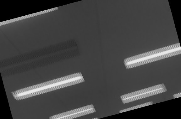

  • Bernie, Juan,
    Sorry for kept you waiting...
    I finally prepared a Picasa web albums account and uploaded the images.
    This is the original image stored in frame buffer.
    frame buffer
    And this is the output screen image (created a similar image as what we're seeing).
    output image
    Can you imaging the problem now?

  • Just to make sure we are focusing in the right area, this appears to be a problem with the VPBE (display side, as opposed to capture side), correct?  Since there are mentions of VPFE in previous postings, I just want to make sure we are focusing on the right problem area.
    If so, are you using analog or digital video output?  Also, how did you verify the video data in DDR2 is correct? could you write this data to a file instead and use another program to display the video frame correctly?
    I am just thinking aloud here, but if you can confirm the first question above, we can at least focus on the correct portion of the system.
  • I am assuming that the image here is exactly what is in your memory, including the black edge portions, it sort of looks like you took a picture of a greyscale display at an odd angle, but looking at the edges of that makes me belive that this is in fact the entire display buffer. Looking at the images this reminds me of field swapping, i.e. if field 0 was displayed as field 1 and vice versa, which can make lines at an angle look jagged. However looking closely at the edge from grey to black it does look more like line doubling than field swapping. This looks almost like the field mode described in section 4.3.2.4.2 of SPRUE37, though your buffer pointer would be setup to skip the odd lines in the buffer, otherwise you would only be seeing the top half of the display. This certainly seems like something you would need to tweak in the display driver, are you using the default display driver included with DM6446 or have you made your own modifications?
